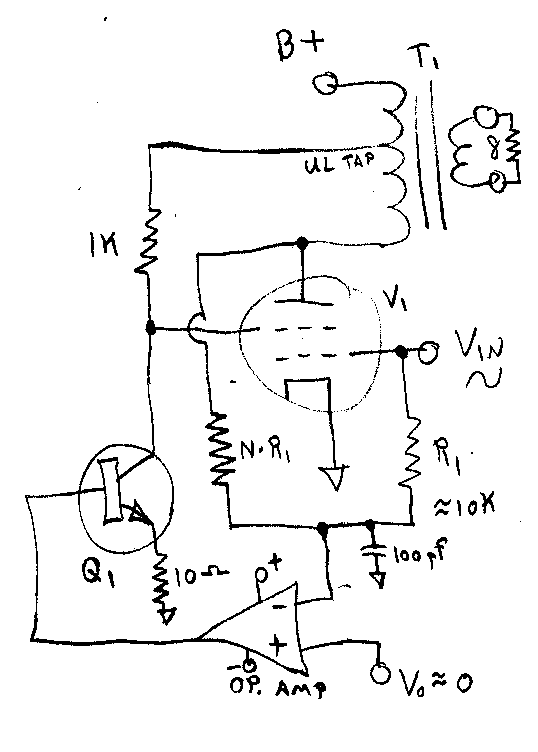

Try something like this to make ultralinear really linear and see what the screen really needs on it. Then can decide if a UL tap signal comes close or if any passive fix ups can help.

Has anyone actually build the suggested zener mod and can share his listening experience ? A lot of discussions, but I am curious if anyone tried it ?
When going with my El34-PP-UL amp to triode (g3 to cathode, g2 to anode, no resistor), The amp feels soft and not very transparent/holografic anymore. Why is this ? Cant believe this is just the loss inpower....
How about posting a schematic and parts values of your amp that does not sound as good in triode mode, as it sounds in Ultra Linear mode.
