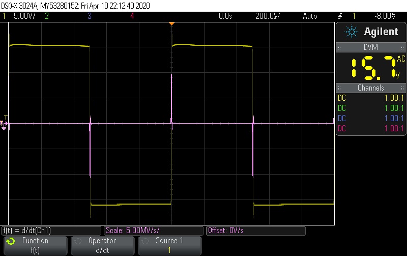

I'm glad someone actually challenged me on this. I did measure system speed from the modified Urei LA-4's input to output terminals and that includes the new Jensen input and output transformers. I should have taken "before" measurements, but I didn't.
One image shows slew testing using an Agilent DSO-X-3024 digital storage scope with ARB generator. The scope has a built-in slew rate computation feature. The scope reports slew in MV/s (violet vertical spikes) which then must be converted to V/us by moving decimal places. A 1 kHz square wave was used and set to the LA-4's maximum output level of about 30Vp-p with about 5 dB compression at a 4:1 ratio. I did swing the frequency up to 20 kHz and the scope tracks slew with no notable change in the presentation.
The final result is roughly 10V/us. The Jensen input transformer is the limiting factor. When bypassed it results in about 20V/us. That said: (1) 10V/us satisfies Walt Jung's speed criterial; and (2) it's better than the stock slew rate of about 0.5V/us when the 4136 op amp stages are cascaded.

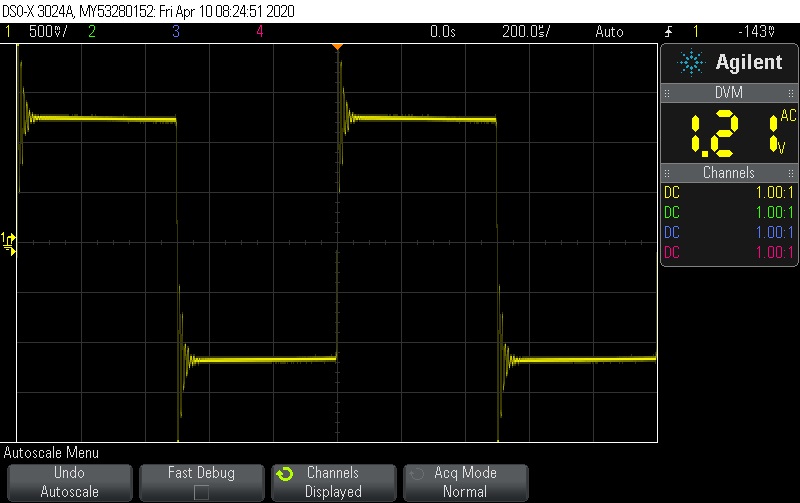

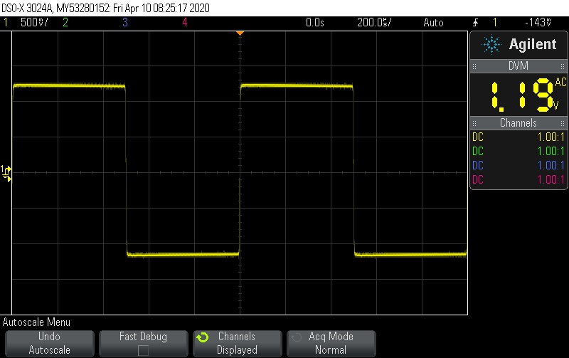

The other images show a 1 kHz square wave at normal line level with and without overshoot compensation components engaged on the secondary winding of the input transformer. This clearly shows why it's important to properly terminate a transformer if best dynamic performance is expected.
What's surprising is a dearth of information concerning transformers and their effect on system slew rate. It seems like each author that touches upon it is quick to exit, stage left.
Well-driven transformers do not slew. Passive devices generally can not slew-limit.
Amplifiers of poor current output driving high-C transformers can slew, of course.
