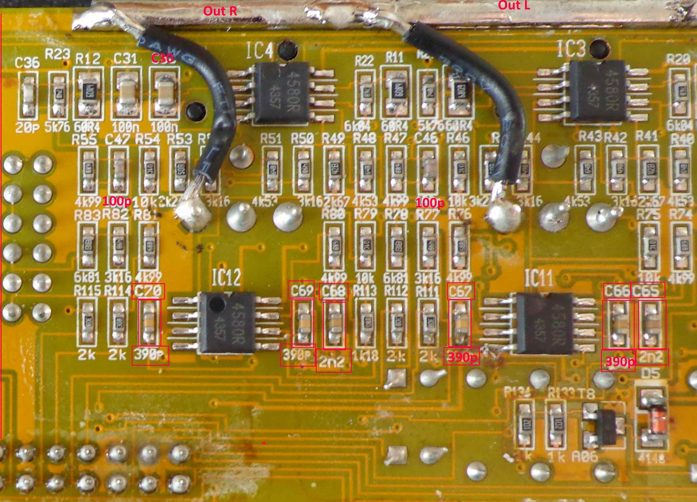

Okay, here are some high resolution photos that show the caps that PierOlo replaced.
On the bottom of the Analog(input/output) Board, there are four 390p caps - C70, C69, C67, and C66. There are also two 2n2 caps C68 and C65.

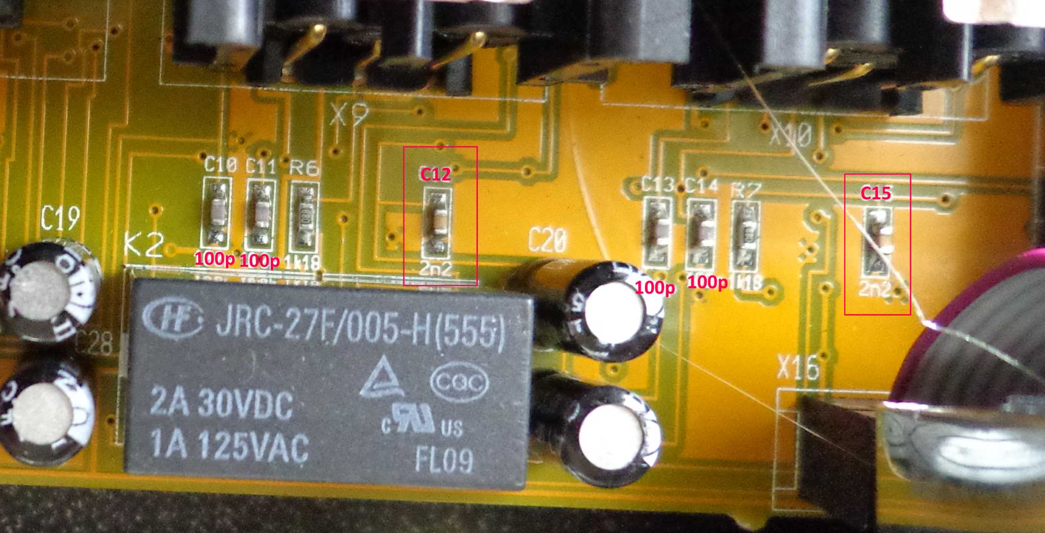

On the top of the Analog(input/output) Board, there are two more 2n2 caps C12 and C15.
In the photos, I have also tagged the 100p caps which could also be replaced if you are a sadist. ;-)
Don't confuse 100n with 100p, I highlighted some labels that we obscured but only for completeness, not because they need to be changed.

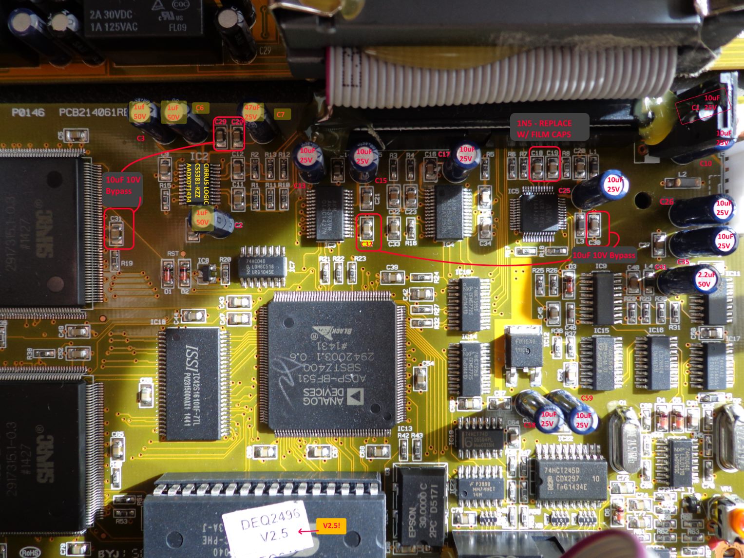

On the Digital board (with DACs) you will see that this is actually VERSION 2.5!!! So the caps listed on sites like awdiy.com are actually a little off! The changed the AK5393VS and now use a smaller CS5381-KZZ from Cirrus Logic. So they have three 1uF 50V radials now...anways...the caps that PierOlo swapped should still the same.
The picture of the digital board shows all the possible candidates to recap but for this thread, C18/C19 (1n5) and C30/C31/C32 (10uf 10V bypass caps added on top) are the caps of interest (but might as well add 10uf 10V bypass caps to C28 and C29 while you're at it!
Don't bypass C29 and C28! That was true for the v2 board, but on the v2.5 board (different ADC chip) C11 and C12 are the ones you want to bypass.
C29 and C28 are .01uF as they should be, but could also be replaced with film caps.

So the identity of the mystery cap on the analog board would be C65. One thing solved.
It would appear the two 220p caps I missed are still on the run, as I do not see them on the analog board photos. (which are, by the way, very useful. That's what I should have done back then- thanks Calderes!)

Thought I'd post a complete ceramic capacitor list for the complete analog /jack board including both top and bottom (where they are mostly located) Here they are for anyone interested in upgrading the DEQ's analog section with films or having them at a glance.
20p x 3 = C36, C39, C40
100p x 20 = C10, C11, C13, C14, C2, C3, C61, C32, C33, C62, C63, C34, C35, C64, C46, C56, C37, C48, C38, C4
330p x 2 = C57, C58
390p x 4 = C66, C67, C69, C70
2n2 x 4 = C12, C15, C65, C68
10n x 3 = C55, C49, C59
100n x 11 =C8, C9, C50, C51, C30, C31, C60, C44, C45, C52, C53

Would this be a reasonable replacement for the 47uF coupling caps ? Is there enough room on the PCB to fit 4 small "blob" tantalum caps?
The PCB pictures above indicating capacitor locations don't show these 4x 47uF caps, can anyone point out to me where they are located or their C numbers ?
My unit is a 1st generation model bought in 2004.
