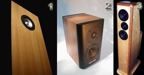

I ‘m building myself three zv4 amps. Next, I need a nice set of speakers to go along with it. I have narrowed down the candidates to 3 speakers. (1) The e.j.jordan jx92s full-rang driver in there standard transition line enclosure. (2)The North Creek Okara II Bookshelf Monitor and finally the Ariel. My room is small 9’ x 20’ and I will be placing it n the long wall, because that’s where they fit. Let me write down a little about each one of these for people who do not know of these speakers.

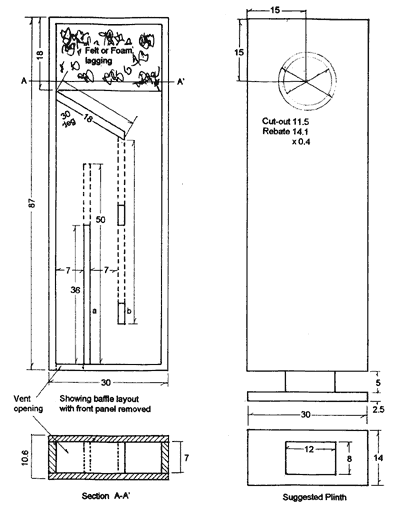

1.) The e.j.jordan jx92s full-rang driver in there standard transition line enclosure is by far the cheapest of the three. The drivers can be gotten in the U.S. for $100 each. It is also one of the easiest to build. The cabinet is 12” w and 4” deep, so if there is a problem with the wood working, as I know there will be, I can just fill in the side with fiberglass resin. The short comings of this speaker are that the driver is only a 5” driver. It has a sharp roll-off after 15 KHz. I have been told by many people that the bass on this driver is very good for its size because it is transition line. Konus Audio systems also make these speakers under the name “Essence” for the price of $3,500 per pair. At that price I would expect them to sound good. To spite this speaker’s low sensitivity of 88db Konus sells this speaker with there 50 watt amps. It is my 1st chosse at this point. If anybody wants a cabinet drawing I can post them.
2.) The North Creek Okara II Bookshelf Monitor uses the same drivers as the Ariel. Its cabinet is a little boxier then the e.j.jordan jx92s. This system has a nice full range response and its sensitivity is bout the same. My major complaint about this speaker is that North Creek has now decided to sell there cross-over in epoxy so I can’t build anymore of these without going throw North Creek nor can I try different caps and such. I’m not saying the quality of there crossover is bad; it’s realy very nicely made with all quality parts.
3.) I think most people reading this thread know about the Ariel. The cabinet work is a lot harder then the other two speakers. It cost a little more then the North Creek Okara. The main thing this speaker has going for it is it’s sensitivity of 92db. Mad_K post on the “ZenV4, SOZ, or Original Zen for Ariel?” thread has put me off of the idea off using the Ariel because the Aleph 3 and zv4 share nearly the same output stage. They have the same constant current Source, the same bias level (2 amps) and almost the same power output (25watt, 30watts). I still haven’t ruled out any of these possibilities. However the Ariel has drop down to the bottom of my list. This speaker was probably made for an amp that has almost no bass control. That’s probably why it sounds bad with some of this higher power ss stuff.
I would like some opinions from people who have herd any of these speakers. It would be nice if someone has herd two of the three speakers on this list so they can make comparisons between then. However, I would seriously doubt that anyone has ever gotten any of these speakers together because there all DIY speakers, so all opinions are welcome.
I have looked at pretty much everything the DIY community has to offer, with the exception of the long awaited claw by nelson pass, and these are the ones that seem to stand out in my head as keepers. :xeye:

The Jordan is one fine speaker. It gets even better if you XO it over to a tweeter (can be done right off the bat or after you have lived with them a while). This thread is on just such a beast.
And i'm with JasonL that a mini-monitor (as i'd classify the Jordan in the TL) with active subs is the way to go with any system.
dave
