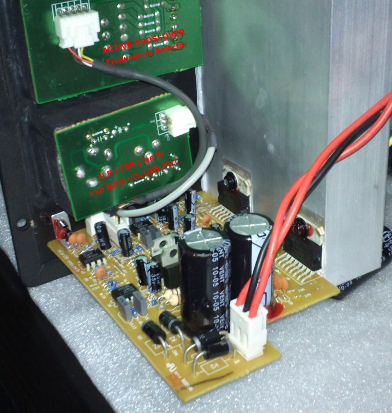

I received from a friend a pair of audio monitors “nEar 08 Classic”.
One is not working.
I opened it and noticed that the PCB was not in good shape.
It seems that "ESI" is not supporting this model any longer.
I found that this audio monitor circuitry uses an internal active crossover that divides the signal @2700Hz and then sends each channel ( Mid/Woofer + Tweeter ) to it’s own TDA7294 AMP that delivers 75W @ 4 Ohm for each speaker (the speakers are 4 Ohm each, well, in fact the Tweeter are 3.5 Ohm to be precisely exact).
See attached photos for clarification of the stated above.
I tested the one that is working and I noticed that this circuitry is a bit noise (high-hiss), at stand-by, so I decided to replace most of the circuit design by a new option.

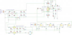

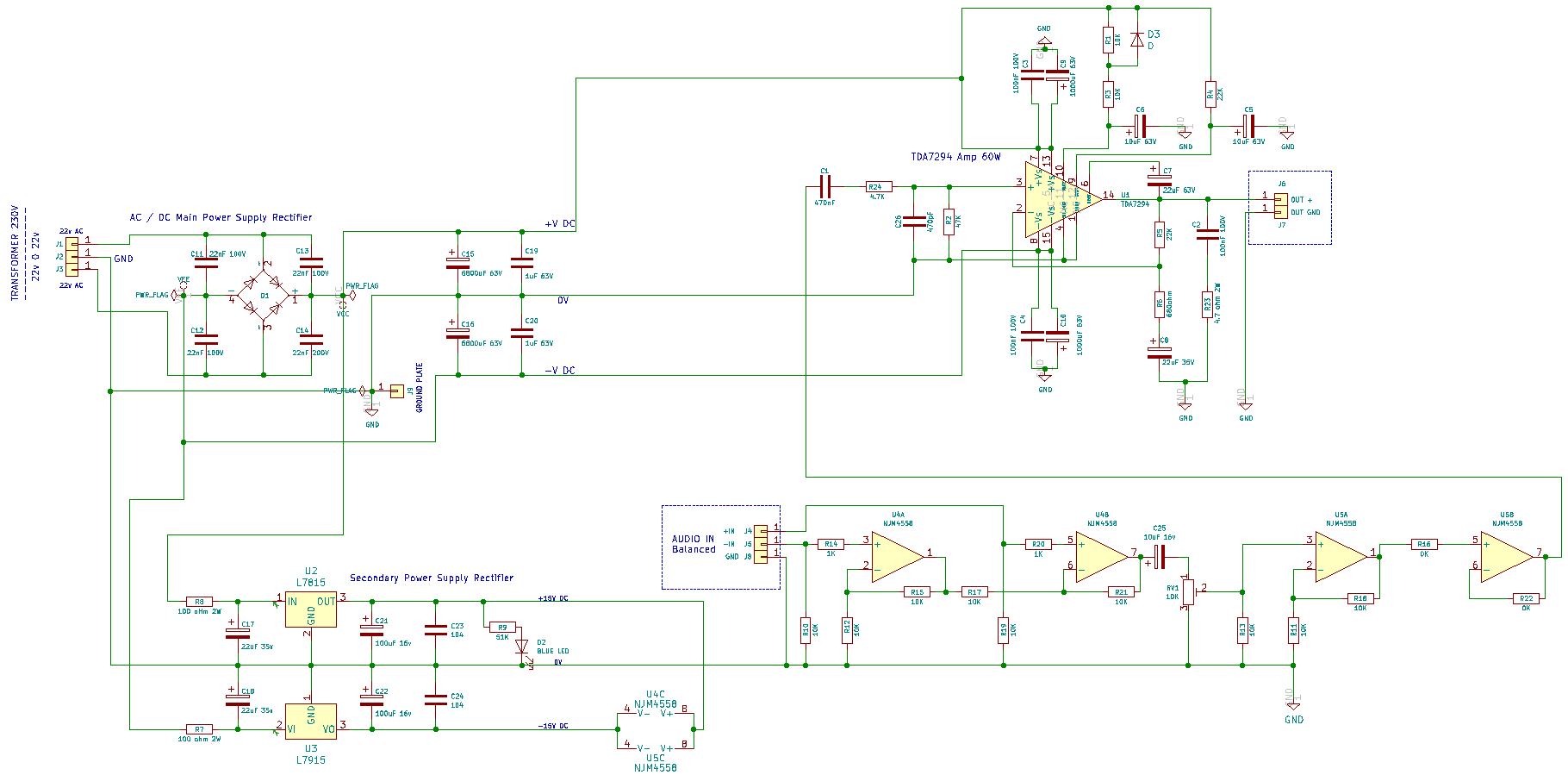

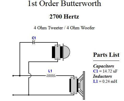

The main idea is to assemble a new circuit that receives the Line IN balanced audio signal, process it to standard (+/-) audio signal and then sends it to a single TDA7294 AMP that should deliver 60W @ 4 Ohm ( 20HZ to 20Khz ) from there the signal flows to a simple “1st Order Butterworth” passive crossover (see image) and then to the ( Mid/Woofer + Tweeter ).
I added my circuit schematic concept (in attach) for the ones that love to discover problems and faults in the circuit designs.

Why do you call 1st order filters 'Butterworth'?!
The complexity or filter type is defined by the filters “order” and is dependant upon the number of reactive components such as capacitors or inductors within its design.
This simple crossover is rated "a first-order filter" bcause it has a standard roll-off rate of 20dB/decade or 6dB/octave.

To get back ON TRACK.... Converting a bi-amplified system to a passive crossover will work, obviously, but trades-off several dB of headroom and may need a Power trimmer to balance the two drivers. Also a 1st-order crossover allows quite a lot of midrange into the tweeter, which may not be selected to handle heavy below-band signal.
To get back ON TRACK.... a 1st-order crossover allows quite a lot of midrange into the tweeter, which may not be selected to handle heavy below-band signal.
Humm, you have a point here.
I know that the active crossover splits @2700Hz, maybe I can minimize/ compensate this issue by lowering the split frequency to @3000Hz?
Well, I have to test the crossover after assemble the rest of the circuit.
I'm a bit worried about the circuit regarding the signal input (based on the 4558D) and the final stage of the TDA.
I would like to hear some opinions of people that already assembled an amp with the TDA7294.
It is the first time I'm dealing with this chip.
Despite I've used the STMicroelectronics circuit reference, (and some other projects I found on-line to assemble the amp circuit) I'm not so sure if this circuit is the best approach to this chip.
A little help with this circuit would be much appreciated.

I noticed that in the nEar 08, the volume potentiometer is placed in the same PCB of the signal IN (where the TSR / XLR jacks are connected from an external audio source).
I'm planning to change it to the circuit of the 4558D signal processing chain (before the TDA amp).
Its possible to check this on the circuit image I posted, labeled as RV1. 🙂
So, I'm following your advice and moving the volume potentiometer from its original location to the final signal processing stage, right before the AMP.
