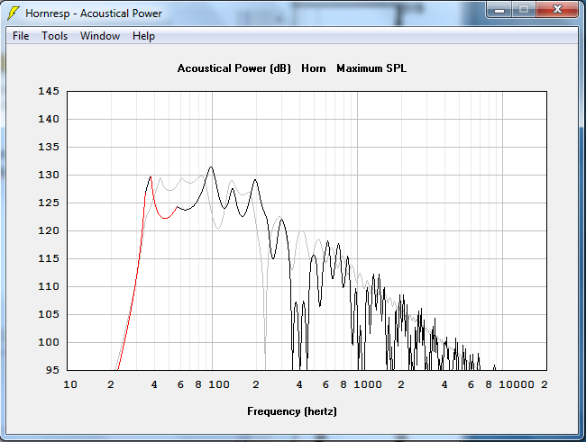

Hmm, did a quickie scoop and a basic TH of the same net Vb [~1233 L] and the scoop was the winner, but with only 6 mm Xmax = 150 W and a high Vas, not the right driver for the job.
Shaded = scoop

HOG is actually a kind of tapped horn too except it's horn expansion is exponential. Tapped horn because the driver is in horn path. But it has also exponential horn expansion like real horn subwoofers so yes it sould be a bit more sensitive. Dangerous subwoofer it is and when properly driven will make some damage inside! It just needs good driver, heavy amplifier and some DSP/EQ work to keep it going. Not quite simple compared to typical reflex subwoofers because of some anomalies.
Yeah, on second though I figured this as well. And it probably goes a bit lower because you put the woofer a bit further out in the path. So the exponential expansion gives it the different sound signature vs a tapped horn?

Exponential expansion should give better efficiency/directivity (especially in stack of 4 or more) at least but yes, its a big enclosure.
TH18/118 tapped horn is the one I would like to compare with Hog. It seems to have similar low extension down to 30-35Hz.
