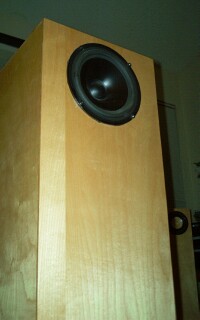

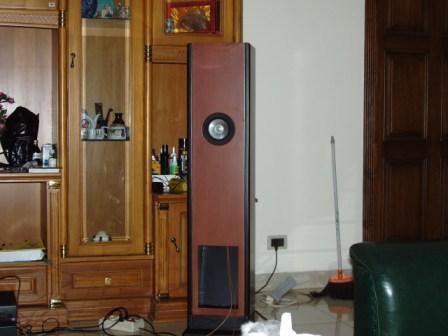

the short rectangular one,
i've taken pic of it, but the file is over 800kb, anyone know how to make them smaller?

thanks GM, here's the pic

Nice looking pipes!
I'm not familiar with car audio drivers, and the only Hi-Vi Research driver I have info and recommendations on is the M8N: http://www.partsexpress.com/pdf/297-446.pdf and lo n' behold, it appears to be ~ a JX150 clone except it doesn't need as big a box, though as long a pipe, so at least on paper it appears to be an ideal choice.

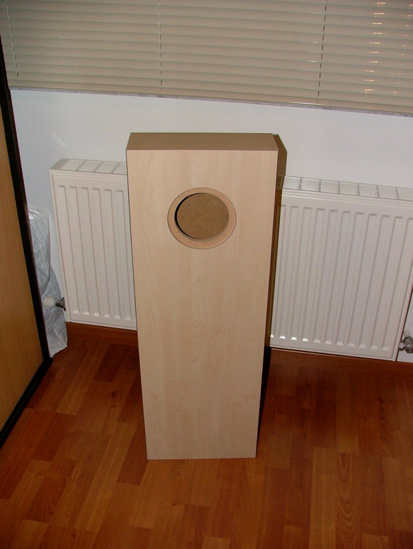

Where can I find GM's cabinet design (drawing)?
I'm almost done with the cabinets according to Ted Jordans specs.
MDF box with maple veneer.

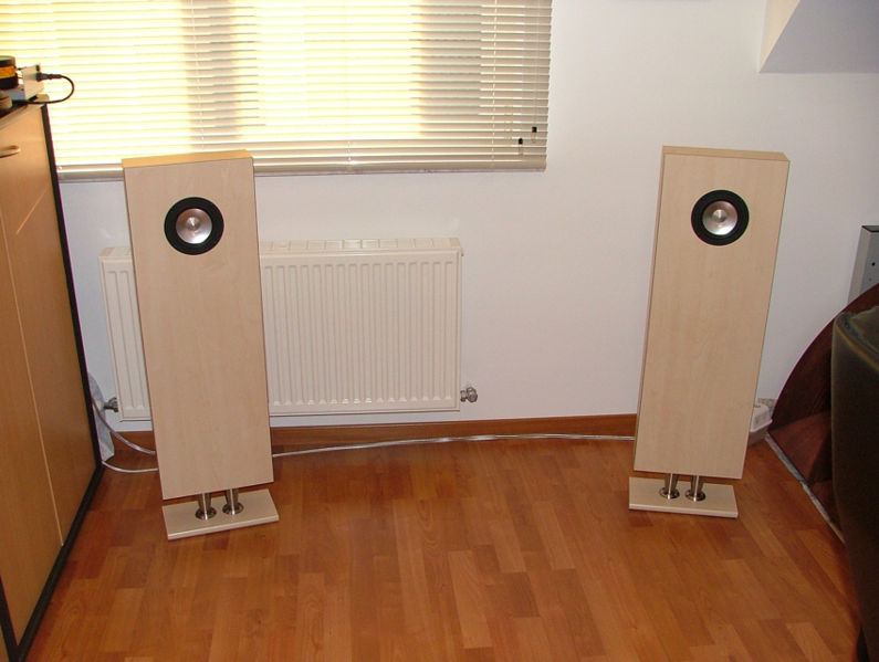

I finished my speakers yesterday. I'm quite happy with the way they look, also my girlfriend likes them very much (what more do you want....). Didn't do a lot of extensive listening yet, but what I can tell so far is that voices are quite lifelike. It's also of importance where you sit, to get the best overall picture of the sound.

The recommendation for Ted's layout is toe the speakers in 60 deg this is more severe than most speakers but works
Your photo layout will give a very broad soundstage ~ if you toe them in from 50- 60 you should find voices pinpoint better
& would be better for smaller rooms ~ Off axis listening is also improved Try experimenting with 2 - 2.4 m apart listening position 1m from crossing point
