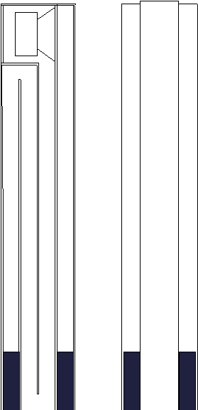

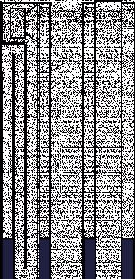

put it in a corner and make it a slim rectangle - ie 13" x 8" foot print and it can be tall to make up the required volume
Here is a classic single-fold straight transmission line design for the ApexJr 8" woofer -- tuned to 34 hz.
I used Rick Shultz' AlphaTL calcs (in the XLS that GM posted).
Driver: ApexJr 8" woofer (approx $50 shipped)
Qts: .51
Vas: .38 cu ft
Fs: 48 hz
Fb: 34 hz
Fibreglass stuffing: 1/2 lbs per cu ft
Transmission Line (two -- single fold) inner dimensions (each):
Width: 8"
Depth: 3.75"
Height: 41"
Enclosure outer dimensions:
Width: 9.5"
Height: 50"
Depth: 9.75"
Driver placement: top of the enclosure (no offset)
Terminus Placement: directly below driver (4" x 8")
Ideal enclosure placement: mid-wall (vs. corner)

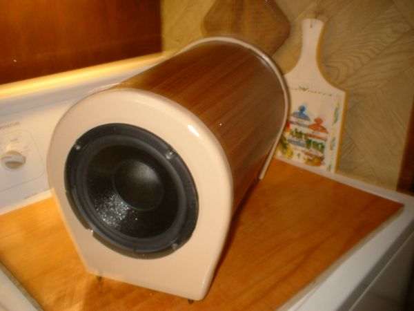

Did someone say "small DIY sub"?
I built this for use with some Optimus mini-speakers powered by a receiver providing audio for my computer. It uses a Dayton Classic 6 1/2" woofer and a Dayton 8" passive radiator and powered by a subwoofer plate amp. It's super easy to make and has alot more thump than you'd guess. Smaller than most any other 8" driver sub (easily hidden) and for the price (about $40, plus amp), hard to beat. For HT, you could even use 2 (8-ohm version available), get better coverage and still not break the bank. Here's some construction details.
http://nate-diggidy.smugmug.com/gallery/528207/1/22372112]Project Bitty-Boom[/URL]
How you finish for SAF is strictly up to you 😉

Here is another idea.
It has a small footprint (approx 8 1/2" x 11").
It is 56" high.
It is tuined to 24 Hz -- 1/2 the driver's Fs.
The attached pic shows the interior / exterior.
The long line (~141") is comprised of three folded lines (8" x 2.3" x 47" interior).
The short line is 8" x 2.3" x 47" interior.
It is small because the cross sectional area of each line is 1/2 the SD of the driver.
It is 56" high.
Bitty-Boom link
Here's the proper link for the photo gallery of the small sub I posted above.
I dare ya' to come up with an easier to build sub 😉 . This thing is so easy, the passive radiator dosen't even need any additional weight to tune it. Parts Express sells vinyl laminate to cover the "tube" part in different finishes and you just paint the end caps to match.
Just place it against a wall and let the laws of physics take over where the drivers leave off 😎 .
