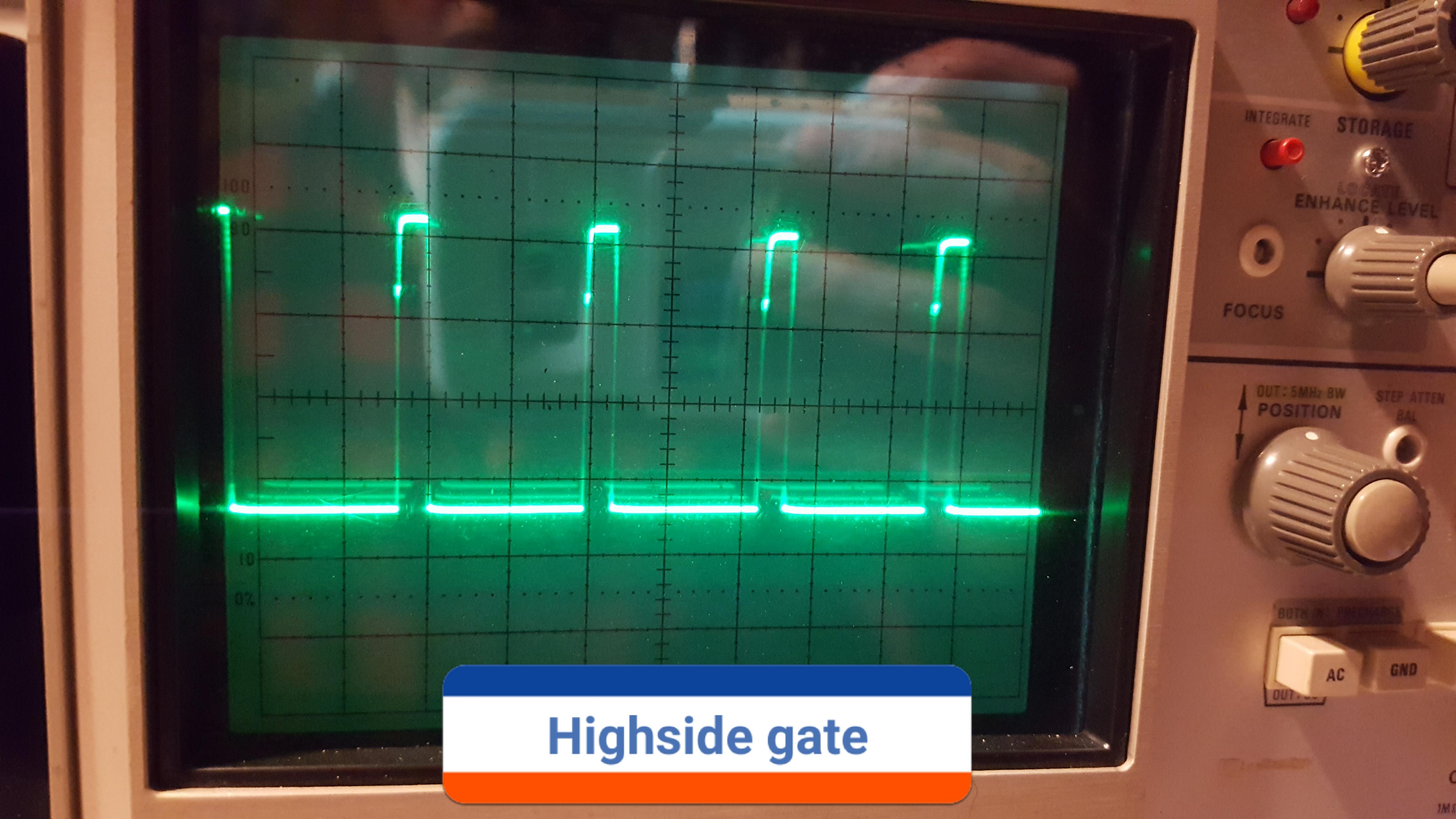

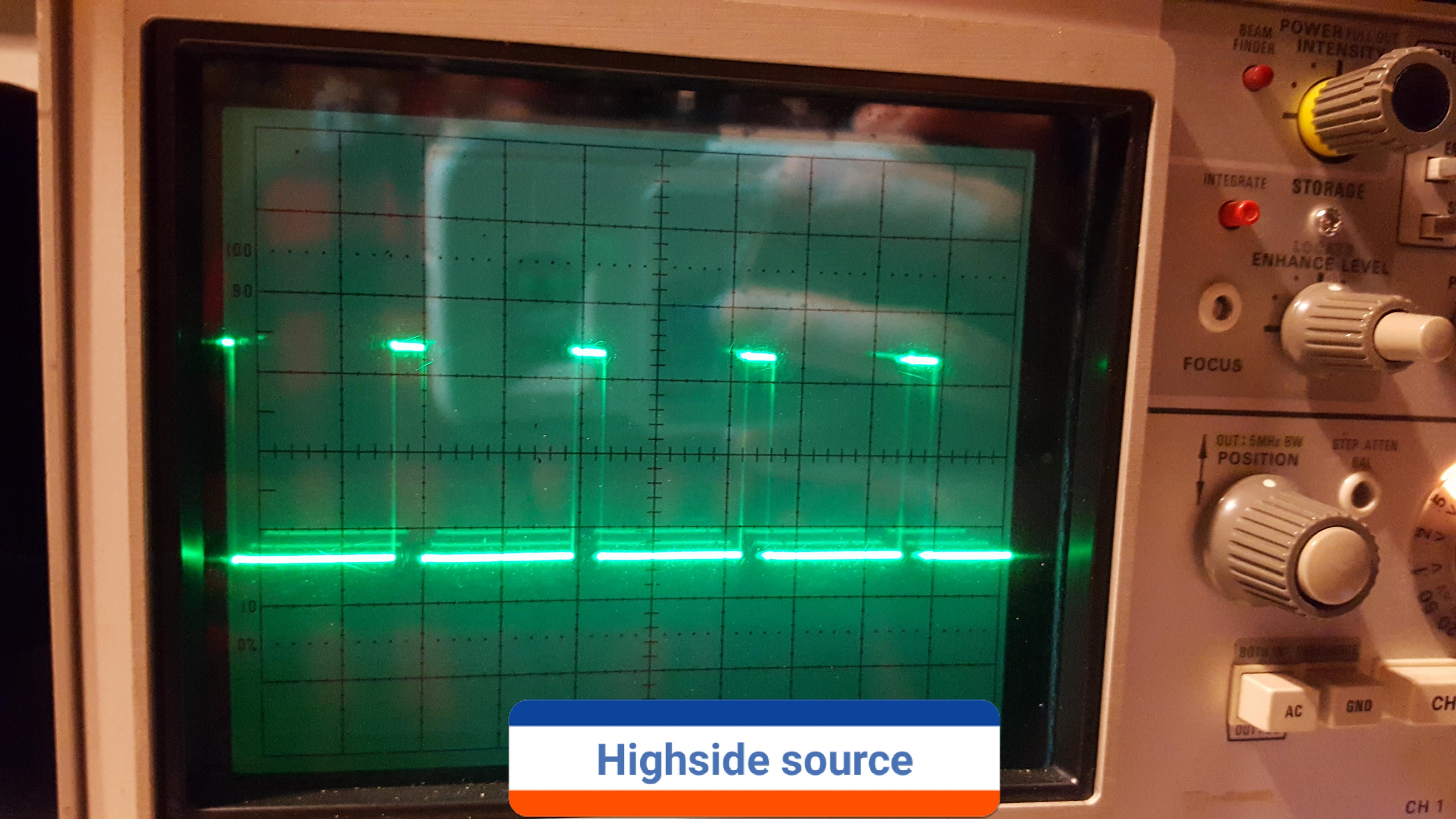

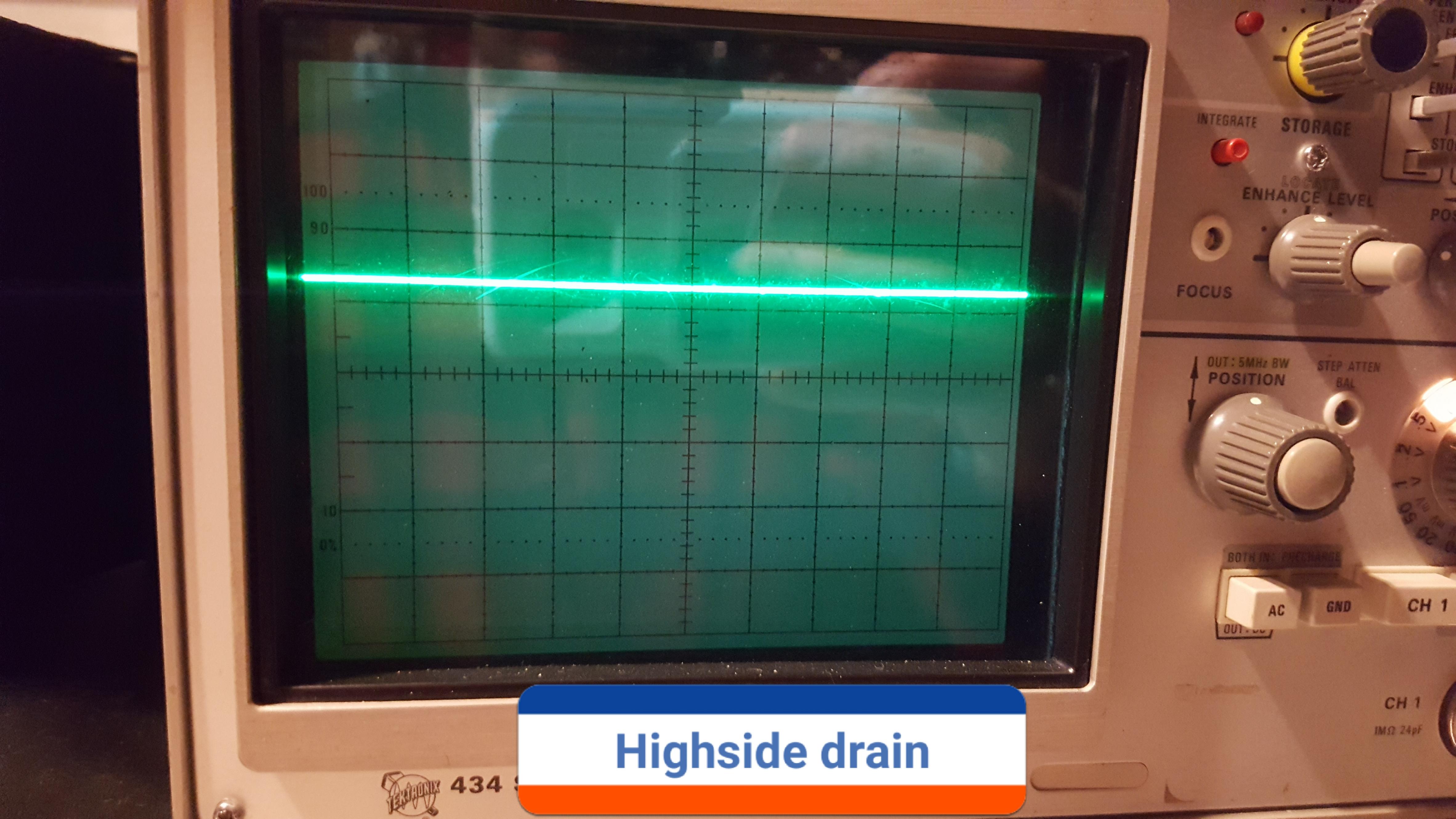

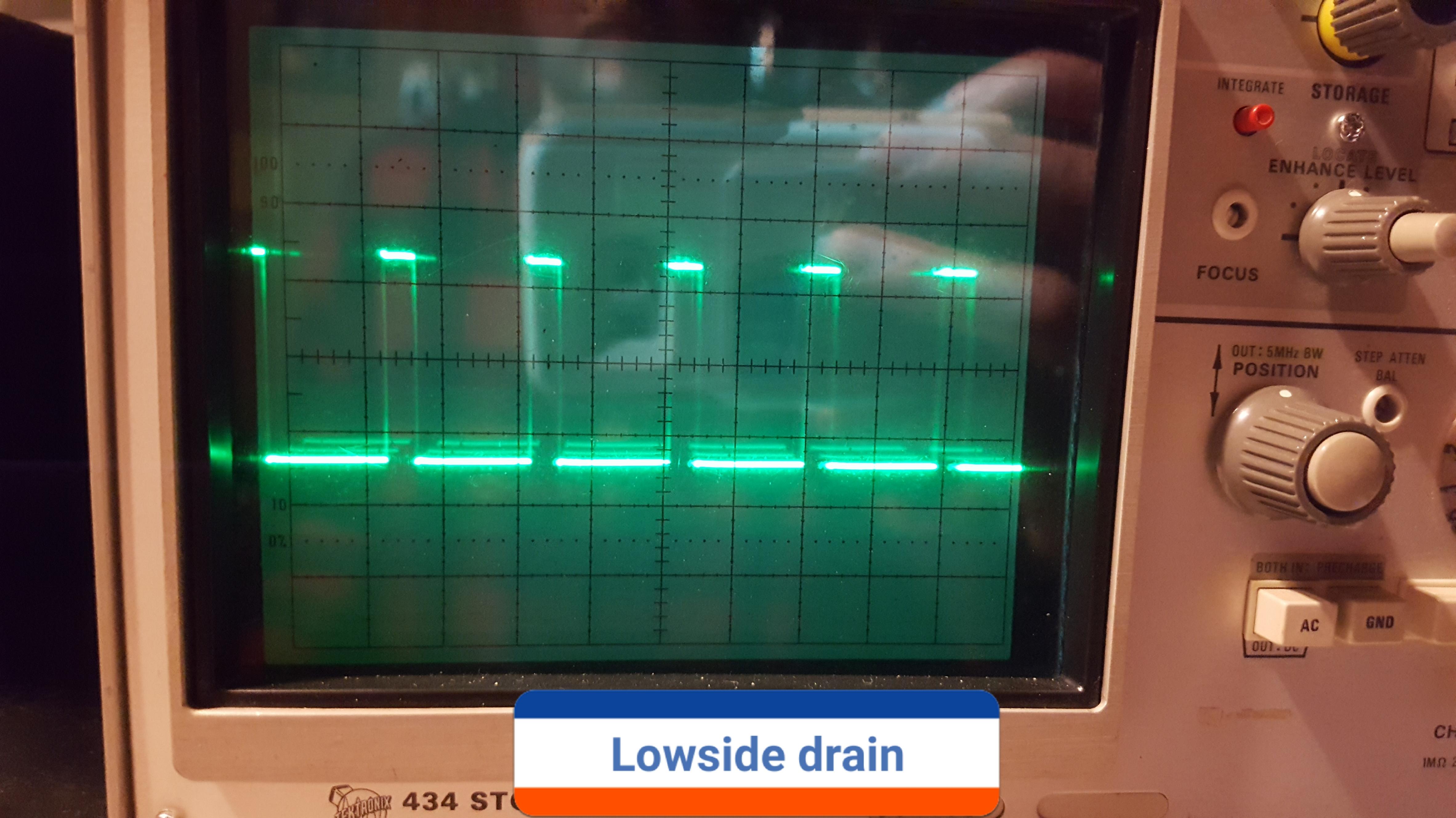

However I pulled the Mylar 10uf capacitors out to test them an they test fine but now with them out the amp will power up and try to stay on and it will produce waveforms but as soon as it trys to oscillate it goes in protect But I did take pics of waveforms by cycling the amp on and off. PICS BELOW
Yes I have the same signal on the other Banks I just put new drivers in because I thought it may be bad driver ic's.

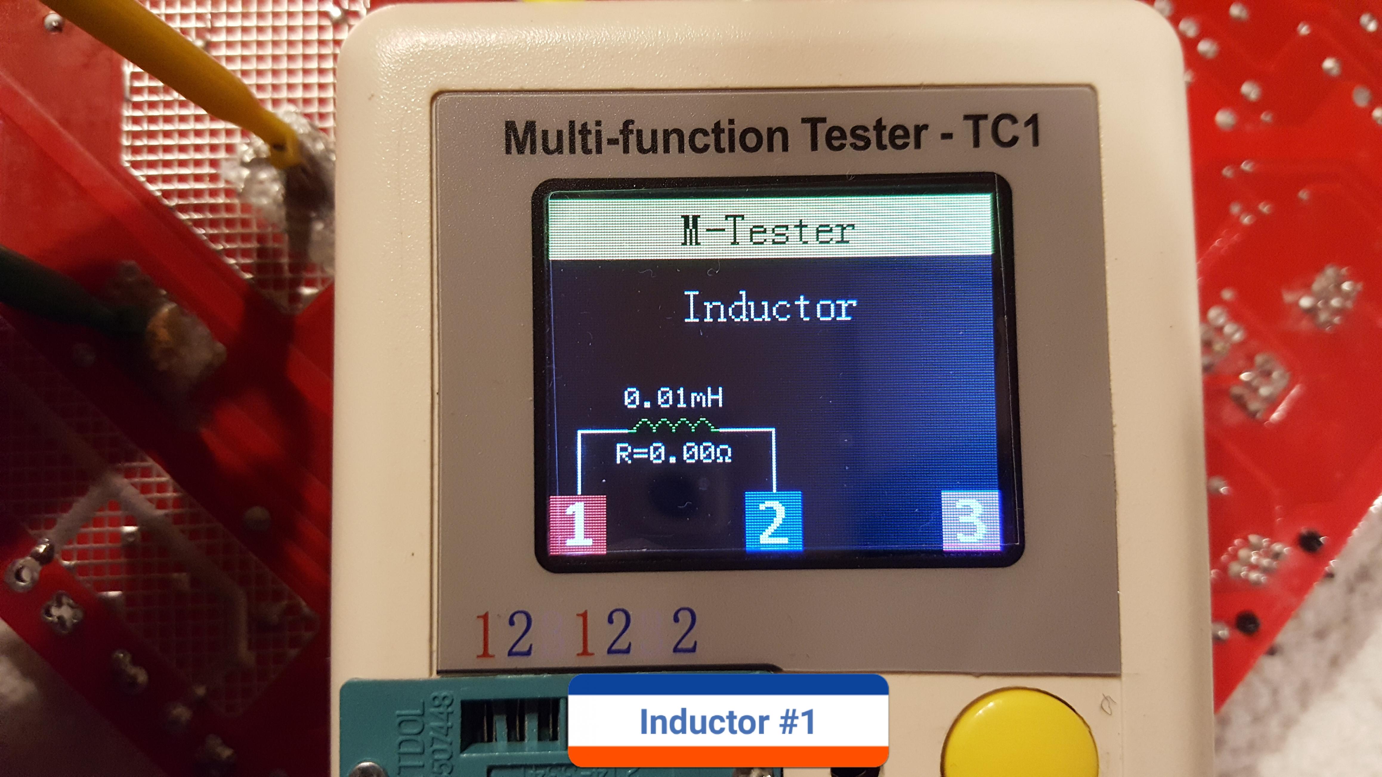

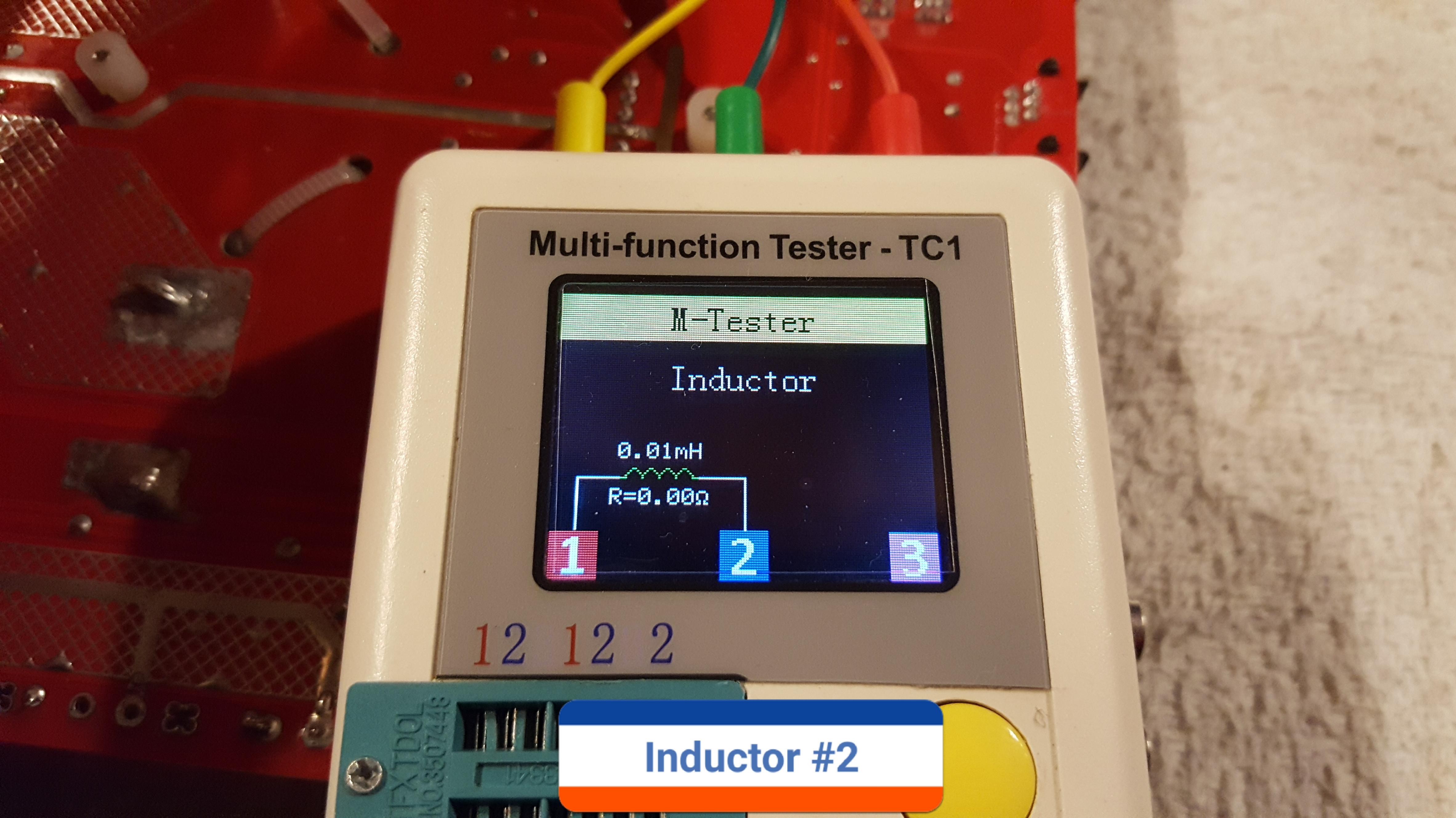

But I was thinking maybe it is my I inductors because everything else in the amp checks out I did a inductance test on them in the board and both read 0.01mh 86.6 resistance.
I think those values are backwards.

Okay Perry the amp will power up and stay powered up with no protection if I disable One IC doesn't matter which one it is however I have positive and negative rail voltage where they need to be but I have no low side Drive I've tried to trigger the scope in but I'm just not getting anything.

Pics below of inductance reading off lcr-meter.

It don't have a scale setting and as far as accuracy I believe it to be a little off on capacitance and a few other things it's usually 10 to 20% off I'll test a couple other inductors and see real fast what the readings are I don't use it too much for inductors luckily I don't run across a bunch of shorted inductors

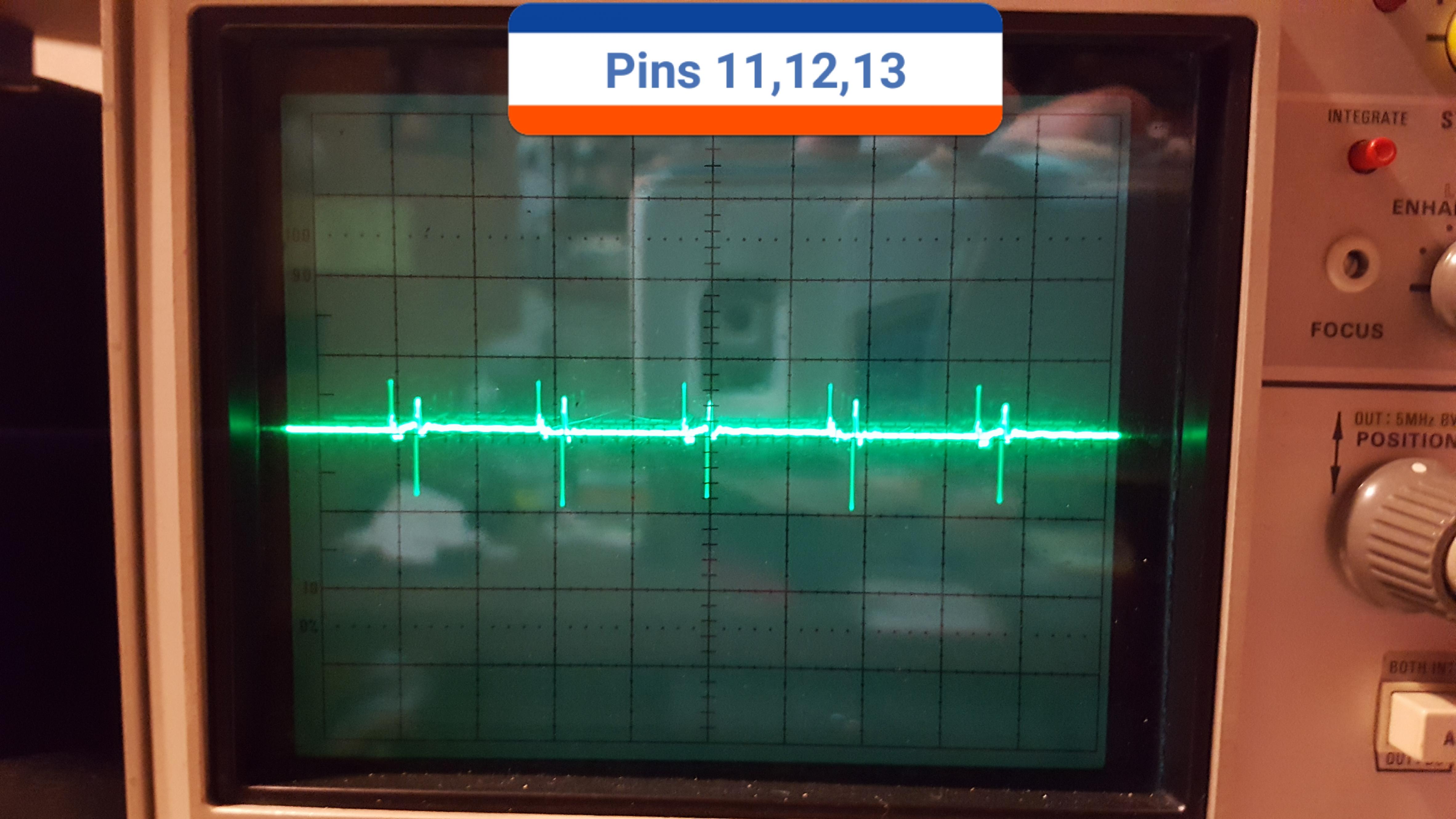

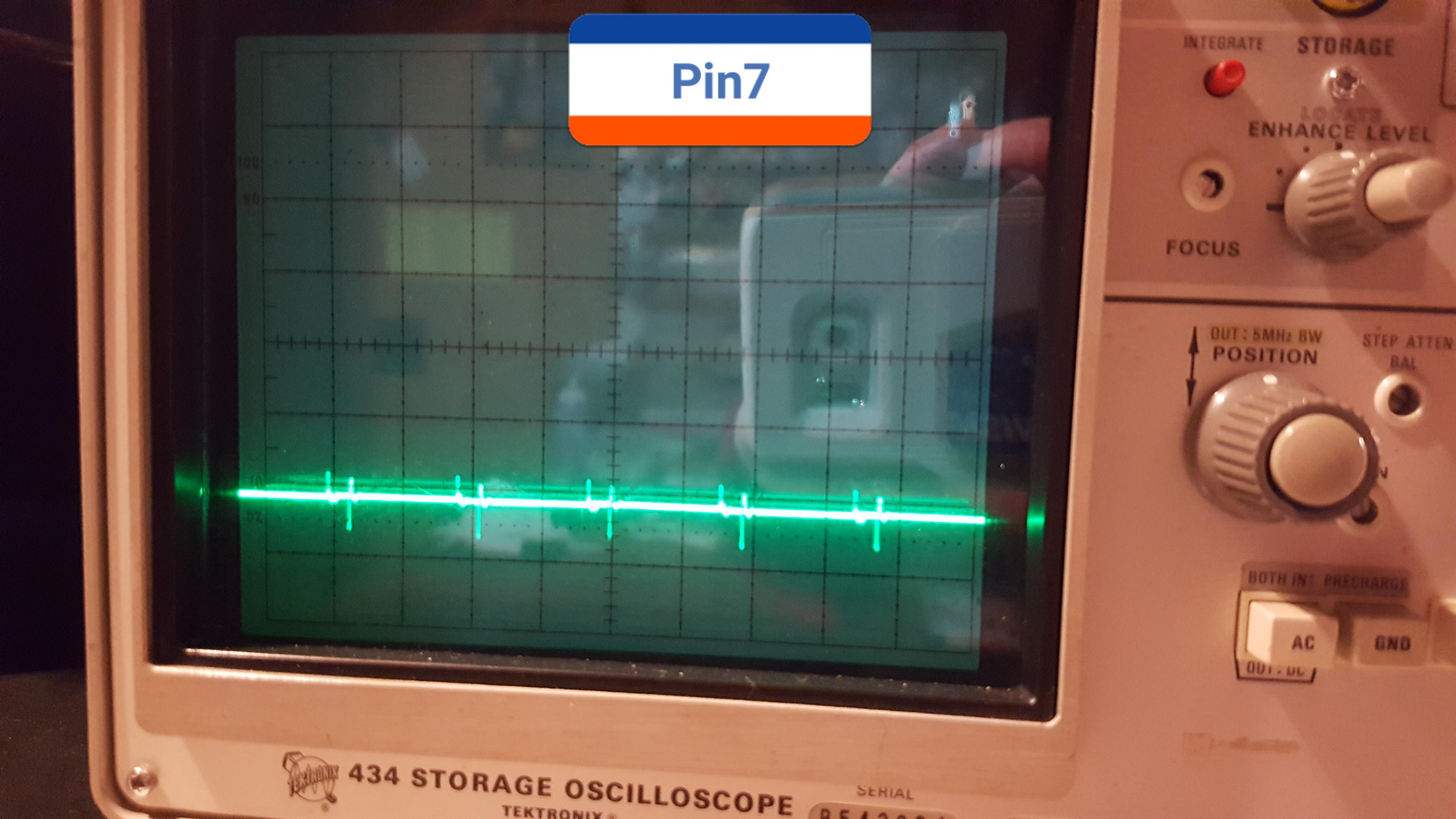

I don't see a square wave anywhere but there is some signals on pins 7,11,12,13
Pics below scope settings are 10us/1v probe x10
