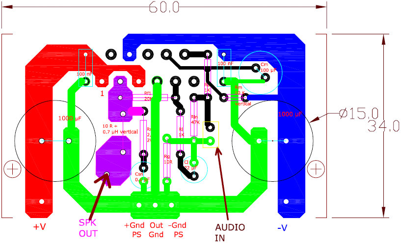

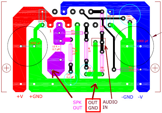

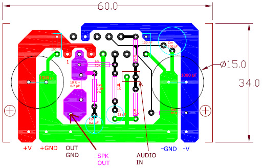

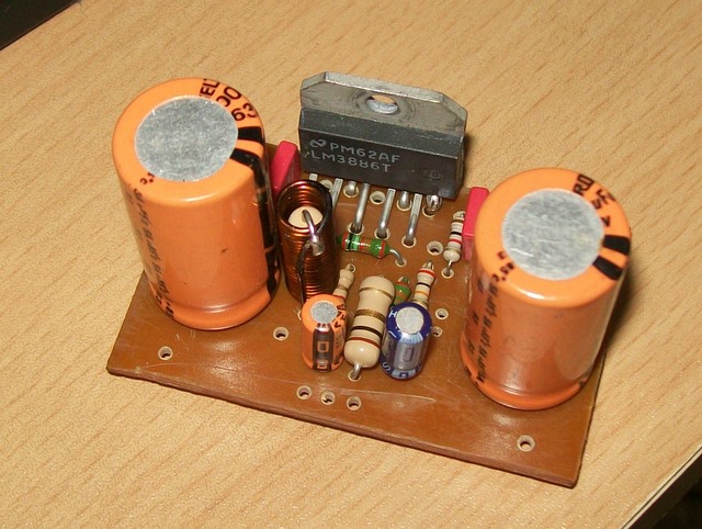

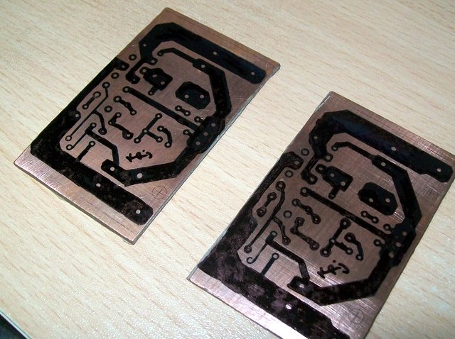

That board is bad . yea it may well work and make sound . the lm3886 is sensitive to layout. And will reward you for exra effort taken in a good pcb layout. i must admit yor pcb looks very symetrical but that sure wont make it sound good.

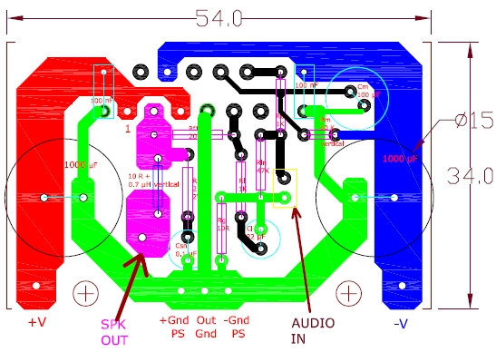

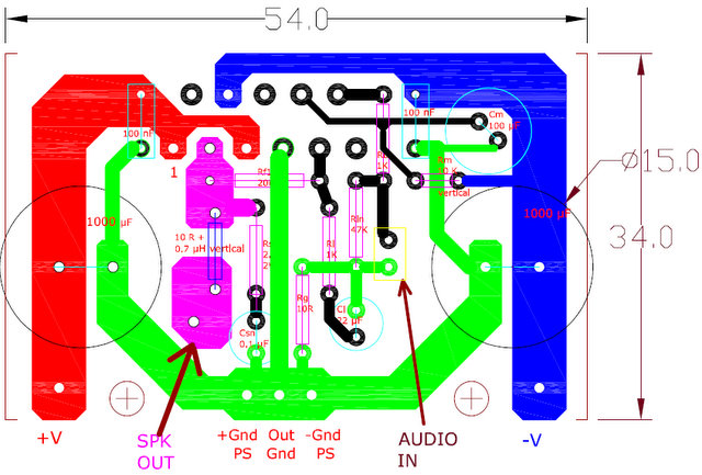

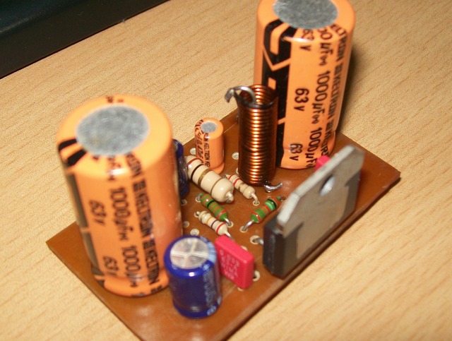

i don't have any grounding issues or any hum of any kind. Dc offset is within .02 V, chip is running cool. what more you expect from a PCB layout.
And i am not bothered by looks or symmetry, that is secondary, But its the byproduct what i got for making a technically good layout.
this is at or near my limit. Does it change (get worse) at various operating conditions?Dc offset is within .02 V,
0.02 V is with my source connected. The amplifier isolated (with inputs grounded) gives 0.003 V.
it changes when the source is connected !
does it change during other operational conditions?
Is there a DC output offset from the source?
The source is my PC on-board sound card, if i use different environmental settings in my sound card, i noticed big change in output offset (0 to .1 V) . Plus the interconnect cable is around 1 meter long and it is close to mouse and power cables. And i have not kept any input cap 🙁
I am working to make a small lm1875 amp that i'll fit inside the PC cabinet and connec directly on sound card, just wait for 1-2 days 🙂
