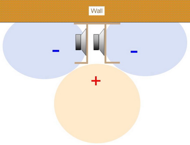

Generally, OB speakers have to be at least a few feet from the walls (the more the better), and I definitely wouldn't put them in a corner......
It'll be interesting if you try this:
CLS, I don't know what you used to generate the graphic, but I think the reality of the situation will have more pronounced squashing of the central + lobe due to the increase in intensity of the - side lobes because of the near rear boundary. If the graphic was done by proper calculation using physics law, I eat my text.
Take it easy, it's just a rough sketch to show the idea only (Powerpoint saved as jpg). As you can see, there's no numbers / coordinate axis or the likes on that sketch😉
Oh, both the (+) and (-) lobes are 'loaded' by the near boundry, aren't they? I added a rear wall on the speaker (not only the 'brick wall'). It's not there in the original design.
Oh, the (-) lobes are also 'loaded' by the near boundry, aren't they?
If you mean the driven impedance would fall then yes, but this works only because the intensity is higher for a greater volume around the driver, which is why it would help to better pinch off the desired lobe, a real -.
