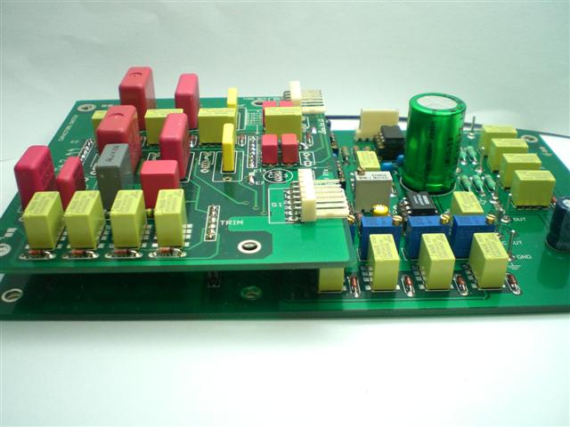

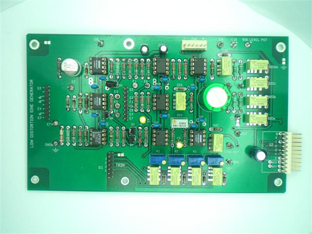

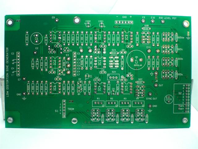

I started the adventure to build Bob's THD Analyzer.
I made new PCB for my implementation.

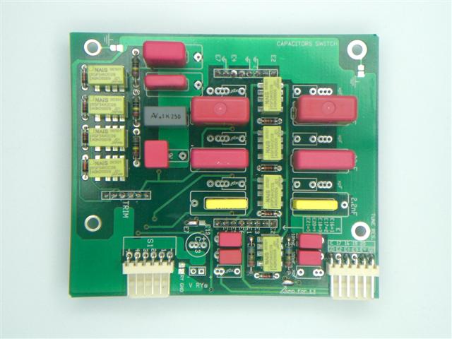

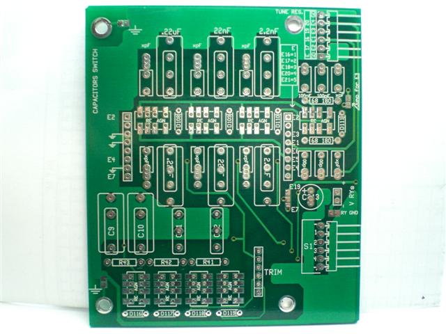

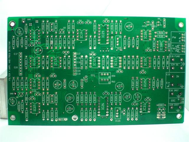

They are: one for Sine Generator and Output Attenuator with the connector for the switch capacitors range board.
The cap sw PCB for Sine Gen, and Filter range (two equal for both).
One for Filter, Amp and Freq Detect.
One for Output Filter with connector for the Meter
One (little) for Meter circuits. Mount AD536AH for RMS conversion

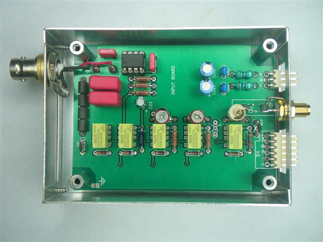

One for Input Attenuator/Amplifier
I still have not decided how to switch the resistance of the frequency, probably Optofet or Photoresistors but they latter have serious problems of thermal drift.
....le first photos

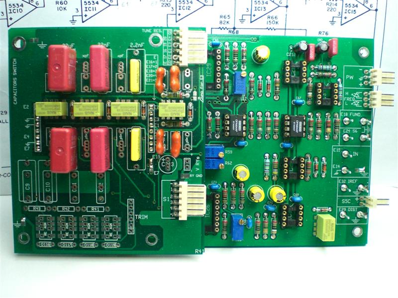

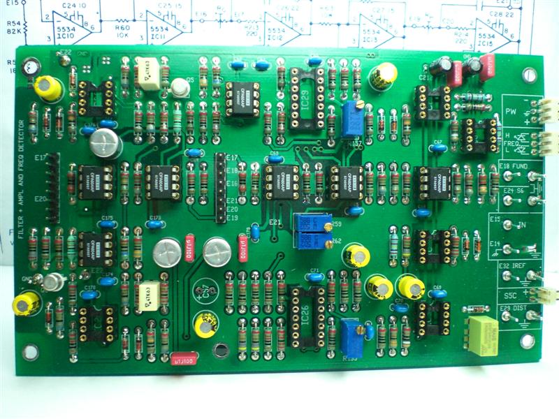

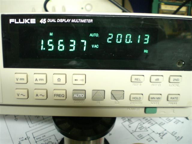

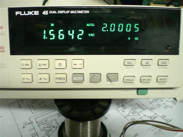

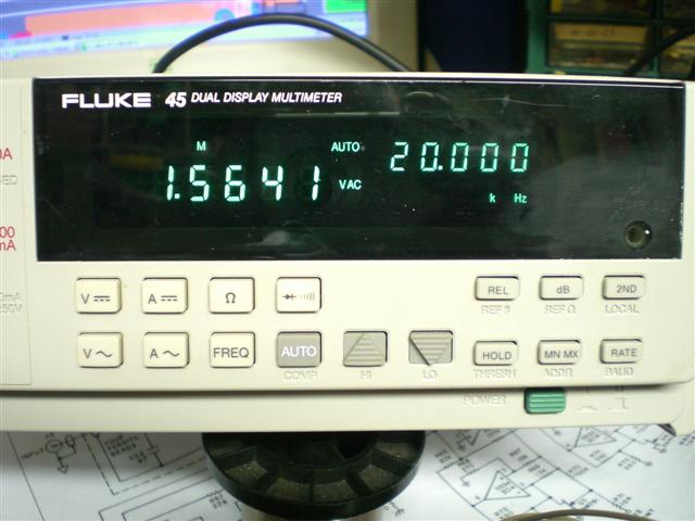

These output levels at various frequencies.
(The 200KHZ is the same level )
Note that with the 200pF Wima (in the photos) the generator was unable to go beyond 70kHz. Now I replaced them with Silver Mica and it reaches up to 250kHz without problems and with the same output level!
Test of distortion was done with Hameg HM8027 but it reveals nothing! (Long life to Bob).
...to be continued

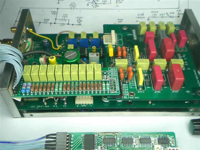

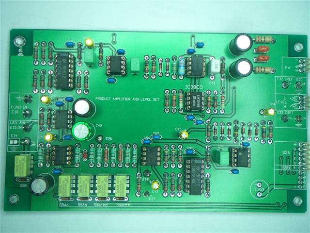

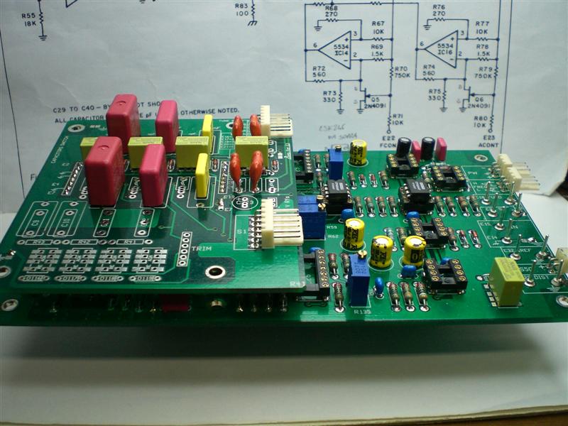

This is the, tested, Voltage-controlled bandpass filter with on-board caps-switch pcb.
The empty sockets of the IC refers to the amplitude and frequency detector and LED tuning frequency, in progress.
To be continued.
Hello
The circuit does not oscillate in the range of 200 kHz if resistors (E) - (F) connections are longer than 2 / 3 inches. It is even worse if I use shielded cable.
If increase the value of C (LN) only (470pF i.e.), then the circuit takes to oscillate (frequency appropriate to the capacity added) and by bypass cap resistors series.
I do not think the PCB tracks are longer than the original circuit wiring.
Which is the reason for that?
Resistors (F)-(E) values are 10 binary connecting so as to obtain intermediate frequency values.
1024 steps provide hertz fractions for low ranges and up to 175 Hz in the highest range.

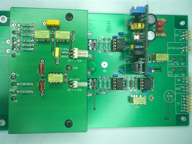

Fixed Filter and meter board with AD536 RMS converter.
To simplify the implementation I preferred, for now, build the output fixed filter.
The main PCB provides the tracking filter components.
To be continued…

Guilty even of too many options that I decided to add: Frequency counter and two RMS digital voltmeter (for IN and OUT signal).
I am happy to share the PCBs files with you.
But PCBs are Circad format. If it is not 'a problem for you.
If necessary, I have the standard Gerber files.
If someone wishes, I have available a complete set of PCBs.
They are designed for use with 9V mini relay (AGN20009) instead switches.
