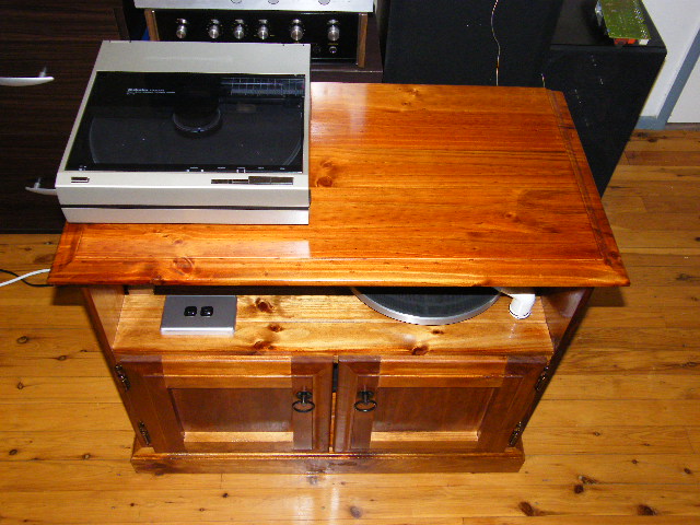

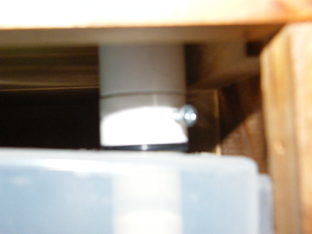

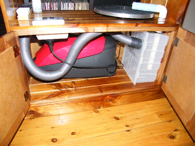

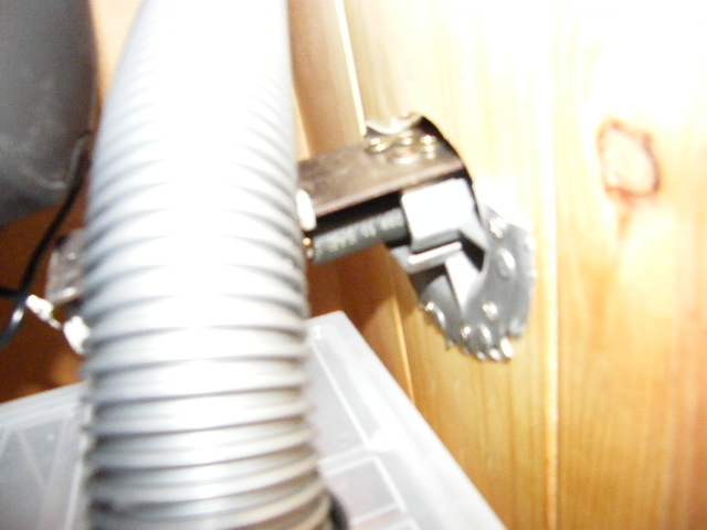

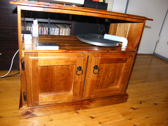

:D After reading the articles here about do it yourself RCM's I decided to have a go at one myself!!,the hardest things were the bearing and drive and the suction arm (making it work well and not damage the record).I made the bearing from an old motor from a dishwasher!! mixed with a record player bearing,I used a planetary gearbox kit from Jaycar (Im in Australia) 400/1 reduction gave more than enough torque for the job!!,I also used a TV stand that I bought to house the project,a good vaccume, some switches and power outlets,(Im an electrician so this bit was easy!!),Im at the testing stage now and all seems to be working great but yet to compare to standard cleaning,I also bought a steam cleaner so I will try and test that as well!! I will post some photo's now,Thanks to all the people who have posted articles on RCM's,it's been a great help and inspiration!!!.

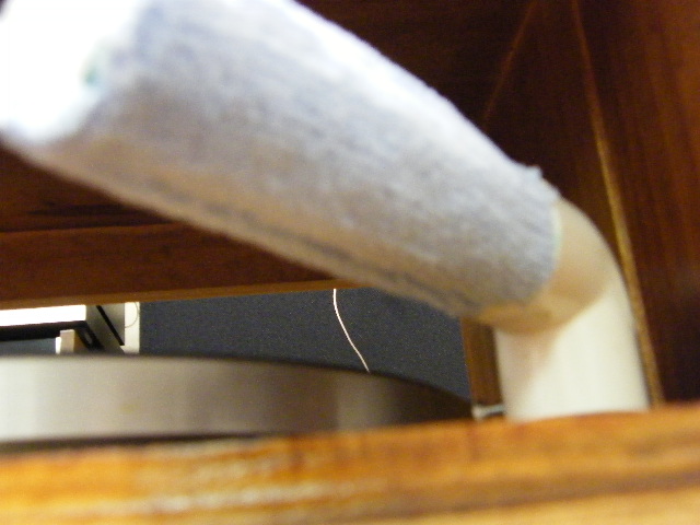

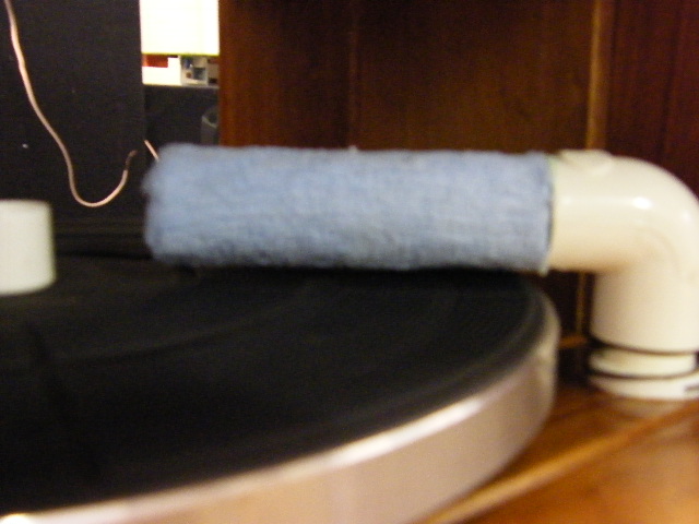

:D Hi here are some pictures of the suction arm,there not very good,it's hard to photograph!!,it is made from 25mm plumbers pipe and wrapped with two layers of microfiber cloth with a big slot cut in the bottom of the arm,i'ts working well,I have cleaned quite a few records now and Im happy with the results!!,I have posted a clip of it working on youtube, search for record cleaning machine!! or here is the address,.http://www.youtube.com/watch?v=Y-BS3aozlUA Thanks again.

Speedysteve7...
does the thread get sucked through or wound on a spool as per the Keith Monks?
I've got an old Yamaha DD that I could use for this purpose. I've actually used a "Shark" vacuum for removing dirt and gunk from records. I was them with fluid and a brush on my turntable, then just use the end of the hose (wrapped with a microfiber cloth taped onto the end with black "electrician's tape") to suck up the stuff. Crude, but works well.
I have observed Mr Monks machine in action - very nice.
No, the thread is static for one sides cleaning and then I pull through about 1/2" new for the next side.
I found silk thread that is slightly thicker to be good.
I am not too concerned about dirt build up during one side - the thread sits in a strong air vortex that seems to suck all gunk off it and looks clean under the magnifying glass after a side. Of course on the microscopic level there will be contamination.
I do have to pull the thread out of the sucker tube every now and then which eventually makes it way all the way to the jar.
