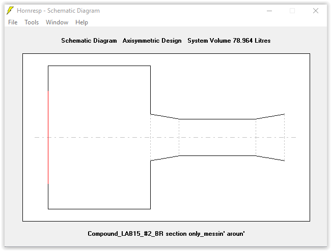

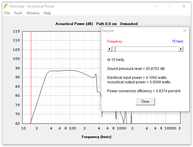

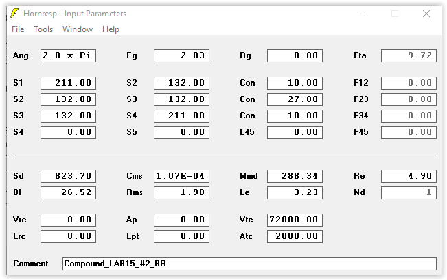

I like to mess around in Hornresp using the horn sections for the port, you can come up with all kinds of interesting vented arrangements (no trees will be hurt). I'll attach one example.
