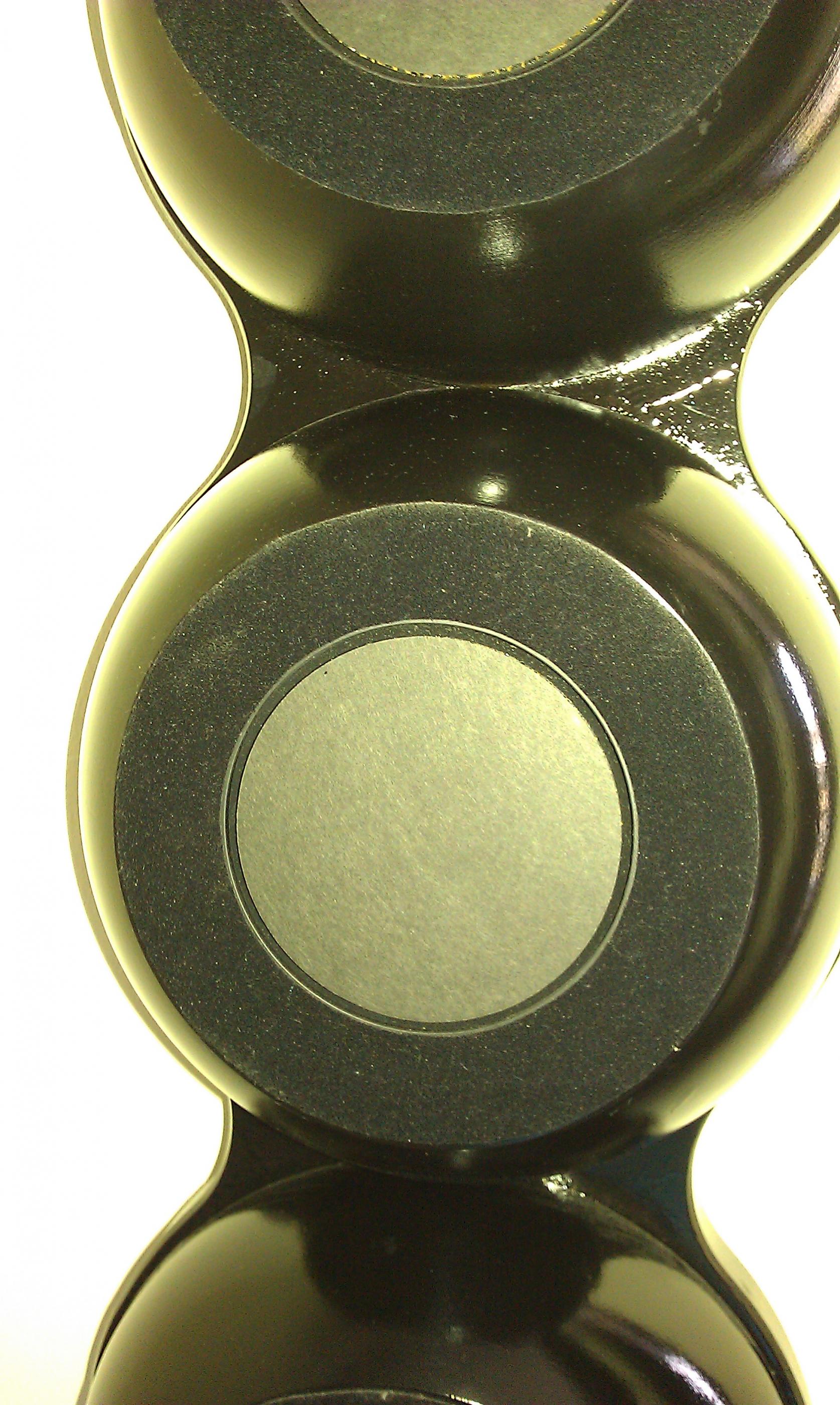

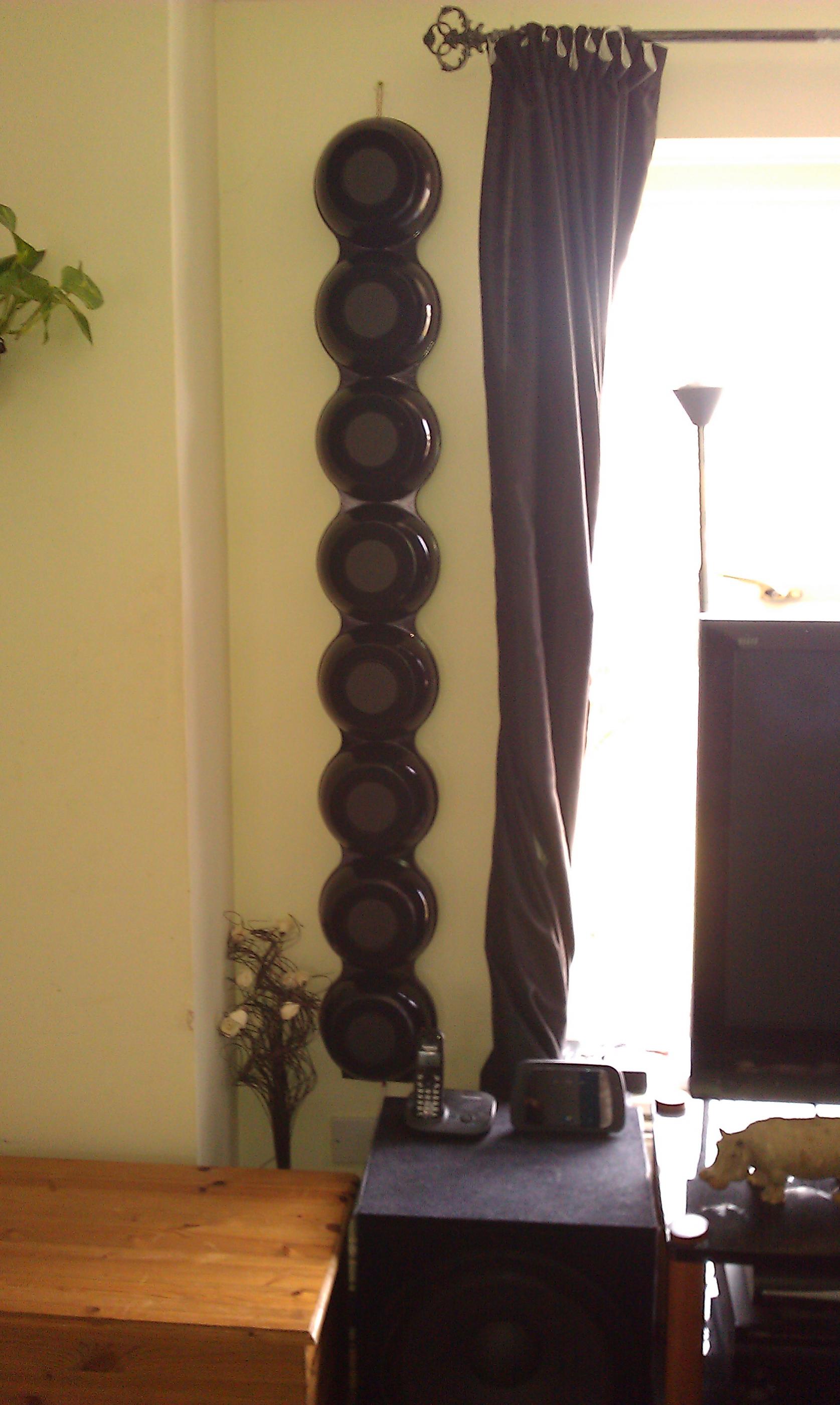

I am interested in buying a few boards ( up to six ) to build into the back of my BMR ( 4.5 inch Neo) full range line array loudspeakers, pics attached.
My entire audio system is LiPo battery powered, and I am building my own music and movies fanless PC which will also be battery powered. Even my TV is about to be battey;d!
I have read all your recomendations but I am still a little unsure of the "End Game" version you suggest.
Can you please summarise your ultimate "wish list" of mods in order of most important first?
I have access to low cost LiPo batteries at all voltages and current capacities so where ever possible I am happy to bypass / replace voltage regulators...

Hiya,
Thats easy!
Fire wire out of the Sony into the Foucusrite Saffire ( battery powered) SPDIF out into my DEQX ( battery powered) into my power amps...yes battery powered!
Also I have to tell you another way, not very High End but really remarkably good sounding for the low cost and convienience...
No fancy power amps, no fancy DEQX, not even a crossover...Just feed the SPDIF straight into a home cinema amp, ( or low cost stereo intergrated amp or even power amp) even a mid range Yamaha (mine was approx £400 I think), I run it in "Pure Direct" mode for music.
This still allows me to use JRiver Eq for the full range line array BMR's...
Its so good and low cost no hassle two of my non audio mates have asked me to build them a pair...!
Cheers
D.
