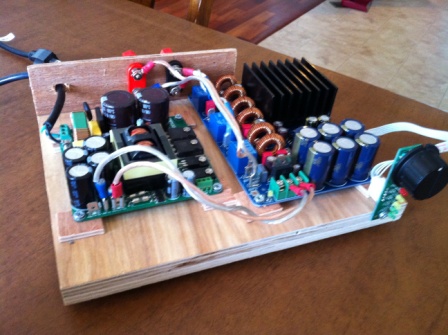

It lives...
and makes music!
Initial impression:
- Strength: Sounstage and imaging,PRAT, midrange clarity
- Weakness: treble sharpness. Perhaps I need to play some more?
Excellent build quality
Comparison system: Audiosector USB DAC -> B1 preamp -> Modded sure amp (Dayton input & output caps, air core coils), not as good PRAT but smoother.
Speakers are Pispeakers model 2 (Suits me better than RS Natalie P.)
Thinking about replacing the coil with Wurth. I think the stock coils are 11uH, which Scott Endler recommended replacing them with 4.7uH 9.3A Wurth.
At first I had some trouble getting it to play. Things to watch out for:
- Main connection to the Connex SMPS is GND - AC - AC
- Out from SMPS is GND - POS into GND - V2 in the DDX320
- DIP switch set to ON-ON-ON-ON (pass thru). The default setting is OFF-OFF-OFF-OFF which is 320Hz High pass. Make the sound tiny and stuck to the speakers

Hi guys.
I'll do some surgery on the board.
1. First of all. Is there a layout of that board available to the public??
2. On a first visual examination I noticed two empty pads.
R3 is missing (close to the Torx).
C70 is missing (close to the STA320).
If HifiMeDiy is still following this thread, please let me know if that is an issue.
3. What I'll do next
a. getting rid of the relais
b. and plugging my Wuerth coils in. I'll put them underneath the board.
Somehow I don't want to have those coils sitting right next to the
surrounding resistors, elcos etc.
c. let see

Thx Hifimediy. I guessed that.
Progress Report:
Stage 1:
I applied some tweaks. Relays removal, Würth coils ( mounted underneath the board), better chip decoupling.
Folks. 100% success. The sound was really nice at this stage. The noise went down
considerably.
I've been enjoying that modification level for exactly one day...
...when I decided to apply further mods that I still had in mind and were recommended by a friend of mine..
Stage 2:
1. replaced the 3.3.V with a low noise type -- with a temporary separate power-on switch.
2. removed the woofer relay and coils -- and left the outputs open!?!?!?! ( open output -- problem??)
3. Some more decoupling
THAT ONE FAILED!!!!!!!!!!!!!!! Noooo, I can't believe it.
After applying those final little tweaks everything seemed to come up again -- all voltages were there, LEDs on, PIC seemed to work...
...BUT ---- NO SOUND.
Folks that's driving me crazy. Two days ago I had a great performing amp in my
hands and 10 hours later I screwed it. Damned.
I've been looking for almost a day after the problem. All voltages seems to be OK. I also
put everything the way it was the last time it worked. Still no sound.
I'm running out of ideas.
I guess without a scope it'll be difficult to trace the issue down.
PLEASE: If anybody has an idea of what can go wrong or what and how to verify.
Please let me know.

Progress Report:
Stage 1:
considerably.
Stage 2:

Hi folks.
I don't give up on it. My device is still not singing.
I measured some pins at the STA320 while data are delivered from the source. It seems to stay quiet.
DDX1A/B = 0V ( seem to be kept low)
DDX2A/B = 0V
RESET= 3.3V
EAPD=0,9
TRI_STAE=3,3
OCDETECT=3,3
FAULT=3,3
TWARN=3,3
Can anybody confirm above values to be OK??? What would I have to check next??
DDX2A/B = 0V
RESET= 3.3V
EAPD=0,9
TRI_STAE=3,3
OCDETECT=3,3
FAULT=3,3
TWARN=3,3
BTW: The 5V reg, is it only used as 3,3V pre-regulator. If yes. Could it be removed in case I'm using an external 3.3V supply??
Thx for your support.
Cheers
RESET= 3.3V
EAPD=0,9
TRI_STAE=3,3
OCDETECT=3,3
FAULT=3,3
TWARN=3,3
These levels seem ok.
And 5V is not used for other device except a LED (for power).
DDX1A/B = 0V
DDX2A/B = 0V
Means no audio signal output from sta320, so may be you have to check the I2S signal from CS8416 to sta320 first.
RESET= 3.3V
EAPD=0,9
TRI_STAE=3,3
OCDETECT=3,3
FAULT=3,3
TWARN=3,3
DDX1A/B = 0V
DDX2A/B = 0V
RESET= 3.3V
EAPD=0,9
TRI_STAE=3,3
OCDETECT=3,3
FAULT=3,3
TWARN=3,3
DDX1A/B = 0V
DDX2A/B = 0V
THX for the feedback. Step by step I'm hopefully getting there. 😉
I'll try first to check the I2S bus with a voltmeter. Should be sufficiant to see if anything is ongoing.
I'll get a scope next week. That'll be much better.
Cheers
I2S checkup:
1.6V on bit and word clock
on the data I measure 0.8 when
playback is started.
The signal seems to arrive at the 320.
Looks good I guess.
Looks good I guess.
Hi there.
Just a stupid question -- as I said I do not have any background in HW design.
Why is the thermal pad of the 3,3V regulator connected to the positive 3.3.V rail on
the board?
I'd expected a ground connection.
Anyhow. I had my friend check his setting. It's the same over there. It doesn't seem to be a problem at least.
Cheers
the board?
Cheers
A multimeter is useless for digital signal I think.😱I2S checkup:
Looks good I guess.
It's normal, it's 1117-3.3 regulator has output on the thermal pad, just like LM317.Hi there.
the board?
Cheers
No. I don't think it's useless. I can clearly see if and when the playback is started. The data line level goes up on the voltage as soon as I press play.
Obviously I can't verify what kind of data in what shape are delivered. 😉
My scope just arrived. My troubleshooting options should slightly improve
soon.
Cheers
