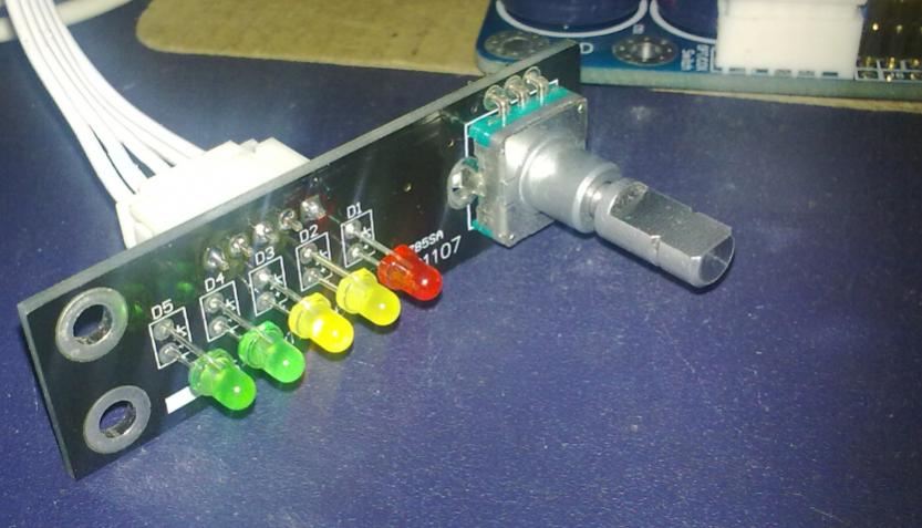

news
I think you should already knew what's this.

Interesting - what do the LEDs mean? The socket in back could be a tight fit for a small case, but then you could probably solder the wires directly. Or is the panel optional?
My guess is that the leds mean, from low to high;
green 1 = signal present,
green 2 = signal at -36dB
yellow 1 = signal at -18 or -12dB
yellow 2 = signal at -6dB
red = signal clipped, ie over 0dB
It's the sort of thing you'd use with a level control...

:D right.
this is my setting:
green 1 = signal >-40dB
green 2 = signal >-20dB
yellow 1 = signal >-5dB
yellow 2 = signal at >0dB
red = signal >10dB, and 20dB maximum.
