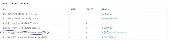

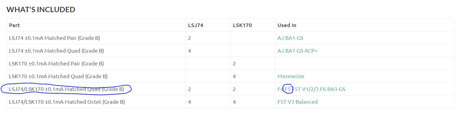

Hi again. I received my matched LS-k170B matched quad. As I’m looking at my build guide, that is a little different that the devices recommended for q1 and q2. Do I need to source more matched devices as in 2SJ74? I feel more and more like a novice as this project goes on.
Thanks.
I have figured it out. I am quite annoyed by the way things are described and pictured in the diy audio store page where I ordered the damn jfets. I read the description and looked at the picture and hit order. It’s my 3rd error trying to get these things. It’s another $40 and another week waiting to finish my build. Grumpy I am.
Just in case you're unsure of what you need. This is where to look for the JFETs for the F5.
Linear Systems Matched JFETs – diyAudio Store
