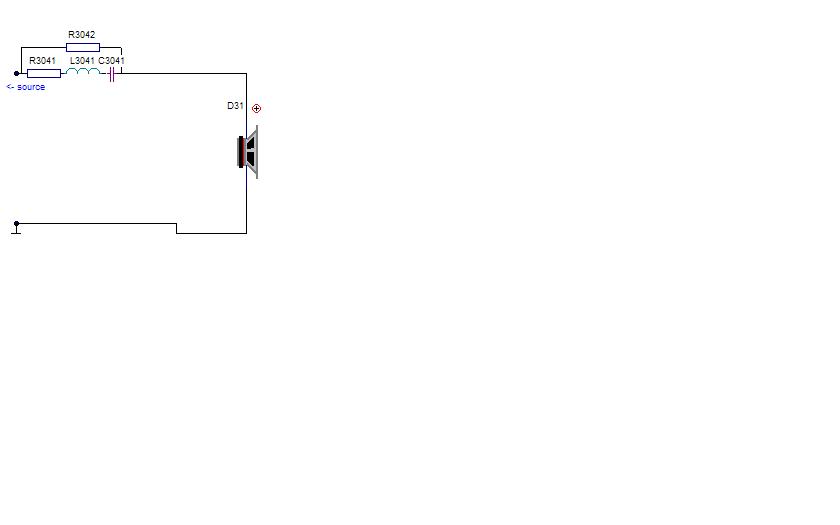

This is a useful general circuit for passive EQ'ing HF waveguides:

About 1.5 microfard of capacitance in parallel with a 20 ohm resistor in series does wonders. Tweak it with a larger resistor for more mid drop, smaller for less. Change the eq point by the size of the cap.
