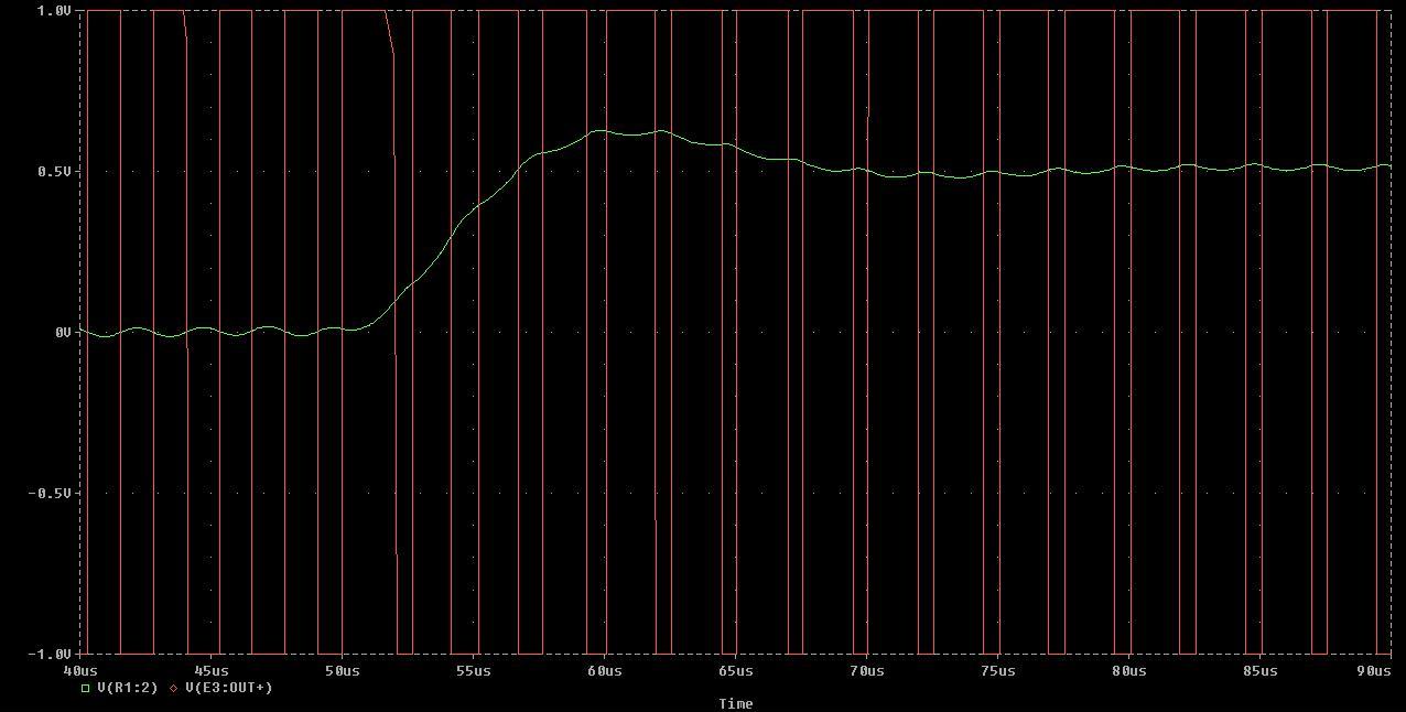

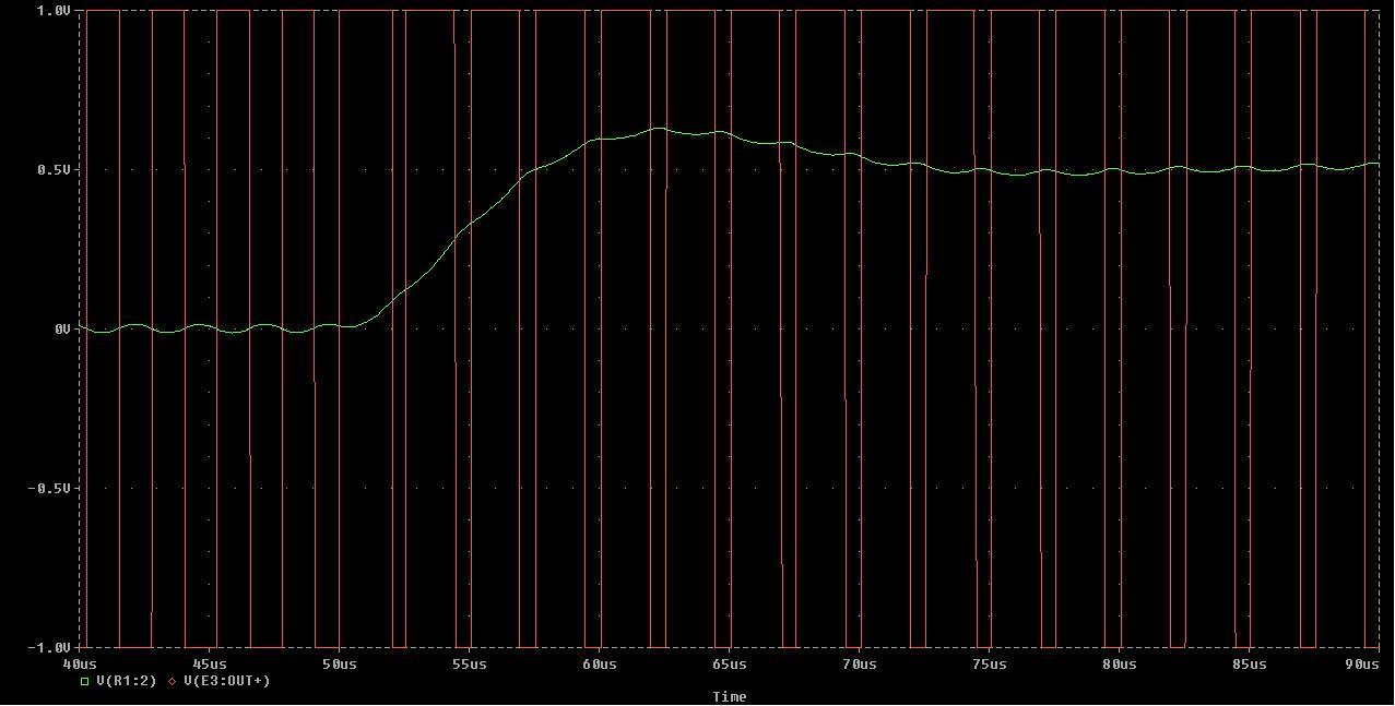

The enclosed simulations were done with the model from the paper. The output filter is 20 uH and 760 nF - resulting in a pole frequency of 40.8 kHz and a Q of 1.15 into a nominal load of 6 Ohms.
The small-signal bandwidth of the arrangement is theoretically the same as the unity-gain frequency of the loop. In the paper there is also mentioned what to do with this bandwidth and what is better be avoided.
So let's first have a look on how it behaves when used the way one shouldn't: The step input signal was directly fed to the input - withput any bandwidth restriction.
The amplitude is 50 % of the maximum input signal. Both nominal load and 1 M Ohms is shown. The latter meaning that the resulting load is actually consisting of the feedback resistor which results in a filter Q of slightly more than 400.
It doesn't fare too bad IMO given that it is used in a mode not foreseen.

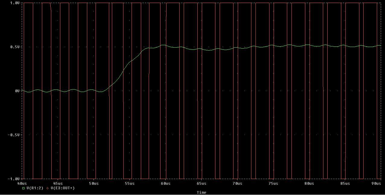

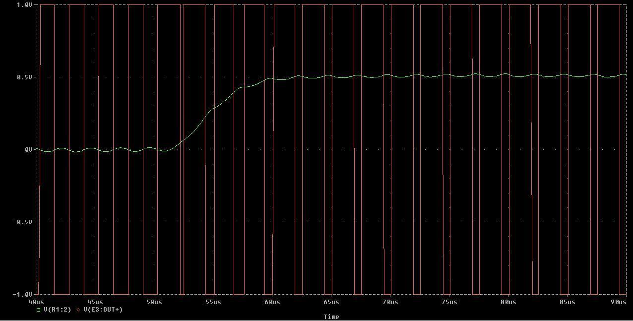

Now this is how it looks with a pre-filter. Used was Bessel 2nd order with - 3 dB cutoff frequency of 60 kHz. This might still be too high when someone intends to feed it with square-waves from function generators etc but it would be OK IMO for the use with practical audio signals. But everyone is open of course to use a lower cutoff frequency, a higher order filter or design with a higher output filter pole frequency or a lower output filter Q or ..............
The left one is again into the nominal load the right one is again with 1 M Ohm load.
Regards
Charles
