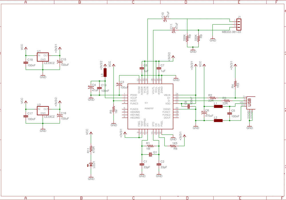

Hi, I built a PCM2707 based USB DAC, but WinXP don't recognize it :bawling:.
It says "usb device can't be recognized due to malfunction", or something like :cannotbe:.
Attached is the schematic. 2707 is used in self powered mode, feed by two LDO regulators. Voltages on the regulators are ok, but pin 32 (Vcom) is 0V.
I can't believe I've killed the PCM2707, because I soldered it very carefully.
Any hint on what may be wrong? TIA.

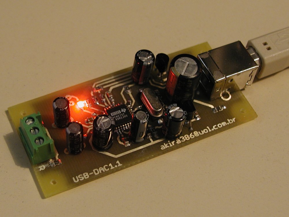

Is pcm2707 very sensible to the ESD? More than other chips, I mean :confused:.
My soldering iron is not grounded... I'm starting to think I've killed the PCM by ESD, although I never have made it before, soldering opamps.
Appears good, but doesn't work :smash: :bawling: .
Hi Akira386.
I took a look and compared your schematic to my schematic. I use the PCM2706 in the I2S mode so there are differences but from what I see yours should work.
Have you had your circuit working as a prototype so you know it will work? Or maybe this is your first prototype.
Could it be that one of the pins is not soldered? I would guess you have checked continuity with a meter already.
If you have a scope check to see if you have any signal on the clock pins. If you do then you know the chip is not dead. If you don't then it tells you nothing.

Thank you for the input, guys!
It's my first prototype, Brent. I was confident that it would work, it is so simple, but... :(
The only instrument I have is a DMM... :ashamed: Measuring from the GND, it has 3V in the XTI and 3.3V in the XTO :scratch:.

I removed the PCM following Brent's advices, and luckily no track came off.
But with a new PCM in place, thing got worse. Now, Windows does not detects it.:bawling:
3.3V is presente on Vdd, Vccp, VccR, VccL, Fsel and Test. Everything seems ok, but no sinal of life.
Vcom is 0V, and so is SSPND..
Very intriguing. Have I made a PCM killing board?:cannotbe:
Next I will try to replace the crystal :smash: .

I replaced the crystal, but no effect. It was not the culprit.
Then I replaced the PCM (again) and now it worked! Windows recognized it as USB audio device. :D :D
After much trouble, finally it's working.
Thank you for the assistance!
I had no time to listen to it carefully, but the first impression is that it sounds not so good as my reference, a modified Optoplay. Not bad for a monolithic chip, I think.
Next, maybe I'll build a PCM2707 -> I2S -> TDA1543 one. :cool:
