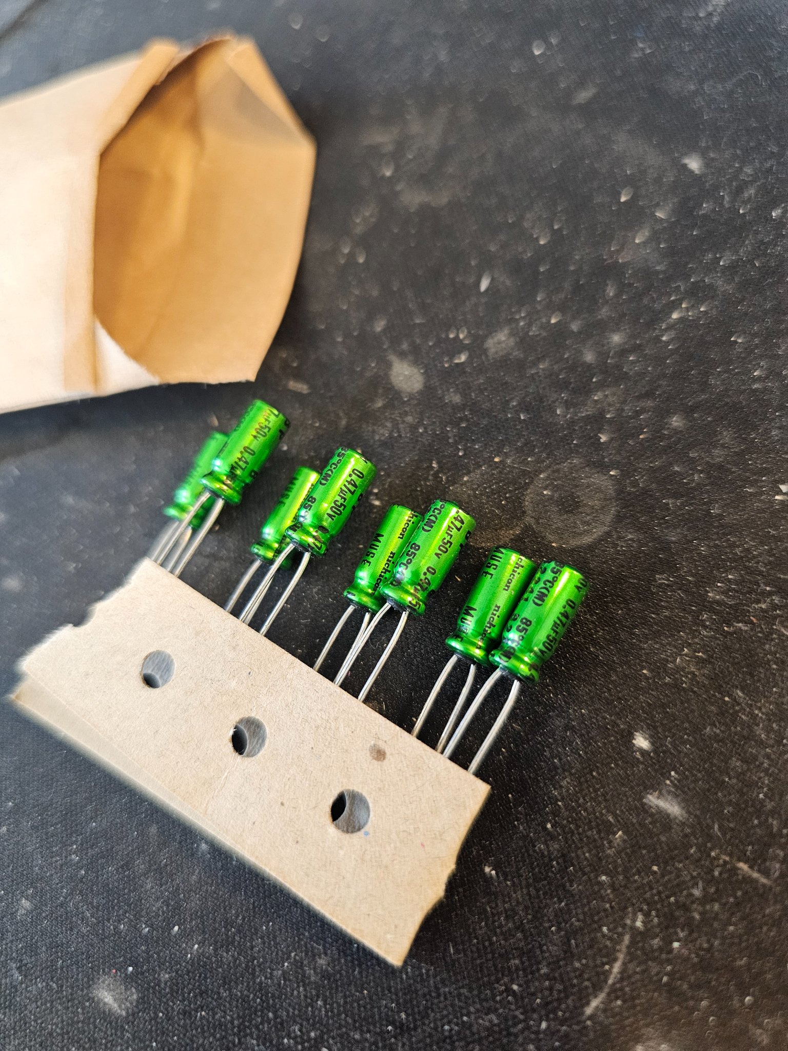

My 0.47 caps have arrived however as I see i have rubycon so I think I will leave on the board as it tests fine

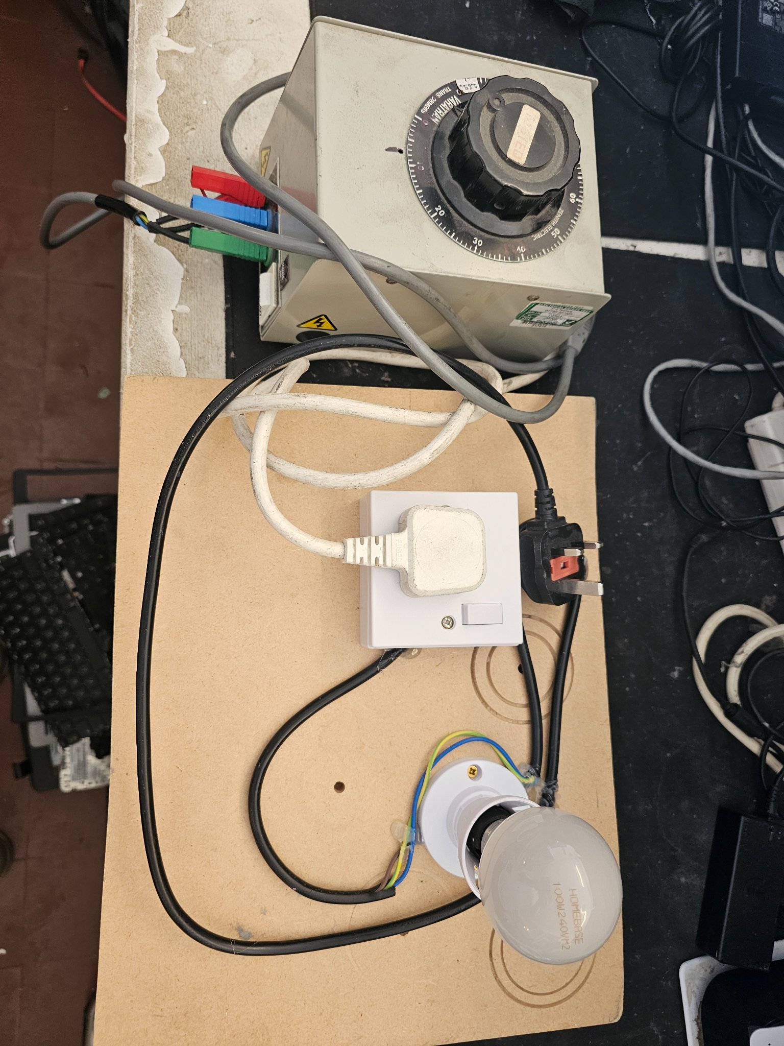

I have also got myself a variable and made a light box for testing🙂

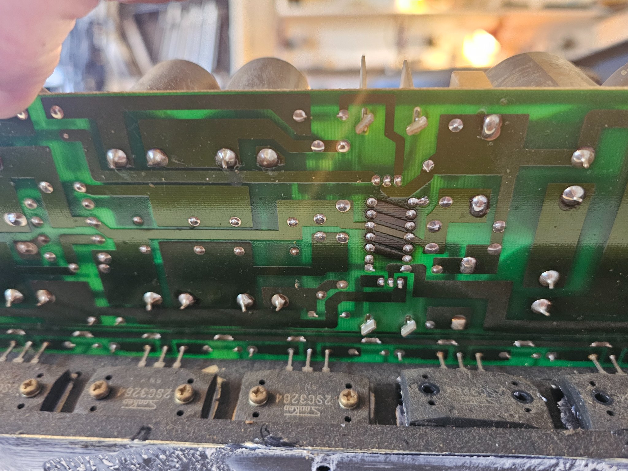

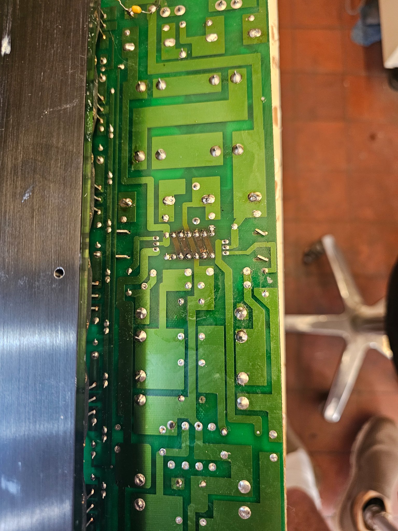

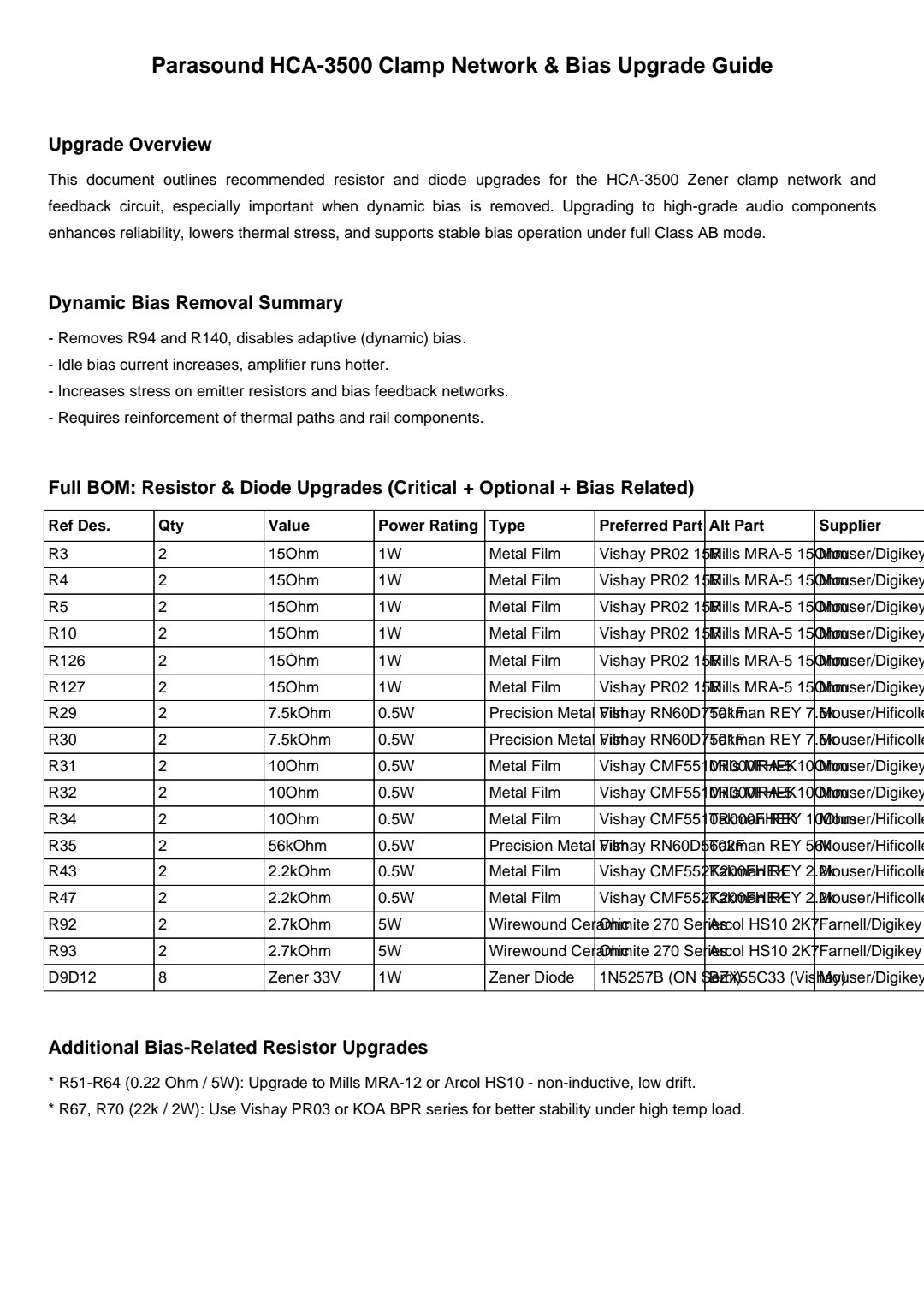

Before I even try powering it on I think I'm going to address the issues that I have around the zener diode region
The problematic right side is alot worse in terms of scorching
But I had noticed the left channel has heat stress also, just now
So

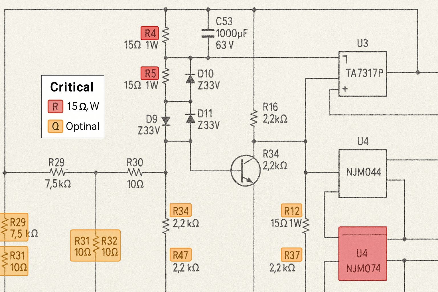

With a bit of AI I found what probably needs to be done
If someone wouldn't mind giving a human eye over this as I have removed dynamic bias so the board will be subjected to alot more heat stress over time
@bigskyaudio what are your thoughts?
r4 and r5 are measuring around 7.5 to 10 0hms on both boards when schematics say 15?
way out of tolerance, but consistent between driver boards, was this on purpose at factory?
Im lead to believe this could be the cause...

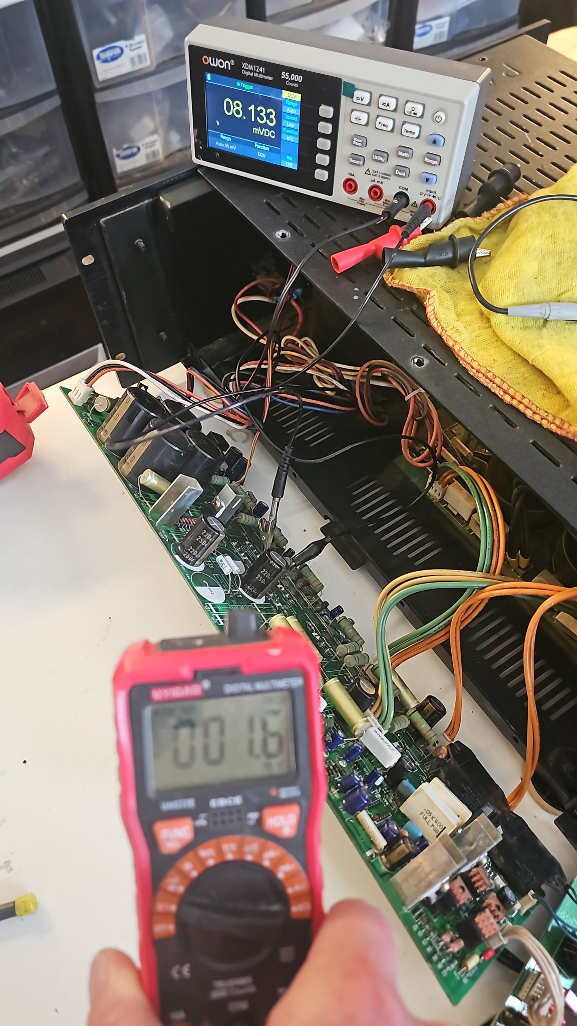

Ok I jumpered tvr2
And put a pot back on tvr1
The course is very brutal with a 2kohm pot
However I have mv on emitters now however I cannot go over maximum 8mv
As u can see on picture I have dc of set and emitter readings
Seems protection kicks anything higher
I can play music very loud and the emitters go above to around 14mv which is ok
However if bias is set above 8mv I get no output
Any ideas?
