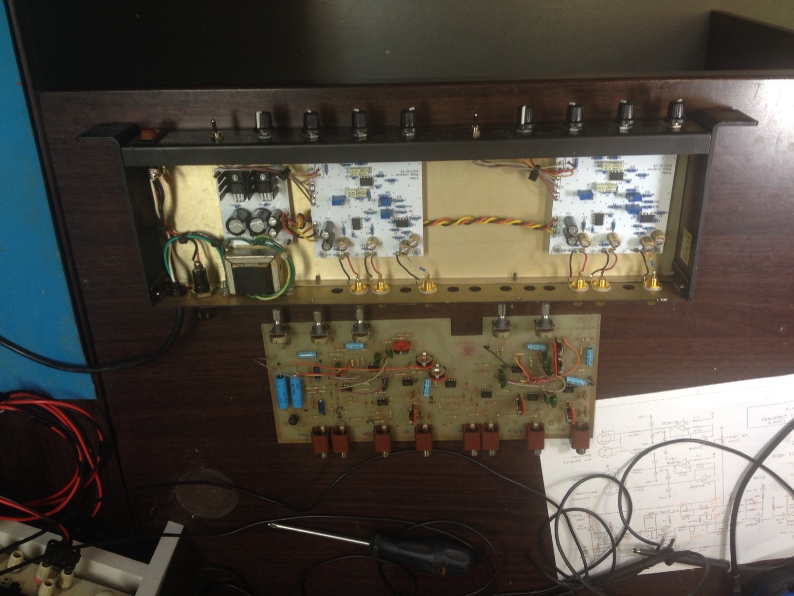

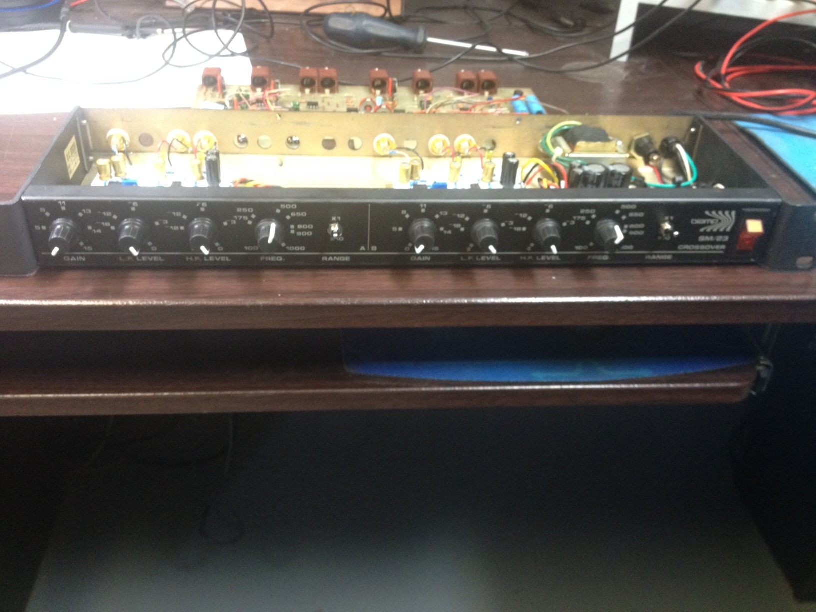

picture of the xover. 1st pic shows the old board, i made 2 seperate board, the white ones, one for each channel.

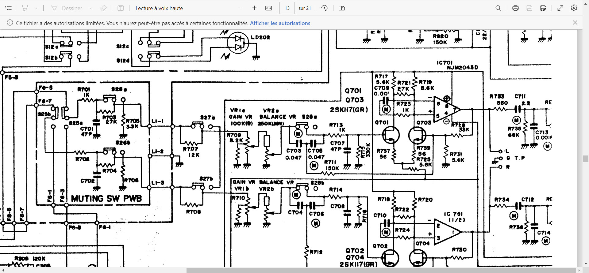

the nikko has a strange circuit with fets, i dont know. from now, all seperate units seems to have a bit of noise. i would tend to replace them all at some point. i replaced the njm2043d because it was dead, by lm4562 as well. the schematic is in two part, sorry on the far right R733-c711 goes to the cross over BIAMP thru rca cables.View attachment 1155370
The noise of this preamplifier is probably dominated by the thermal noise of its potmeters. Replacing the op-amp will not help, and it might make the circuit instable.
