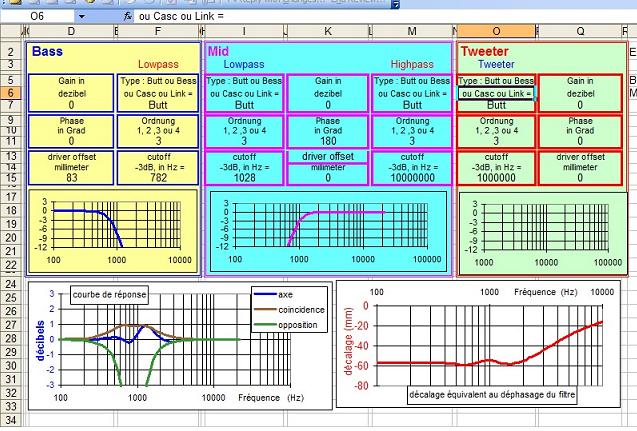

Has anybody experimented with a Le-Cleac 18dB crossover ?
Is the overall performance better than a "normal" 12 dB crossover ?
You can see the sim in the screenshot for 900Hz crossover ...
greets

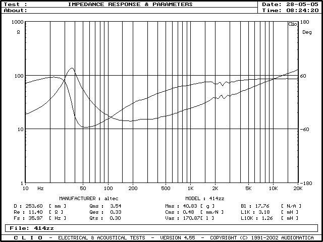

I'm using 3.9mH + 8.2uF for my 414z (16 Ohm) in 120lit BR. Xover point with HF driver is 1200Hz.

I have tried 3rd order slopes, and didn't care for the result, however it was not the Le Cleac'h type. I think using his horn flare would be really interesting, as Vuci has done.
Since your horn is not baffle mounted, you have the ability to position it where it will integrate best with the 414. If the horn were fixed, the phase of the two drivers might have to be matched through the crossover, possibly with additional circuitry. Feel free to scoot the horn back and forth until the sound focuses. Reversing polarity on the hf horn may help, although it's about a toss up, since either way the driver phase will be rotated ~180 degrees.
Your autoformer with 3dB steps would offer more control. Nice addition. The link was just a low cost alternative. Some of the wall-mounted L-Pad types have a similar transformer.
