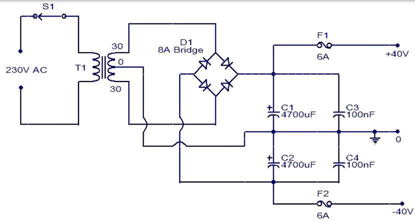

Ok thanks!
I want to clarify a bit more..
The Chipamp.com PSU board has places for four secondary wires and the schematic in the manual also has four leads coming from the trafo.
This is from the manual:
And also on this picture from the chipamp.com pages I can see four wires going in to the PSU:
Do I have to split the two blue ones in to four perhaps?

The PCB should be easy to rework by removing a bridge. You will have to cut a trace on the bridge that is remaining to isolate it from ground. Use a modelling knive to cut the print twice a few mm apart and lift the print away to get good isolation. Add a link from bridge to tranny and join the two 'grounds' and you should be fine.

One can convert a dual secondary transformer to a centre tapped transformer.
One cannot convert a centre tapped transformer to a dual secondary transformer. Unless you rewind the secondary. A difficult and time consuming job.
Since both types of transformer can become the centre tapped type, then the single bridge rectifier PSU shown in posts 4&5 can be used.
The dual secondary/dual rectifier/dual DC output style can ONLY be used with a dual secondary transformer.
With care one can convert the dual rectifier PCB to a single rectifier style. But one needs to work out the routes of the traces and work out which 4 diodes to delete and which trace to cut/join.

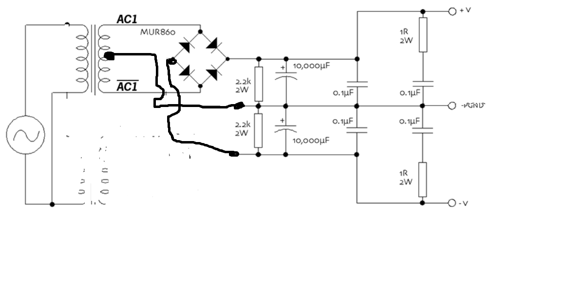

What is the purpose of the two 2.2K resistors
After the diode bridge
