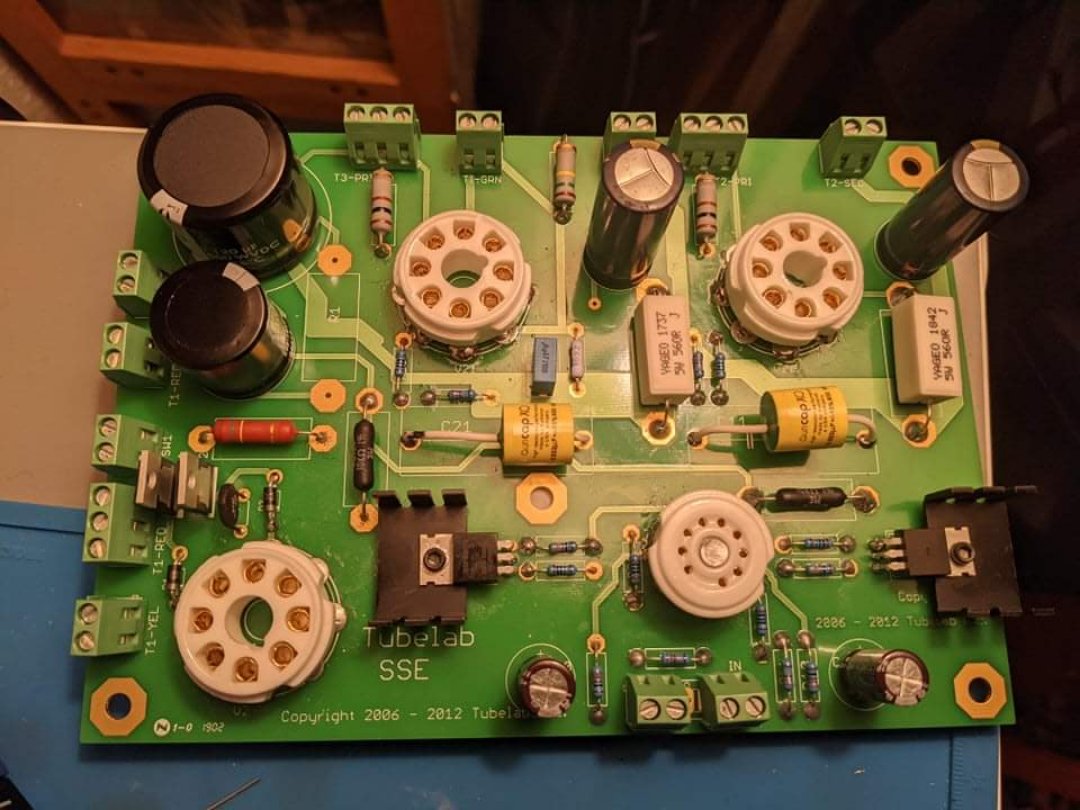

I have a little experience building diy audio kits but this SSE build will be my first time building a tube amp. I populated the board over the last week or so in my free time but I realized yesterday that I made a mistake.
I wanted to have the board underneath the chassis with the tubes on the opposite side facing up. Unfortunately I put all the components on the top side except for the tube sockets on the other side. Is there a reason why the tube sockets and resistors should be on the same side if doing a reverse layout. Also is it still possible to mount the board the way I have it with just the tube sockets on the opposite side facing up?
Here are some photos.

The tube sockets must be mounted on the correct side. This is because the pin layout for the tubes is not symmetric.
When the tube socket is mounted on the correct side, you will be able to look at the solder side and count the pins clockwise from pin #1 onward. The numbering starts clockwise after the gap or key. This means that your tube sockets
are mounted on the wrong side of the board. If you have some scrap pcbs, practice desoldering some components
before attempting to remove the sockets.
Components with only two leads could be mounted on either side of a board, if the correct leads are in the correct holes.
However there may be mechanical problems mounting components on the wrong side of the board, even if they will work electrically. So, always assemble a board as originally intended.
This SSE thread has some photos of the assembled board.

Ah okay that makes perfect sense, I should have thought about this beforehand. I'll desolder them soon, thankfully I have a larger solder desoldering pump.
Would it be best to just buy new tube sockets? I think I read it's very difficult to desolder them without damaging them.
I ended up just cutting the leads on the tube sockets and desoldering it that way. I tried doing it the other way but I used too much solder initially and it would have been too time consuming.
All of the sockets are now desoldered and there doesn't appear to be any damage to the board. I'm going to order some more tube sockets today.

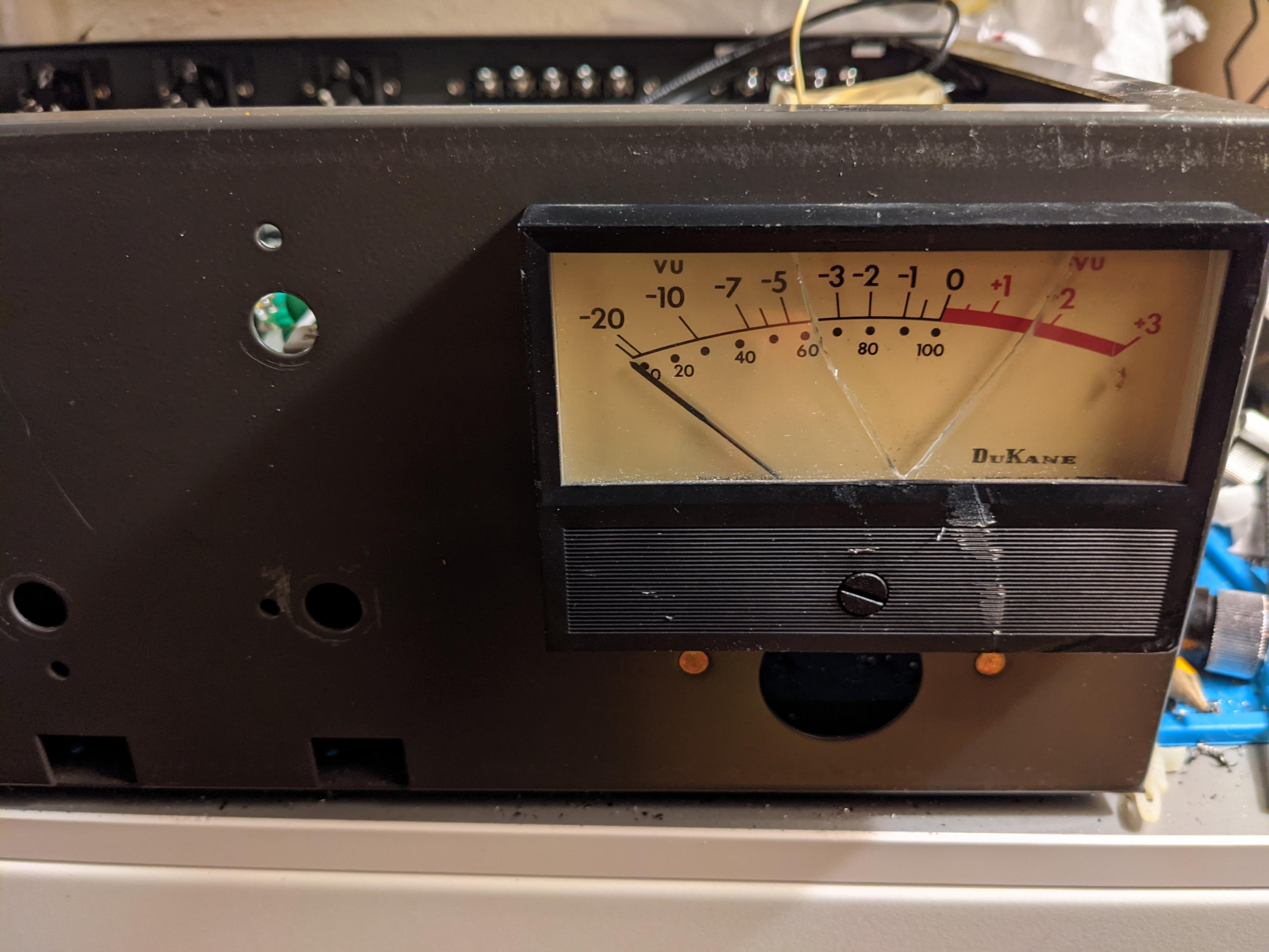

I found an old PA amp at a record store today for only 20 bucks. I decided to gut it to see if I can build the SSE inside of it. One interesting thing about the chassis is that it has a cut out for a vu meter. Is it possible to wire up a vu meter to use with the SSE? Any directions or insight on how to do this?

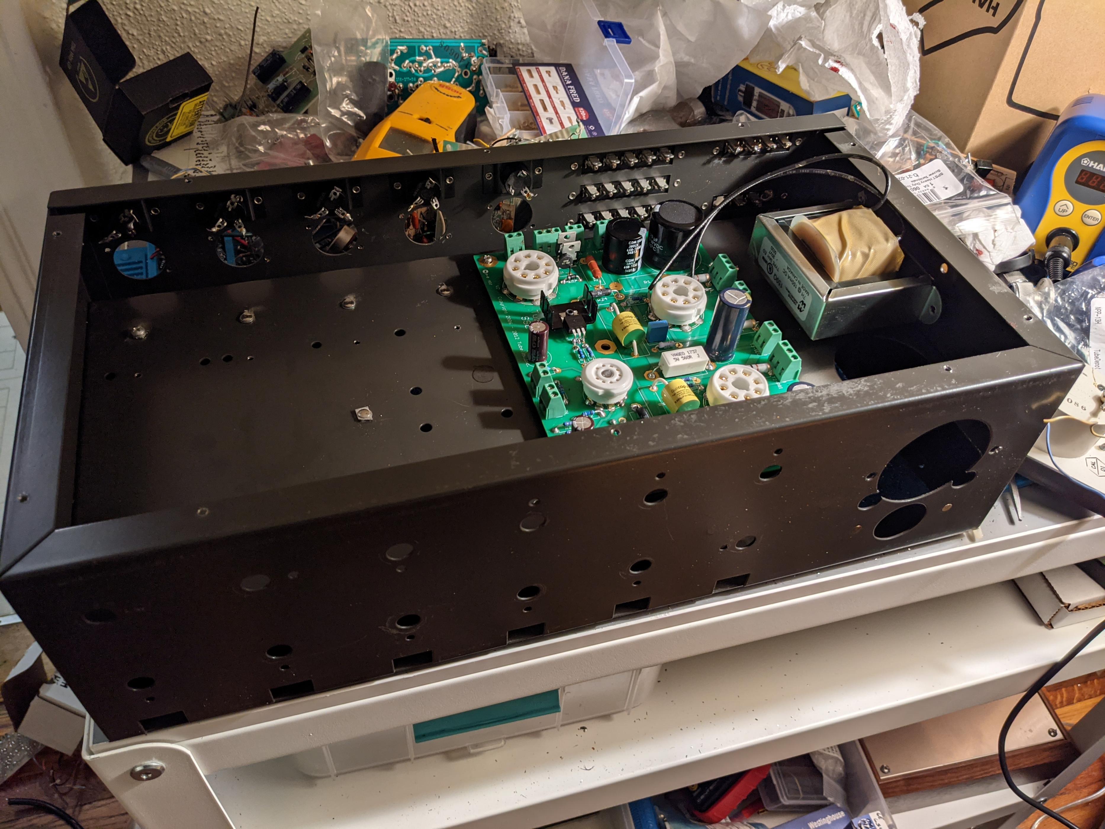

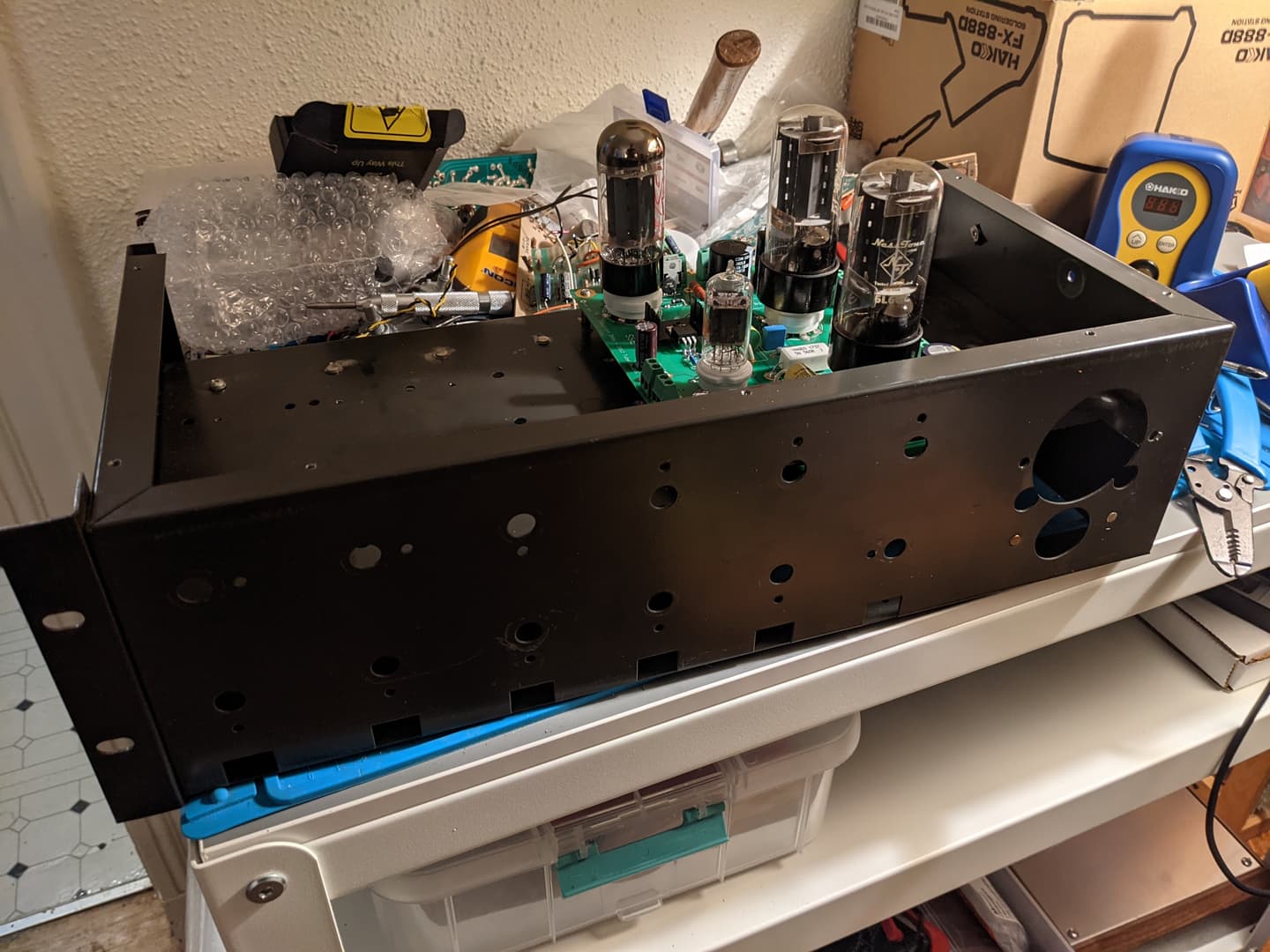

The main issue is that there's a center metal plate inside of it that separates the top from the bottom. I was thinking of mounting the board on top, with the choke and supplemental motor cap underneath. Then I'd leave the top off and maybe cut some perforated metal as a cover with holes for the tubes and to allow enough ventilation.
Does this look possible? Or should I scrap the idea and use a Hammond chassis I have instead?
If you go the root of a Hammond enclosure, then consider the weight of the transformers, and whether you will have a motor run cap (which is bulky and best tucked away underneath). It is well worth sketching out your top plate before you order so that you are certain you can shoe horn it all together, with space between the power tubes and the transformers..
Also, is it possible that you should try and have the tubes on one side of the board and the other components on the other, so you can have the tubes on display?
The presentation is the hardest part!
Thanks for the advice! I have a Hammond enclosure already that is fairly long but not very wide. I'll have to piece it all together when I get the transformers to figure out the best layout.
It's possible I'll still use the salvaged chassis, but I think it might be more work than it's worth. I'll try to decide once I get the transformers. I think the Hammond chassis would be easier.

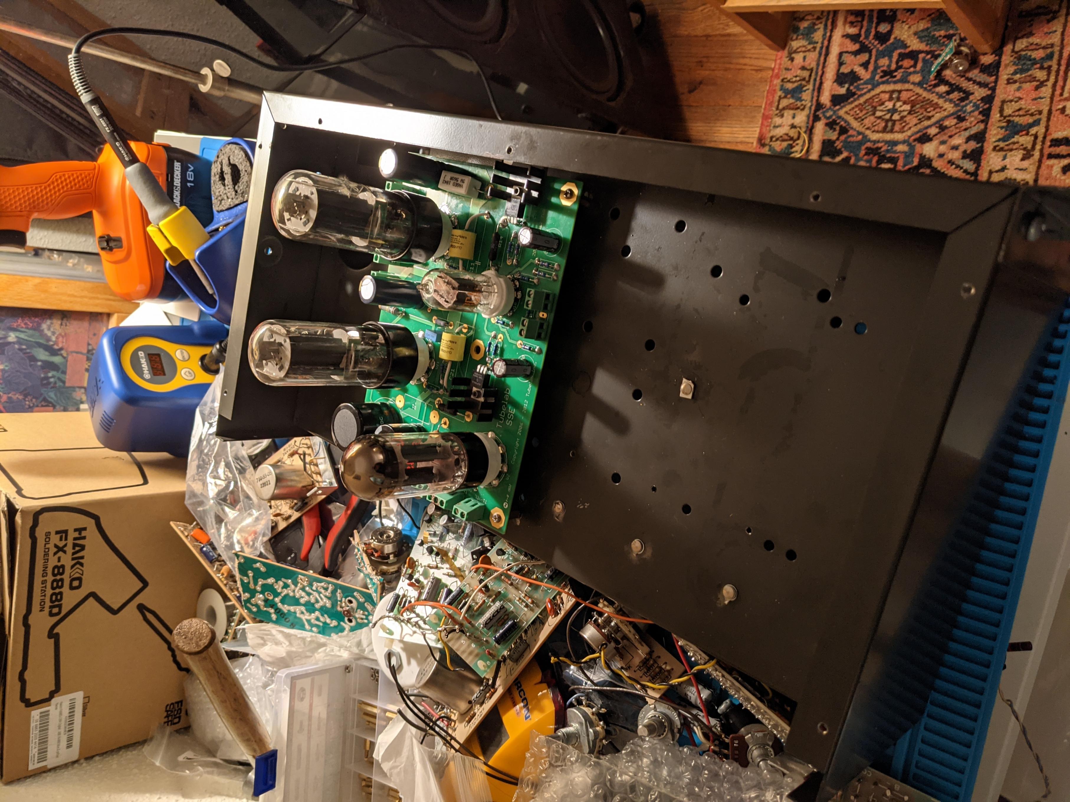

Another question I have is if I just unsolder and resolder the four large capacitors to the bottom, could I still mount the board underneath the plate. That would work, right?

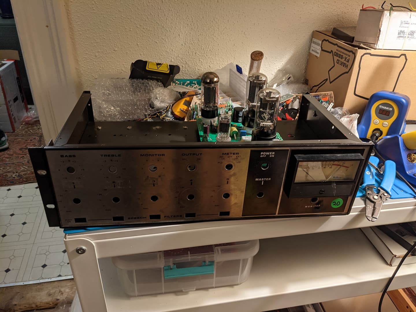

Got the amp up and running in a test set up a few days ago. Very stable, and sounds amazing! I set it up with the switches for UL and feedback and everything is working as it should. I can't really tell much of a difference with cascade feedback on or off but it's pretty apparent the differences between triode and UL.
When I have the time next weekend I'll start drilling the Hammond chassis and putting everything in it's final set up. It's been a.very interesting project to work on and I'm very happy with the sound.
