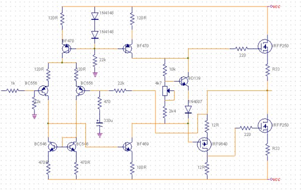

So, to get back to my amp, I did some more changes, putting a R at the Source of IRF9640, and now it seems to be totally stable. Attaching the schematic here and I will run 10kHz and take some pictures as amplifierguru wrote. I will also post pic of the amp

1) Put a capacitor between the collectors of the BF469 and 470, a few tens of nF quality foil will be great there.
2) If you have a smaller Pch MOS than the 9640, you may want to use it instead. Something like a 9610, say. It has a much lower capacitance than the 9640, why let your VAS drive a higher capacitance if you can avoid it?
3) You may want to change the Vbe multiplier with a Vgs multiplier to generate the bias voltage. The one you now have in yur diagram will overcompensate the bias current, especially with the extra diode in series with the emitter.

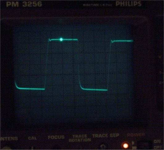

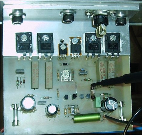

Thankas for your reply and suggestions ilimzn. I am not angry
..... It is good to se and discuss other constructions to solve problems. I did some changes to the amp as you can see on my last attached picture. When testing the amp seems to be stable at idle set to ~100mA. In my prototype I use doubble O/P (4 IRFP260).. I will put a cap between collectors of BF469/470 as suggested. And later post pictures of 10kHz sq wave.

4) Your VAS current is about 5-6mA, which is a bit too low for driving the relatively large gate capacitance of a IRFP250 and IRF9640. Look at suggestion 2) and also look into increasing the VAS current, I would go for double what you have as it is now, and perhaps even with the decreased capacitance resulting from the use of suggestion 2). You will need even more VAS current for multiple output devices!
I see two problems in your design:
You will have substantial rail losses, i.e. the output will not be able to swing very near the rail voltage, which means loss of potential output power and more heat on the output transistors. This in itself may not be a great concern, however, your design has unequal rail losses (much higher on the negative side), which means the amp will clip asymetrically.
The other problem is the overcompensating bias generator.
Here are some suggestions:
On the positive side, the driver can swing as high as one diode drop below the positive rail, assuming zero output current. Assuming say 40V rails and 8 ohm load, the total loss will then be that diode drop, plus VgsMOS + V on the 0R33 resistor. This will total about 7V or so. Vgs is the largest contributor, about 5V for the required output current. As the MOSFETs heat up, this will go down slightly as gm of the MOSFET increases.
On the negative side, things are, to my mind, not acceptable, two times (Vgs of the P250 + drop across the 0.33 ohm resistor) - two because the voltage bewteen P250 G and -V appears on both the 12 ohm resistors! Just this effect will be responsible for 10-11V of loss on the negative side. Net loss will be about double of that of the positive side. Using a smaller MOSFET from suggestion 2) above will not change this unless you use a MOS with a very high threshold (> Vgs of the 250 + voltage on 0R33).
Some suggestions:
You can make things better by increasing the bottom 12 ohm resistor and/or decreasing the top 12 ohm resistor. 100 for the bottom should be fine and will reduce the multiplying effect of the Vgs of the P250 plus voltage drop on 0R33. It will also decrease the amount of heat from the P-MOS. Watch the stability when lowering the 12 ohm in the source of the 9640, but better still, put a 100ohm damper resistor in series with the gate of the 9640!
Finally, you may be able to get better results if you use low threshold and higher gm MOSFETs as long as you keep gate capacitance low.
Alternatively, and perhaps obviously, use a PNP BJT. The latter, combined with careful choice of values for what are now the top and bottom 12 ohm resistors, can reduce the rai lloss to about the same as for the top rail, which is certainly a worthy goal. Keep in mind that if, what will then be, the emitter resistor of this BJT is reduced to very low values (removing it completely may be problematic for stability), this BJT will figure in the output stage's thermal stability, so the bias generator needs to be slightly different than for a pure VMOS design.
As for the bias generator:
A Vbe multiplier has a thermal gradient of 2mV/deg C times the multiplication factor of the Vbe. Since typical Vbe is 0.6V and typical threshold for MOSFETs is 2.5-3V, for two MOSFETs you need to generate bias voltage of about 5-6V. This means a multiplication factor of 8 to 10, so your thermal gradient becomes 16-20mV/deg C. VMOS typically has about 3mV/deg C gradient, so your 18-20 is grossly overcompensating even with no source resistors (the 0.33 ohm ones).
The 0.33 ohm resistors in your amp actually make the situation even worse as they lower the 3mV/C gradient even further. They also take away about 1.25V of clipping headroom, and reduce the already low gm of the MOSFETs. If you were using paralleled MOSFETs on the output, their use is mandatory, but for one pair, take them out.
That still leaves you with overcompensation due to Vbe multiplication being too big. You have two approaches you can use: either use a different sensing element, with lower thermal gradient or one that needs a lower multiplication factor, or reduce the multiplication.
The first approach is best done by using the same type element to sense temperature as the ones you are compensation - a MOSFET. The Vbe multiplier becomes a Vgs multiplier. The Rdg and Rgs will be approximately equal as the multiplication factor will be slightly less than 2. Since gm of a MOSFET is far lower than that of a BJT the capacitor from suggestion 1) above is mandatory or bias will be a function of the output voltage, which adds distortion. If the output stage uses a PNP BJT with a low value emitter resistor instead of the PMOS, you can use a 1N4007 in series with the drain of the Vgs multiplier MOS or even a small MOSFET with G and D connected together, in series with a diode, in series with a trim-pot, MOS needs to be on the heatsink, and the diode in thermal contact with the PNP BJT or at least close to it.
The second solution, which lowers the multiplication factor, and accomodates both a PMOS and PNP BJT output is a degenerated Vbe multiplier. Instead of the 1N4007 diode, put a small resistor, on the order of 10s of ohms. Start with a low value (10 ohms) and increase until you get good thermal tracking. The resistor will be about half for a PNP BJT used instead of a PMOS. The PMOS or PNP BJT would best be situated on the same heatsnk as the outputs in this case.

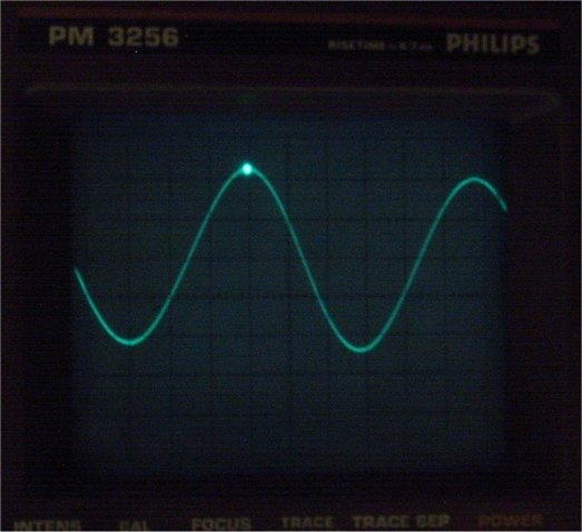

Bengt, ehat is the voltage scale on your scope pictures (V/cm)?
Also, what kind of load are you using?
Hi Bengt,
The pics are better just a shade dark. See the top corner of the rising wave and compare with the bottom corner of the falling wave (rounded). It could peak up approaching clipping.
First you need to change the R =120 on the input stage current source to, say, 680 to lower the input stage current (excessive) and increase the gain. Then re-do the 10Khz square wave and post. Sinewave looks OK. If it's 10KHz take it to clipping and post.
