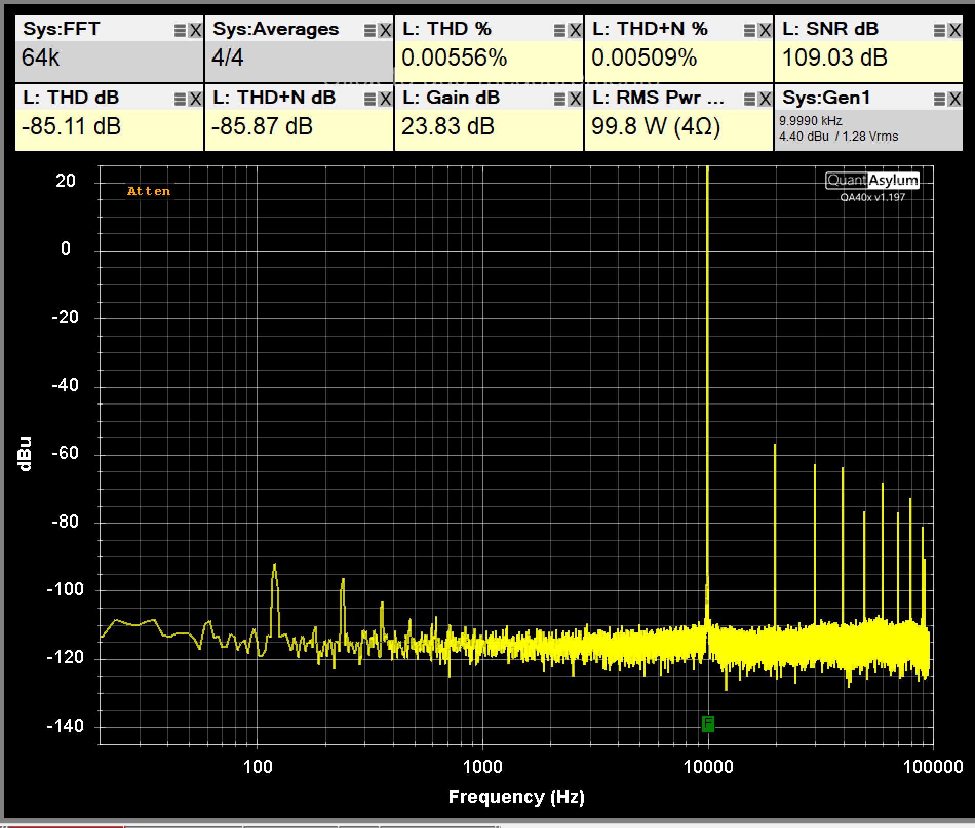

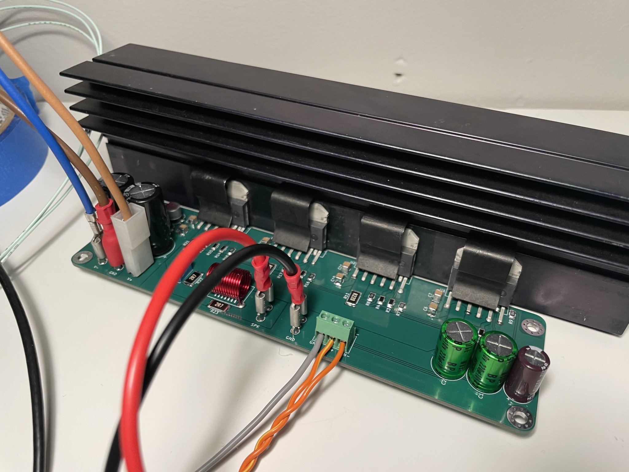

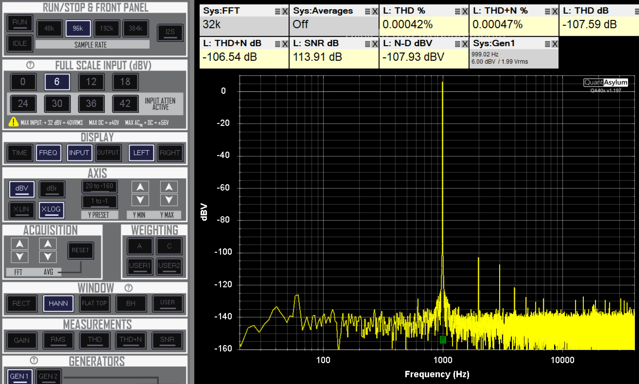

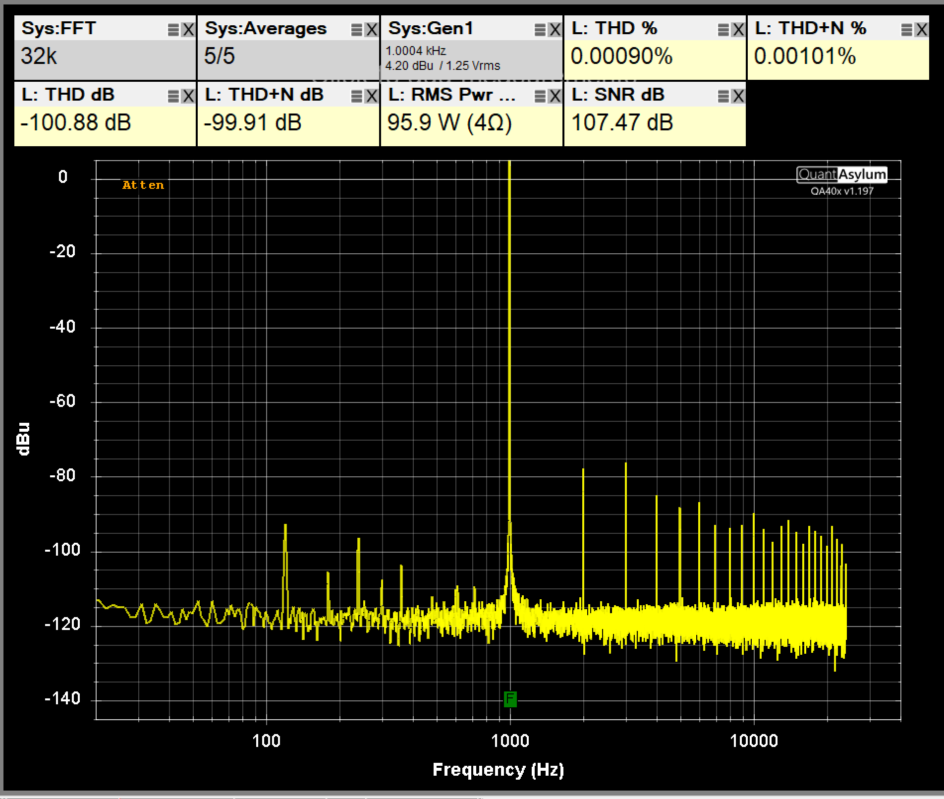

Another LM3886 in parallel attempt - this time 4 of them!
4R load results are good but not as good as 8R.
Even though THD+N is way better that of the datasheet, I am still far from achieving the level of performance of the Modulus line of amplifiers.
Note how 2nd harmonics is dominant in all of the measurements.
Looks like VAS stage is running out of juice (distorting) earlier then output devices.
By using four LM3886s output stage is equivalent to four pairs of output transistors or 2EF-4.
Seems reasonable.
That would not surprise me. The VAS probably runs out of headroom before the CCS that feeds it. The output devices are probably limited by how much power can be dissipated in them safely.

Amazing decrease of noise, what as the culprit?
In real it should be even less as you are only 7db to the limit of your measuring equipment given THD+N -110db.
On post 40 5w 1khz and post 41 are not same, what happened.
You have a Modulus-86, measure it with your equipment to be in relative.
With 90w the THD and THD+N should be very near, it is not the case as if your measuring equipment is injecting the noise.

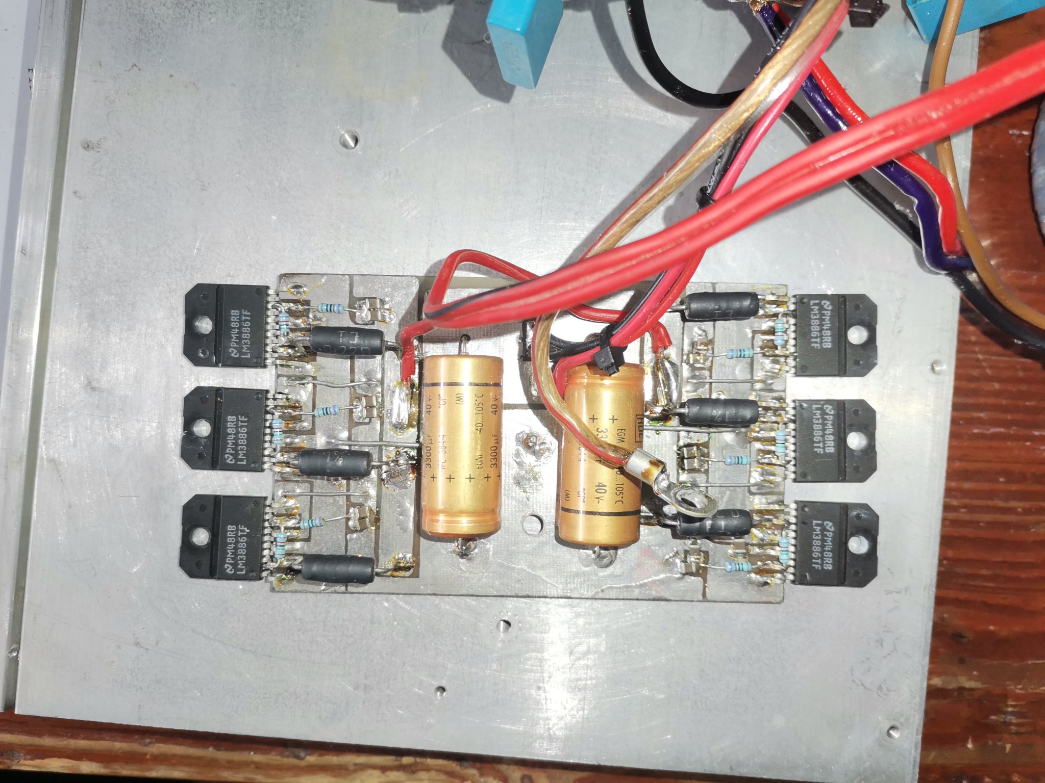

1. Load sharing resistors in my original are not 0.1 but 0R22 1% , sorry, I assamble this in 2005, that was long ago

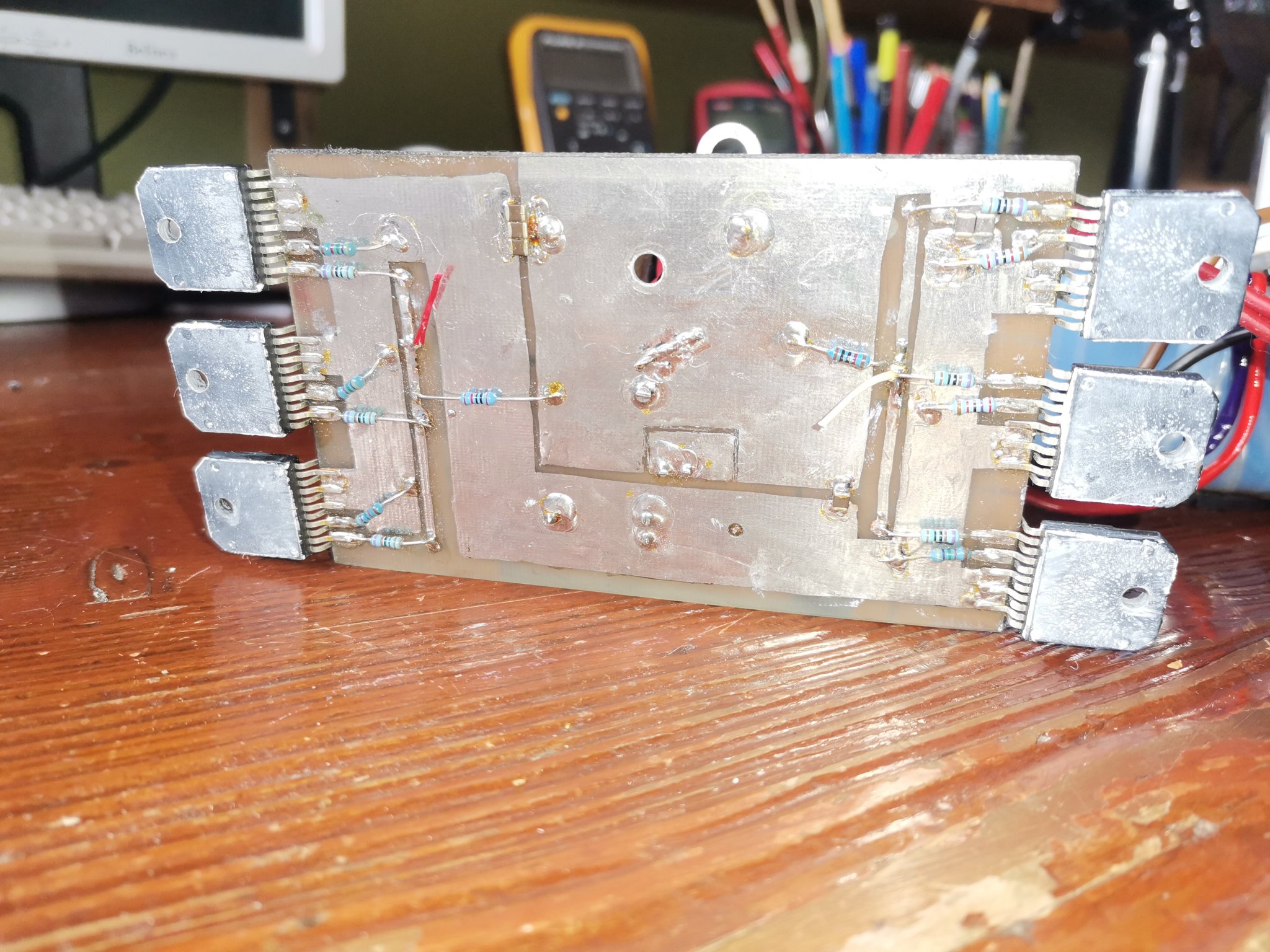

2. PCB s are not really professional and have many mistakes, see pictures below. But they are as they are, hope it will not affect measurements to be useless, let's see...
QA401 attenuation settings - reduced to 18dbv
agree
8R vs 4R
good idea thanks!
I tried using the lowest attenuation possible but had to stop at 24 as lowering it overloaded ADC.

The noise you are getting measured is wrong. With 5w 8ohm it says SNR 107db with 50w 8ohm it should measure 117db but it doesn't, it says 107db. By this, one can conclude that the noise remained constant although you attenuated by 10db and it is the noise of the ADC. To get right measurements, first see the noise measured without any input. Then apply the amp, with no signal and measured noise without any attenuation and subtract from the precedent to know exactly in uV your amp noise. Then you make the proportion SNR calculation by hand to add to that of THD to get the real THD+N.

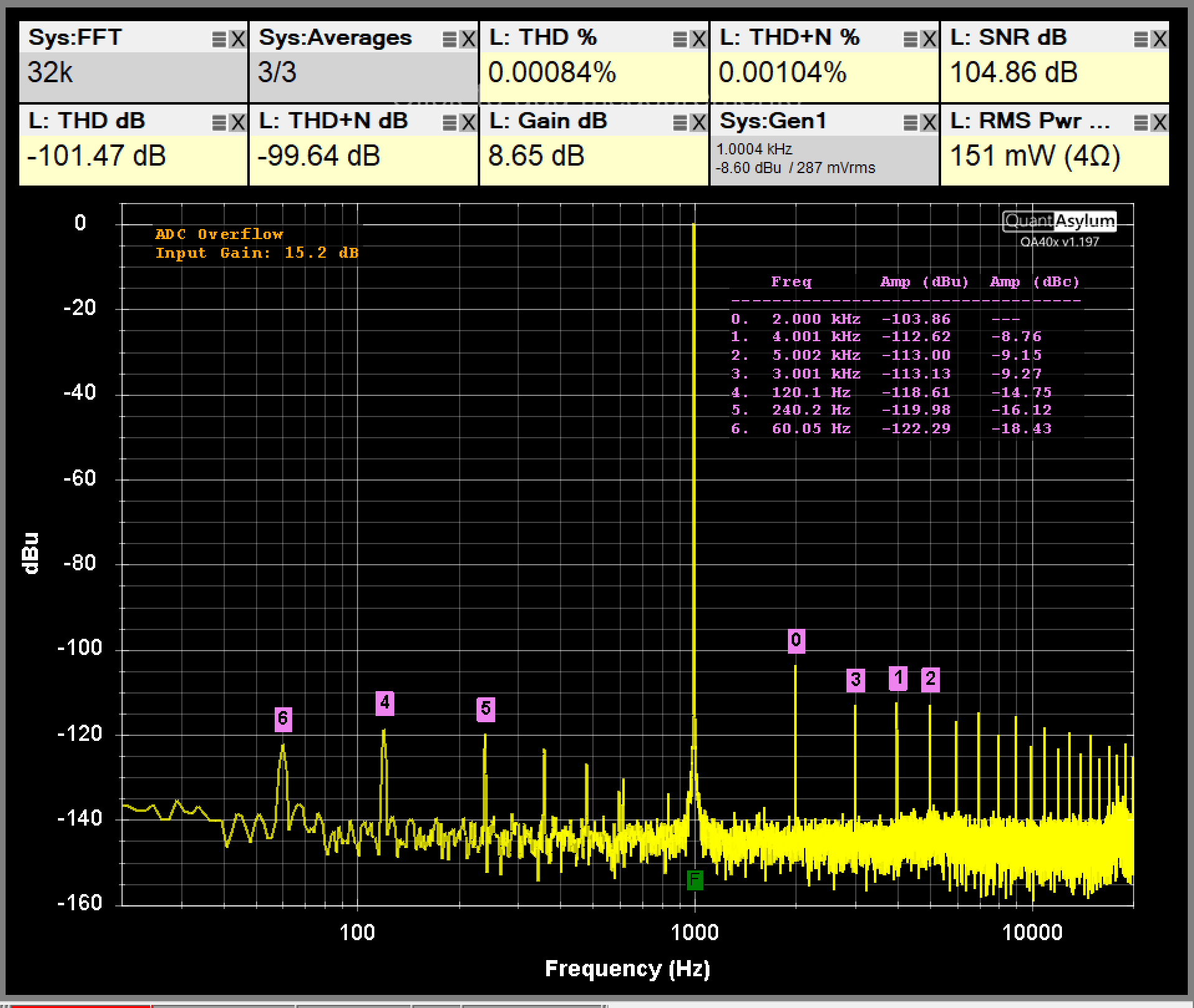

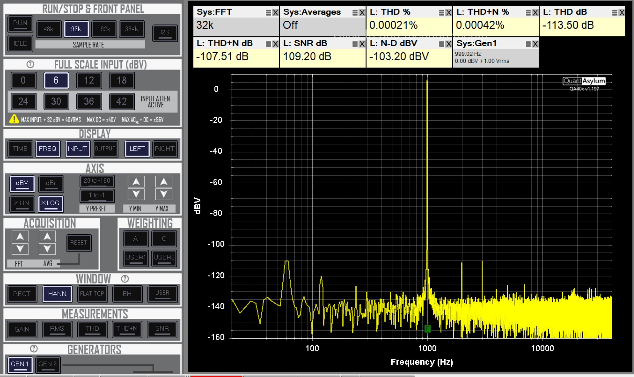

Still trying to get the hang of the audio interface.
Below are attached loopback measurements. It looks like noise floor for the generator is 110dB. Noise floor for the ADC is better at around 117dB.
If I set my generator to +6dBV and my ADC to attenuate to 6dBV I can get better SNR.

At 0dbv your are at maximum, above, the ADC is saturated. For that bring your fundamental at -6db to give half of the definition to measure the noise and harmonics.
Your software does measure the RMS value of total signal, find a way to limit it to 80khz, by sampling rate for example, as is measured on the DS. It is very important that first you get a precise value of the noise. Your 8bit scope can also measure the noise of the amp with no signal to counter check the result. Once you have the rms value, you just get the ratio in % with the fundamental rms value to add to the THD manually.

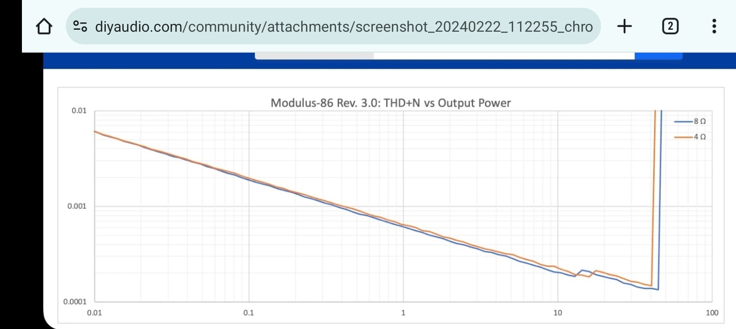

Bellow is the Modulus-86 THD+N, at 10mw 8ohm, which is mainly N, it is 5 times only lower than DS.
PS. I forgot about the generator noise 110db which is going to be amplified that also needs to be subtracted.
I will never understand why people are still so fixated on THD+N in a combined measurement. THD+N comes form the old days when THD was always sufficiently larger than N and measurement systems were limited to looking at the RMS output level of a notch filter. Spectrum analysis was way out of reach, back then.
Much better is to look at sets of THD spectra, stepped in level and frequency, and look at the noise separately. That tells you what's really going on.

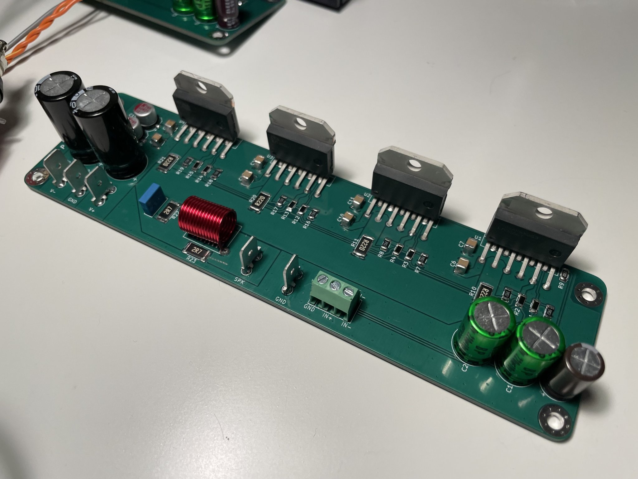

I am still amazed at the low distortion you achieved, e.g. -110 dB harmonics for 5 W / 8R / 1 kHz, and most recently -105 for 4R. That is nearly composite amp territory whereas the -90 dB you had before that for 5 W / 4 R is more what I would expect for a 3886 with carefully balanced impedances but no additional loop gain.
Yeah, LM3886 is amazing chip amp IC!
By paralleling four ICs I was able to minimize lagre signal nonlinearity caused by output transistors pumping too much current.
In other words by splitting current between four ICs I was able to eliminate the biggest contributor of the distortion.
In fact, now it is a VAS that is a limitation. You can see it by the harmonic spectrum of the FFT - look at the second harmonic - it is the largest at -103 dB (4R 5W graph).

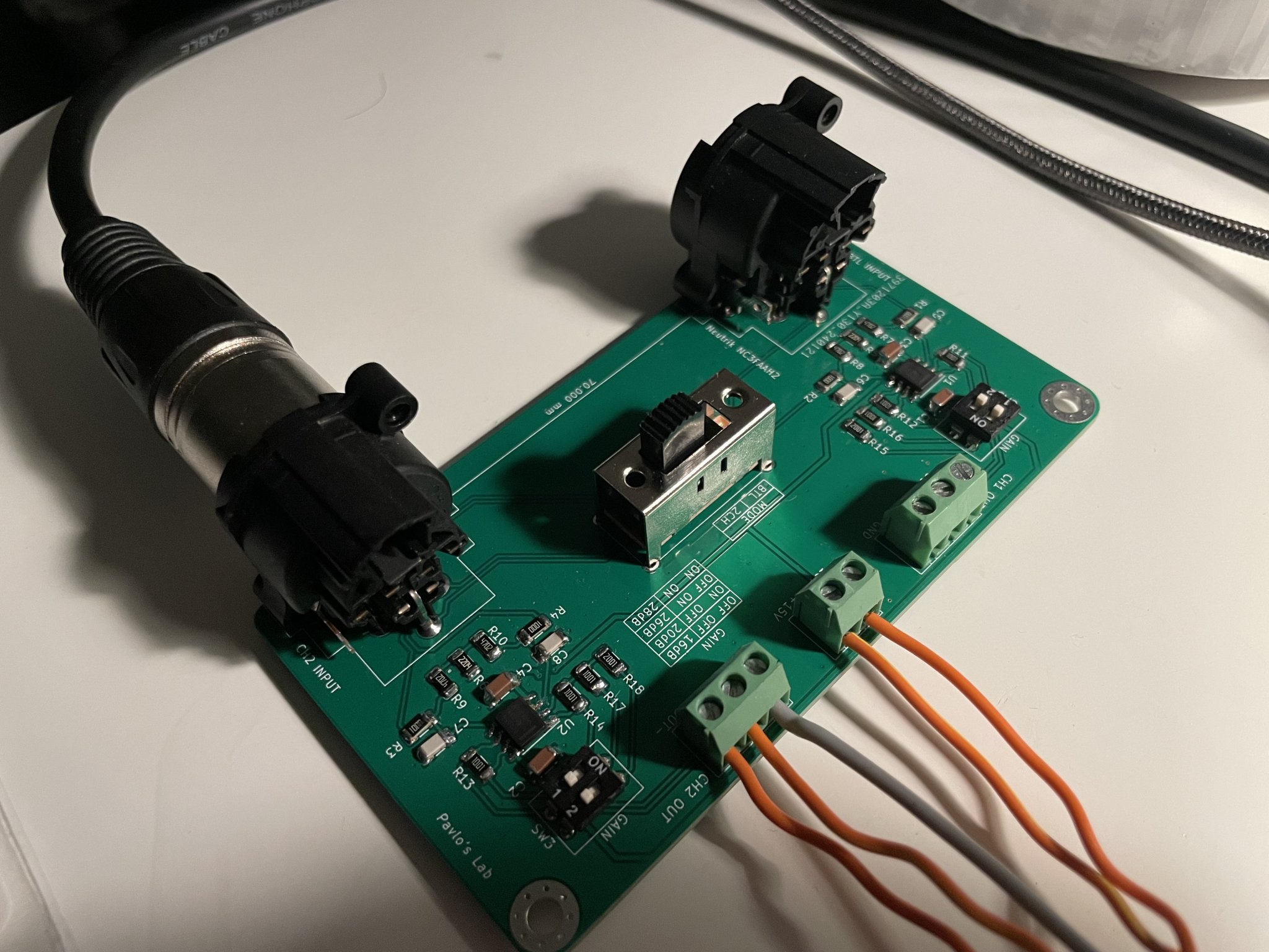

I have decided to split design into two PCBs - one is the input buffer for balanced signal, and the second is the power board with four LM3886s. Input buffer has three settings for gain and 2CH to BTL mode switch.
