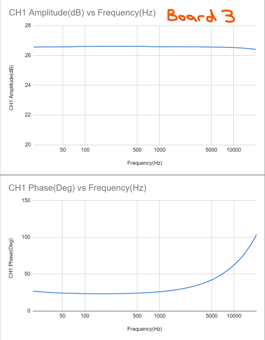

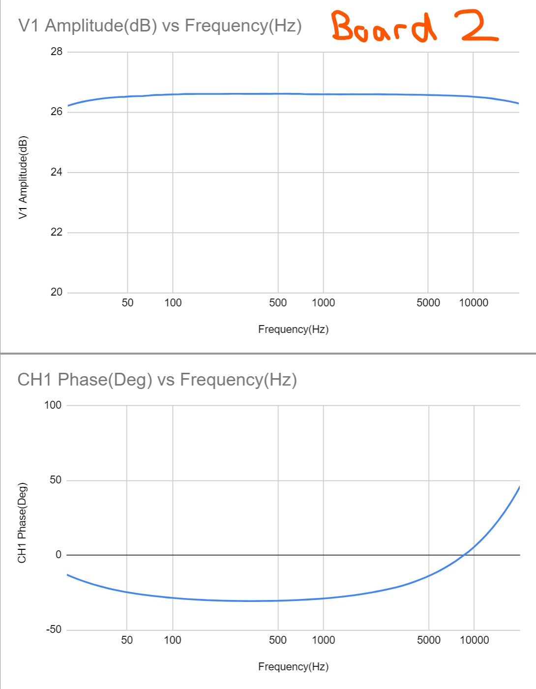

A similar question if I may: can someone in the know interpret the phase plots on these two Bode plots? I managed to get a solution working where my SDS1104XE scope can talk to my cheap Chinese signal generator (KKMoon FY6900) via my PC, so now I can run a proper Bode plot to ascertain the frequency response of the amp.
Board 2 is the second of the two original boards I built according to the schematic in the earlier post.
Board 3 is a new board which has different components, mainly to flatten the response which was lacking a little bass-wise previously, and to sort out the horrible ringing seen earlier (more on that in a later post).
The frequency response on board 3 looks good, and in line with what I simulated, however I'm not sure how to interpret the phase graphs. Given a near identical gain of around 26dB, board 2 has a negative phase until 8.3kHz, when it crosses 0 degrees, whereas board 3 has an entirely positive phase.
What would be the ideal phase plot for an amp like this?
Thanks, Christian

Actually it suddenly occurred to me that the differences in phase are down to how I've set up my hardware - I'm using both channels of my signal generator to generate the plot - channel 1 goes to the amp, and channel 2 directly to the scope. If the two channels aren't in sync then the two waveforms being compared will be out of phase, and that's almost certainly what's going on here. Looks like I need a BNC splitter to get a more accurate plot. That's a trap for young players!
