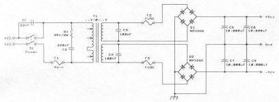

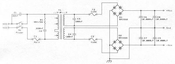

Left channel is working, right not.I hear hum from both.Transformer have 2×42V secondaries per channel which give about +- 61 V (where is voltage drop from two bridges???)
Hope this helps!
My power supply:
I matched only one channel but there is no significant difference 600 mV or 700 mV (unmatched). When I tested the circuit boards with osciloscope there was nice, phase correct sin signal, but my bench supply goes only up to+-30V.
I am thinking that maybe something is wrong with power supply, because I get some hum (not loud) in the 50Hz bass region.(maybe superimposed mains noise).
Hope this helps!
My power supply:
If your RMS voltage from the wall is about 122V and the transformer has 115V primaires. Your output DC voltage will be slightly above 61V with the diode drops. As for the offset problem, see what the offset voltage is with a load on the output. If there is no load connected, there is sometimes a larger DC offset measured because the source impedance of the amp is small compared to the huge impedance of the test equipment. When a load is present, the offset should be nearly zero.

Actually I got 230V mains and transformer got 2×42V without load.
If I connect speaker to amplifier then offset is about -0.420V on positive terminal.

1)You should check the zener diodes in the differential input stage,Make sure the negative and positive sets are matched,It`s much more important to match the zeners then the transistors.
2)as far as noise you should tap the power supply ground dead center between the main supply caps.
