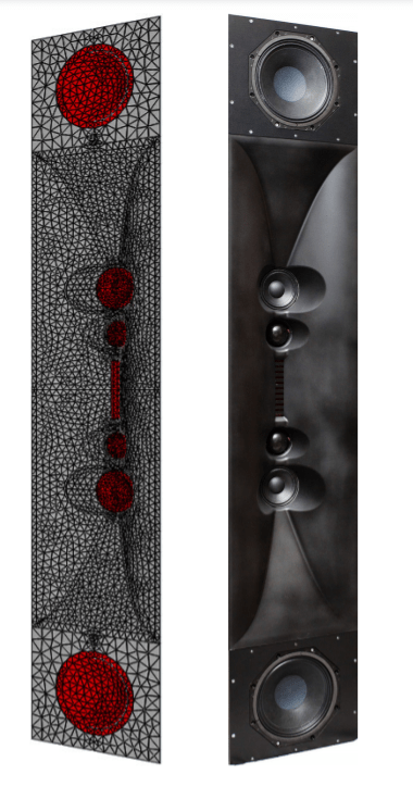

I wonder if am understanding your point, can you expand a bit on how you see a dome midrange driver fitting in with wide horizontal and narrow vertical response?What I believed to be the point of Patrick’s discussion here is line source or hybrids as opposed to line array…..eliminating early floor and ceiling reflections through vertical cancellations while still maintaining an ideal horizontal response for most listening environments that have reflection points within the horizontal range of directivity.…….and dome midrange drivers that isolate the critical listening range of 800hz to 4khz do just that……I would add do it better than anything in a typical listening environment, translating the music and its artistic intention from the mix and mastering desk.
90% of the clarity and imaging cues we enjoy so much from music is centered within the telephone pass band, so ANY and ALL phase anomalies are a smear to those spacial cues in a stereo triangle…..it’s so easily apparent when mixing with a set of speakers who’s crossovers are involved WHEN making panning decisions of instruments in a multi track recording and the more tracks, the worse the situation becomes.Hi mayhem13, are you saying there is suckout with center panned material? or something else? just trying to get into whats the problem.
Simple….an MTM alignment……exactly what Patrick has proposed from a hybrid/line source…….adequate power handling and a close center to center spacing………but not every room benefits from narrow directivity across all frequencies…..some rooms are move lively and dynamic with a bit of floor or ceiling bounce. Again……it’s always mostly about the room when making the right choice in a speaker or design.. My tapered 6” thick suspended clouds often give the acoustic impression of an open space………..vertical directivity is NOT a desired design criteria for me.I wonder if am understanding your point, can you expand a bit on how you see a dome midrange driver fitting in with wide horizontal and narrow vertical response?
That makes more sense, The Aries M from Follgott is quite close to this although the dome mids are used at 700 to 1.8K as a narrow vertical pattern was part of the design intent.Simple….an MTM alignment……exactly what Patrick has proposed from a hybrid/line source…….adequate power handling and a close center to center spacing………

I still remain confused as to Patrick's intended vertical directivity pattern, that pattern sets what can be used as a centre tweeter or central elements in a shaded array.

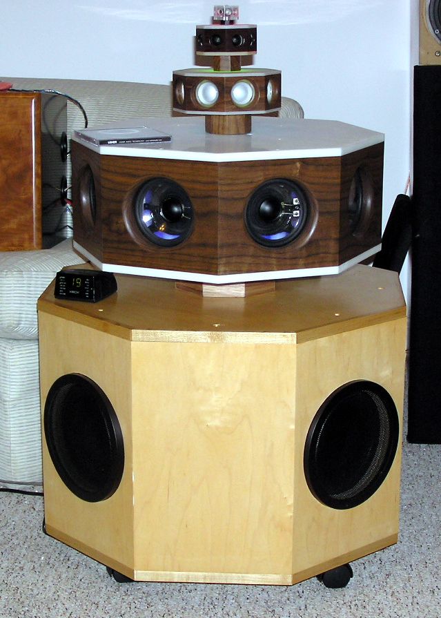

Hey Neil, glad to see a post from you!Something else you might want to consider is a "ring array".
View attachment 1093859.
I've had these in our bedroom closet for over 5 years, awaiting new electronics. I was using a 6-channel XBox Spherex amp with the DSP inside the Apogee chips for the crossover. However, in order to re-do it better, I need 10 channels with DSP for each side, and I keep putting off that design. But maybe this winter...
Come over to the dark side and try computer based DSP under Linux. You can get 10 channels of analog balanced outputs on a Behringer UMC1820, or for better performance, a MOTU Ultralite mk5. Drop me a line if you are interested.

The Linux approach can be a good solution for many active speakers, but I don't see it as a good solution for the line arrays that I am most interested in. The challenge I have with the line array is that I need many channels of amplification to implement electronic curvature. I think the best way to do that is to use lots of small class D amps for the midrange and tweeter arrays, plus an extra amp for the woofer. The prototype line array I made had 20 small power amps for each side, but next I want a more modular design where I can easily scale up or down by plugging 4-channel amp modules into a motherboard. That approach is best done with custom boards, and once you're in that even darker territory, it makes sense to use a DSP module vs computer DSP.Hey Neil, glad to see a post from you!
You have always been into "rolling your own"! But you could buy hardware and be up and running in a couple of hours. Just need to add amplification to suit, and as you say small class-D amps would make sense are are cheap to buy. Make changes anytime. That would probably be more expedient and get you to the finish line faster than "DSP modules" that you DIY yourself. And if you don't like how it performs you can turn around and sell the gear.The Linux approach can be a good solution for many active speakers, but I don't see it as a good solution for the line arrays that I am most interested in. The challenge I have with the line array is that I need many channels of amplification to implement electronic curvature. I think the best way to do that is to use lots of small class D amps for the midrange and tweeter arrays, plus an extra amp for the woofer. The prototype line array I made had 20 small power amps for each side, but next I want a more modular design where I can easily scale up or down by plugging 4-channel amp modules into a motherboard. That approach is best done with custom boards, and once you're in that even darker territory, it makes sense to use a DSP module vs computer DSP.
Another option you might consider, although a bit old school, is to pick up a used Crestron CNAMPX-16x60. Great quality amp. 16 channels each with 60W@8R, 90W@4R.
