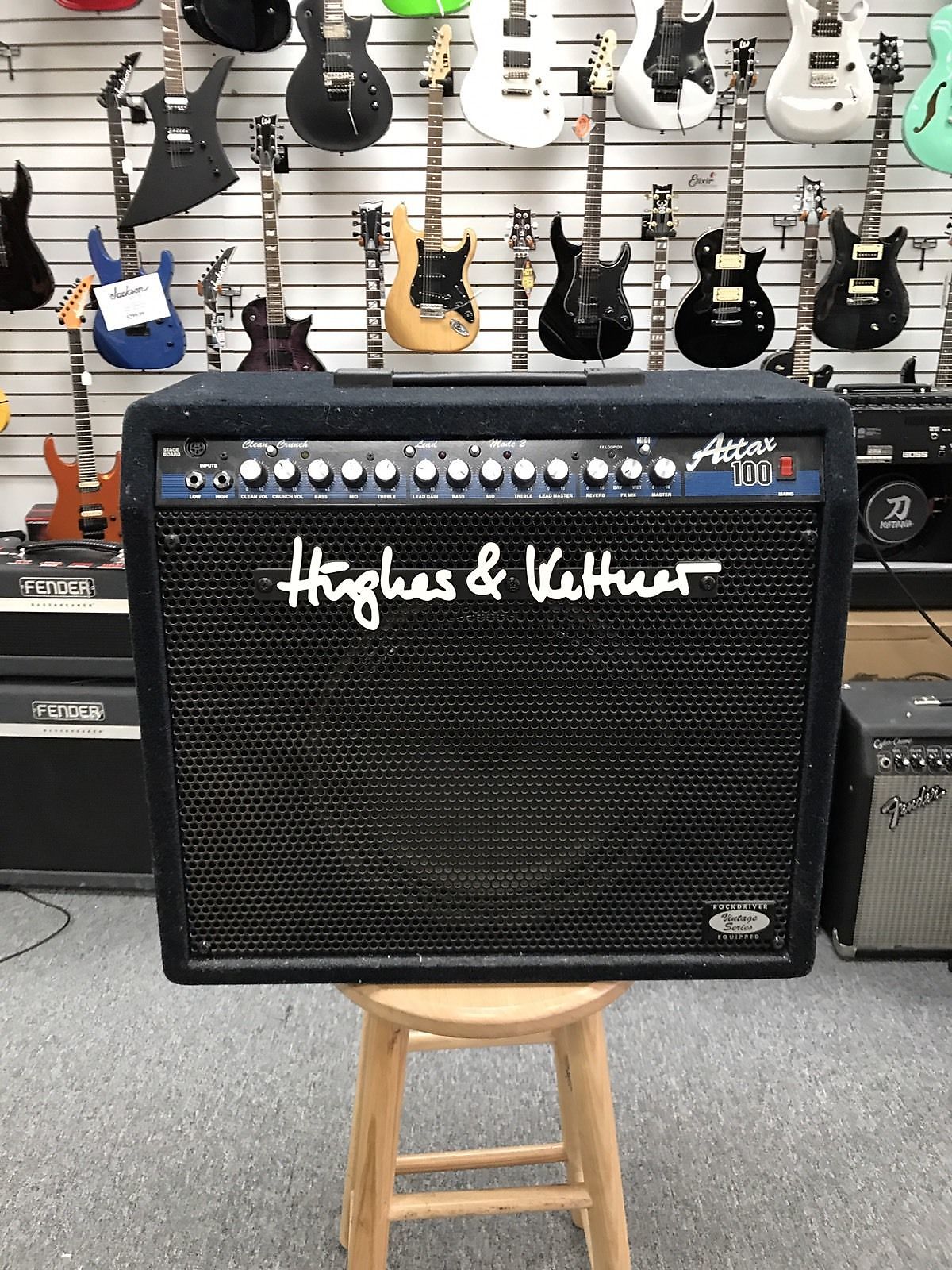

Hello everyone
I'm currently trying to revive this amp but no success yet.
I have a Hughes & Kettner Attax 100 combo with no sound(kinda).
The power amp seems to be working fine. If I connect something to the FX Return, it plays nice.
All the switches LEDs are lightening fine, the spring reverb also works fine. (Oddly, this amp has the reverb after the FX return).
The 12ax7(ecc83) valve doesn't seem to warm, neither light up. But I have something close to 7/7.5v in the heater pins.
What makes me afraid is that I'm having HIGH voltages on the plate pins. Where it should be 270v according to the schematics, I'm measuring 440~480v.
If anyone have a clue, I'd really appreciate 🙂
I'll be uploading photos and the schematics here.
Thanks!

[SOLVED]
Found the problem.
Just needed to solder again one point of the heater signal path that was not on contact anymore.
This amplifier have a terrible flat cable between boards which causes troubles through the time.
I also changed it for a new and more flexible cable ribbon, so it should give the amp a better life span now.
