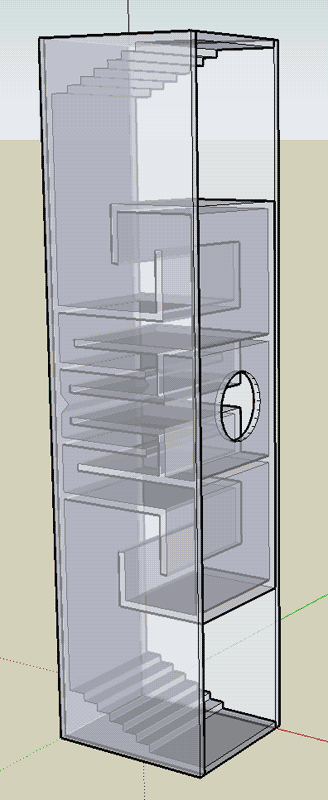

How does this differ from an end-loaded mass loaded transmission line? It is kinda long and inefficiently folded. They put an image of the fold for their commercial 4-way (i assume), and it seems the designer had as a design goal … as convoluted a foling as i can practically do.

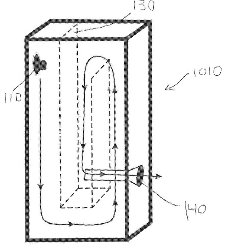

If I built that but had the port out the bottom would I be infringing on their patent?

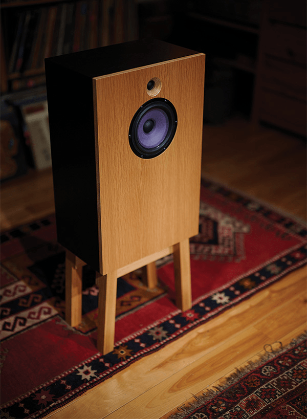

Add a $1000 usd pr stands like this:
Devore O/Baby
https://www.stereophile.com/content/devore-fidelity-orangutan-obaby-loudspeaker
"The stands are handmade, with no fasteners, also from white oak to match the baffle."
Gee how much $$$ More for some screws. Thank You for saving the customer some money. How generous.
Devore O/Baby
Each bend is a LP filter, not a huge one but they help. Scott has been taking advantage for at least a decade & a half.
And here a basic end-loadedML-TL from 2009: https://www.diyaudio.com/community/threads/microtower-bipolar-ml-tl-for-chr-70-or-el70.148901/
As well one has to consider that many/most “tower” loudspeakers are ML-TL. You used to hear a lot of “you need to measure them and adjust the vent” Alwaya a little lower. The guys modeling as QW boxes have software that accuratly predicta ethe terminus action — whereas a BR modeler will be inaccurate.

What if I put one port out the back and one port out the bottom (2 ports) ? Plus 2 ports on the sides = 4 ports?
Figures 1,2,3,4 only show 1 port.

The claims have little to do with the folding pattern or port location as I read it. The drawings and body of the patent can be more about exclusionary disclosure, instead of describing what you are doing or claiming. Or sometimes they are the leftover start of a patent that gets narrowed down and pushed into a very small corner to get granted.
https://patents.justia.com/patent/11917361
I assume these are the key phrases from claim 1: "the method comprising simultaneously tuning a transmission line" . . . "wherein the transmission line is tuned to a frequency of the tuned port."
The rest of claim 1 seems very generic, so without the specific qualifiers, there doesn't seem to be much there.
Other permutations also claimed.
No idea how claim 7 made it in there as is.
Whether any of it provides the benefits described or if this is a unique configuration, I can't say.

In terms of loading, it doesn't -it's just a folded MLTL with a vent offset, as has been used (when desired) since Olson's original of the '40s. It just happens to be folded. Like plenty of others have been. So scores nil for originality.View attachment 1319139

For individual use, not AFAIK. I haven't yet ploughed through the text, but based on the image & some of the quotes above that patent could be challenged in any case as it does not appear to show originality (which is all that matters with a patent), and 'prior art' for a common load scheme should come into effect. If not, somebody could claim pretty much any existing item as fair game for a patent.If I built that but had the port out the bottom would I be infringing on their patent?
The way it is drawn makes it easy to think the vent is offset, but it goes thru to the inner boit and is at the other end from the driver.
dave
More or less. There's a modest offset, mostly provided by its own thickness, or in the case of the unfolded type, the length of the duct itself. Since there doesn't seem to be much direct reference to it (if any) in the text, I assume that the applicant / holder is either avoiding mentioning it, or isn't actually aware. Having read the full thing over -all I can say is that it's so riddled with factual errors or peculiar / partial statements it would take me a couple of hours to go through it point by point. What I can say, with my moderate designer's hat on, is that either a/ the holder is broadly describing an end loaded MLTL, which falls under 8 decades worth of prior art & therefore means they haven't a leg to stand on, or b/ they are applying fuzzy terminology & descriptions with the intent of finding some narrow applicability, but mostly for marketing value for a commercial product / products.
