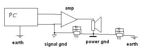

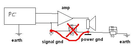

classd4sure said:I think your signal ground and power ground should be a direct connection with as short a loop as bla bla bla...
No "lifts" there at all.
darkfenriz said:Chris, you mean as simple as:
Absolutely agree. Any lift is an error introduced.

Guys
beer for you!
The connection that Chris has suggested works for me well with no hum and no distortion. Same as disconnecting earth from amp, but more elegant of course.
Thanks for all your input
Adam
beer for you!
Adam
darkfenriz said:Guys
beer for you!
Adam
