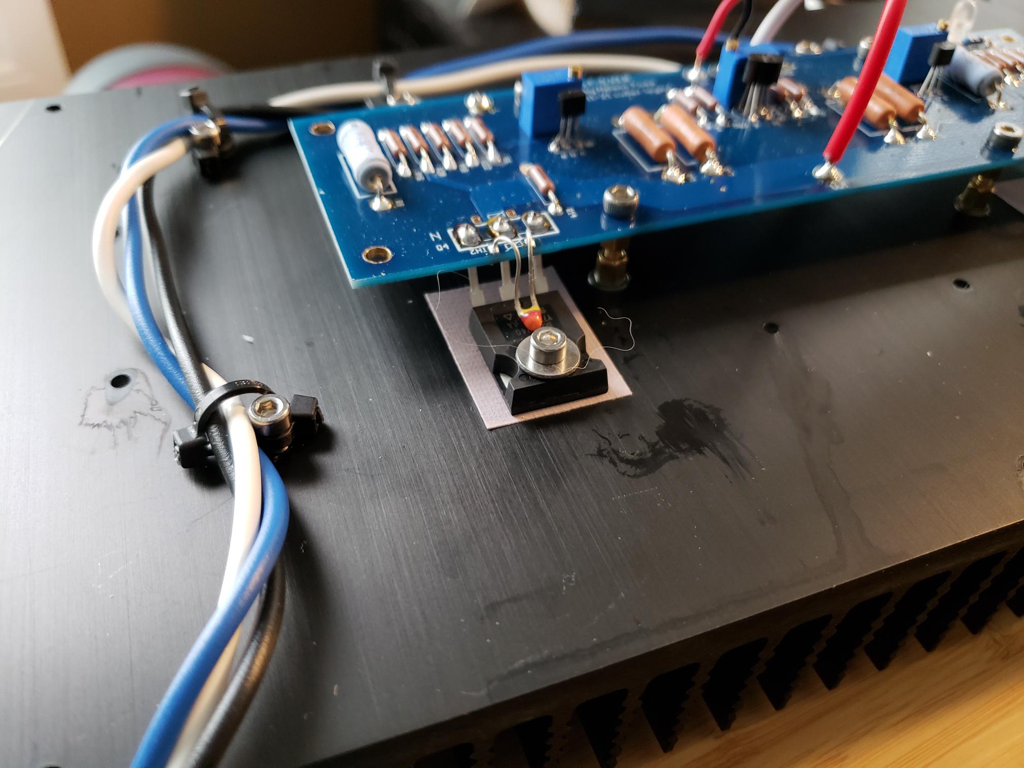

Heck - Sometimes I need to read Zen's stuff a few times to figure out his Wile E. Coyote (genius) shorthand. 😀
The little thermistors touching the black part of the Mosfet instead of the washer is a belt & suspenders thing - if (somehow) the paint on the end of the NTC becomes worn through and touching the metal, it may ground out, but if touching the plastic, no worries.
Those thermistors, by the way, are there to adjust the Current through the Mosfet (Iq) as the amp warms up.
The only thing I see that could be problematic is those ,47R 3W resistors. Usually you don't want those tight to the board because they get fairly warm and having some longer leads and big bends makes it easier to clip probes to.
I do recall reading something about that somewhere but it slipped my mind which ones they were referring to while putting it together. I've had quite a few pics open along with several different threads (plus the build guide pdf) and it gets a tad confusing keeping it straight sometimes.
Thanks for pointing it out so that any others doing their build and perhaps looking here might learn that.

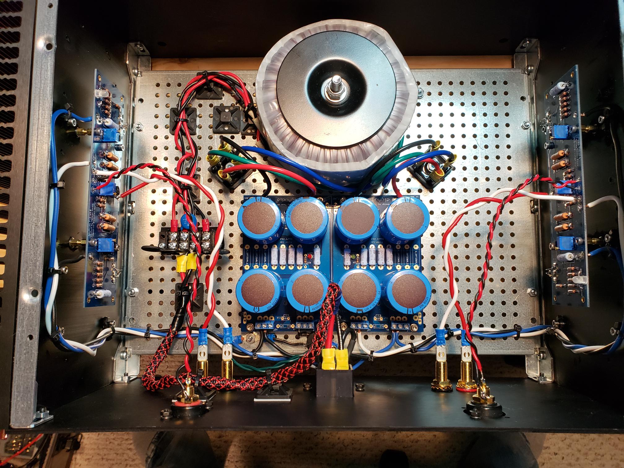

Well, finished pretty much. I have a set of feet coming but other than that, she's all soldered up and all I have left is to do the biasing tomorrow. I haven't plugged it in yet mind you since testing the PSU.
Thanks to ZM for some final pointers and everyone else that chimed in!
Looking good. I guess you're ready for powering up.
Just a reminder to set P1 and P2 to min value so that the resistance
measured across R5 and R6 are low, to ensure low bias at your initial start up.
Dennis
And disconnect one amp channel on initial power-up so if you have a symmetrical fatal error you don't kill both sides.
Symmetrical Fatal Error. Sounds like a death metal song. I may use it. Not that we play death metal....

Here's a not so minor quibble: I'm at the stage where I would like to Bias my amps. Now after following many of the different threads and the build guide, I have it all wonderfully put together and I come to this:
"1. Turn all variable resistors, P1 and P2 (total of four variable resistors for a stereo
setup) fully counter-clockwise. This can be verified by measuring the resistance
between the outer leads of the variable resistors and it must read zero Ohms."
Really?? I have the boards mounted with the wires all neatly tie wrapped and each of the screws including the ones holding the mosfets threadlocked.... how might one even get at the leads?
