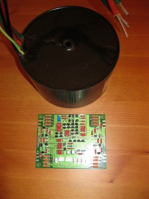

custom made by Tauscher

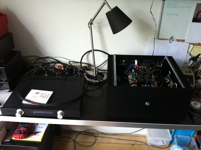

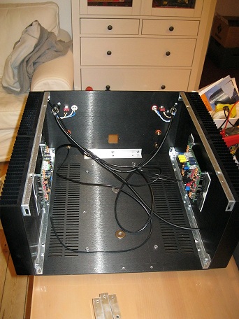

With four 1R emitter resistors at each output device, quiescent current is ~2.6A
With some voltage sag from the 650VA's (5.2A total bias current per rail), dissipation is at some 240W.
With heatsinks at 70C and silicon insulators, output device die temperature will be ~125C !
125C die temperature is a real serious problem, see A1216/C2922 datasheet graphs.
You might want to exchange the silicon sheet under the Sankens for Keratherm red foil, easy to order at Conrad.
The insulator swap will lower output device die temperature by ~15C minimum.
An easy way to drop heatsink and die temperature would be to take out one of the emitter resistors, which lowers bias current and dissipation by 25%.
Reducing bias level is not the best option though, lowering rail voltage is preferable (read Sander's lines about AB crossing and the local output stage compensation ), you likely have to do both.

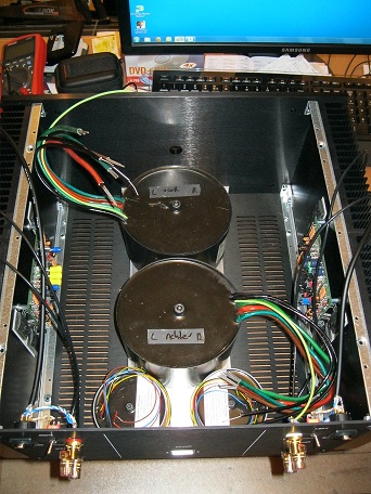

As your Tauscher toroidals are potted, unwinding their secondaries is out.

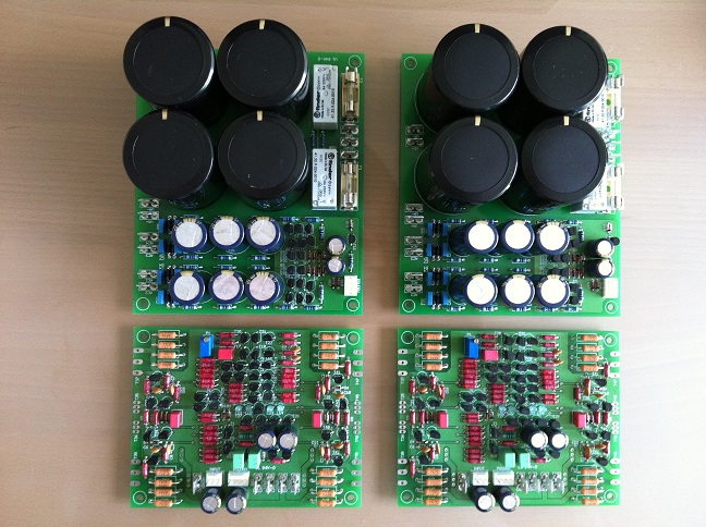

What you could do is set up a CRC/CLC between the transformer and the rails, easiest would be to add another 33.000uF electrolytic per rail after the bridge rectifier, as input cap for a C-R-CC/C-L-CC, plenty unused space left in the case.
Thing to keep in mind is that efficiency of your heatsink arrangement goes down considerably if you drastically lower their temperature.
For the Modushop 5U heatsinks to be at 55C (for 25C ambient), it likely takes dropping the quiescent current level by a full 1A to 1.6A !
(my Bruno monaurals have high performance heatsinks, about 8kg the piece, with two 120mmx120mm fans on each, running in stealth mode. Barely get warm. Biased at 3.25A instead, btw)

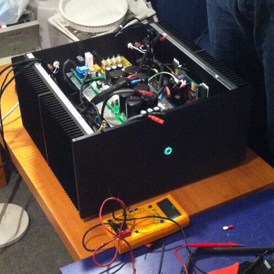

Hi Jacco,
Thank you for the suggestions. I will try to measure how hot the Sanken get during operation. You are right 125c is too hot but until now they are still "touchable" after an hour of operation; I doubt they get this hot. Off course this is not the die termperature but stil.......
By the way; the silicon sheets I used are Bergquist Silpad 2000; the highest perfoming pads I could find.

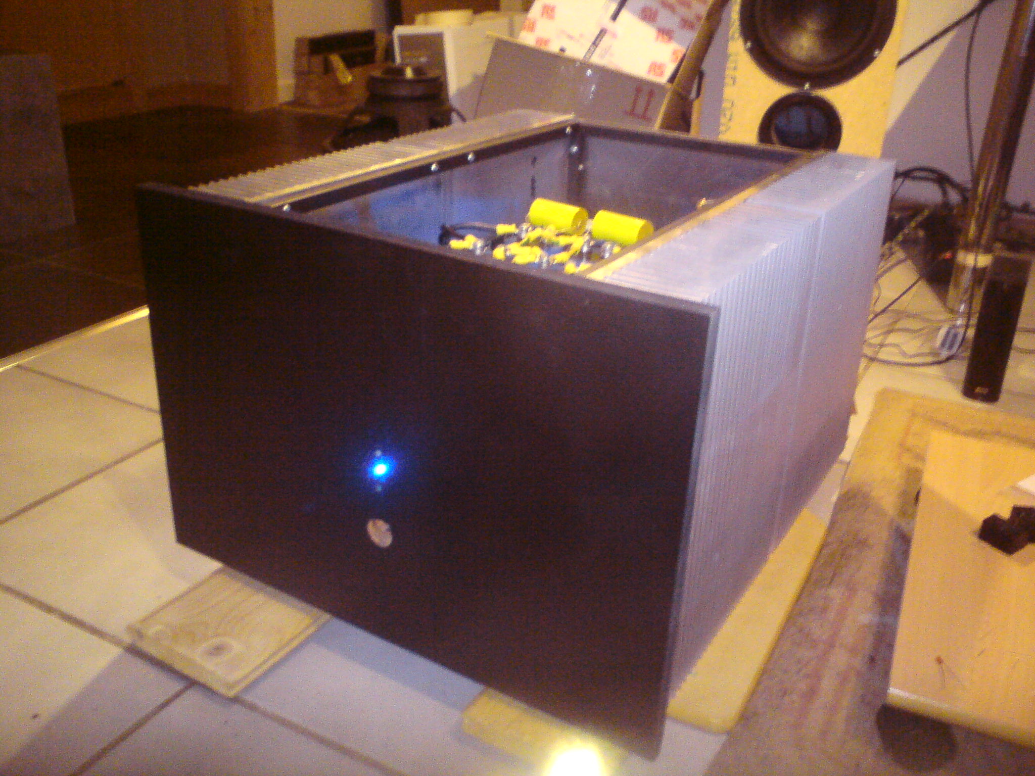

What an absolute monster...
I love it!!!
I'm often bitching about modern 7x150Wrms amps weighing a lot less than my 2x100Wrms amp.
I think you can beat my 18kg 😀
Talking about monsters, I once owned a McIntosh MC2300, a real monster, weighting 128 lb! (a horrible amp, btw)
Silpad 2000 has almost half the conductivity of the Kerafol, and can have up to twice the thickness.
Better insulator material than e.g. K-10, i haven't kept track of newer insulator material after EUVL's pointer to the Kerafol several years ago.
125C die temperature or a little under 120C makes little difference for the outcome though.
