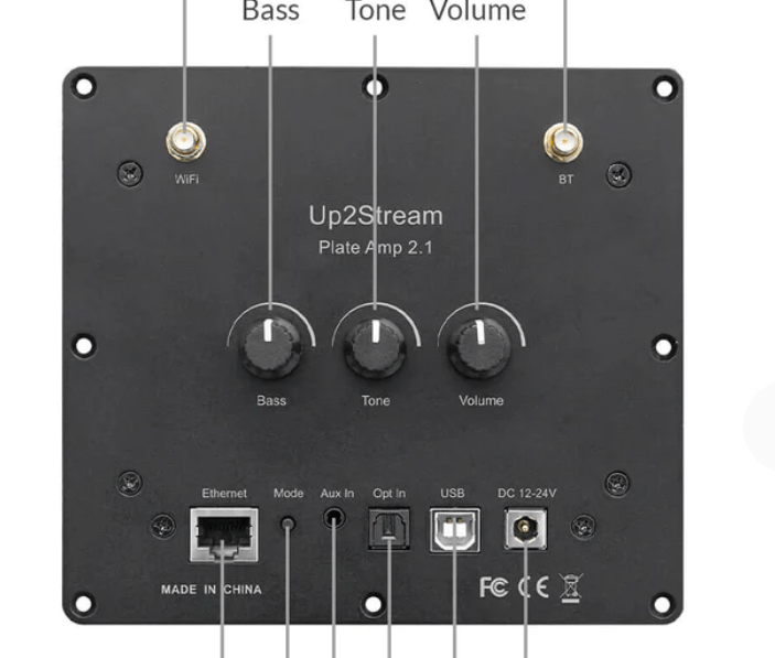

Another elementary question from me - a beginner audiophile. This time about multi channel amps running one speaker set
How are you all running multi channel amp boards to a single unit?

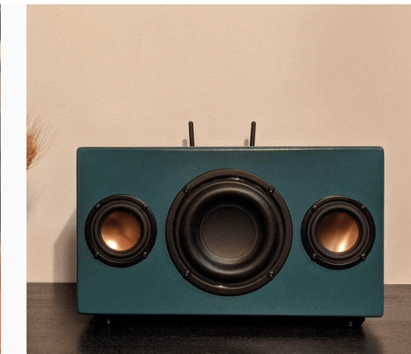

This will be my first build and I just want to make something small. Just a woofer or two and maybe a tweeter. Or maybe a 7" and two 3". Or maybe just a single full range in a horn.
It will be just for my bedroom to run the alexa speaker off an aux input (I know, terrible input source but I'm sure anything I make will blow away what the stupid echo dot can do)

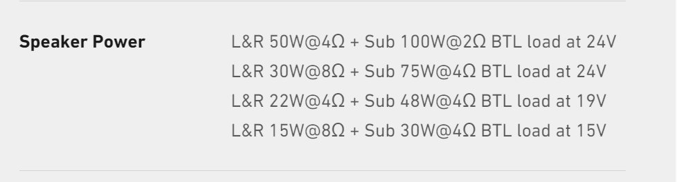

Can I just run both outputs to the single set of speakers? Is that what "bridging" is? Can all amps do this or they need to be designed for it?

PS: pics attached are of a build style I am going for in the bedroom. The amp board pic is one I am considering buying. The third pic is the specs of the amp board.

Only amplifiers designed to parallel output to one speaker (bridging) can do it without damage. PA pro amplifiers have specific bridging instructions. Often in a diagram painted on the top or back.
That is not bridging, and it can damage your amps.

How are you all running multi channel amp boards to a single unit? ....
More often than not, a multi-channel amp running a loudspeaker has to do with bi-amping (low/high) or tri-amping (low/mid/high), rather than bridging or paralleling.
This way, it also becomes easier to bring down the level of a tweeter to match those of the mids / lows, just by adjusting the gain of the tweeter amp. However, the filtering related to the different sections (low/mid/high) of the loudspeaker need to be carried out prior to amplification (active crossover).
