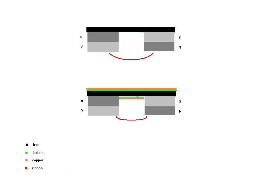

tinitus - Very interesting. How did you determine that the size and shape of the magnetic field had been changed by the copper strip? Are you measuring or simulating?
Denis
I use the tip of a very small screw driver amasing how much it can tell you
Its clear to me that the field in front of magnets gets flatter with the copper
It also bends down closer to the edge
In other words, it gets more concentrated
one other advantage of this design is that it makes use of wide and very strong magnets possible, without affecting the gap size
my magnets are too small and should be twice as big
mine may pull about 10pounds, and twice the size pulls something like 50pounds
another issue that might be worth to consider is the size of the magnet surface having contact with the iron
it might matter, but I dont know about that
I'm hesitating about the gap between between the magnets.. as you can see in the pictures I'm trying to move them together. Anyway, they seem to work fine.

Hello Tinitus,
copper is diamagnetic, which means μrel <1.
Permeability (electromagnetism) - Wikipedia, the free encyclopedia
But a value of 0.999994 for copper compared to 1.00000037 for air seems unlikely to have
noticeable influence on the design of the magnetic circuit itself.
You should get a hall probe for measurements, i fear the effect might boil down
to "wishful thinking".
Holding the screw driver in a very slightly different angle, should have
by far more influence on the forces you experience than the copper being
in the gap or not.
To measure the forces that way you would need a precision robot handling
the screw driver and very sensitive force sensors ...
No job for a human being, as i see it.
Or is there something i am overlooking (any of the physicists in here) ?

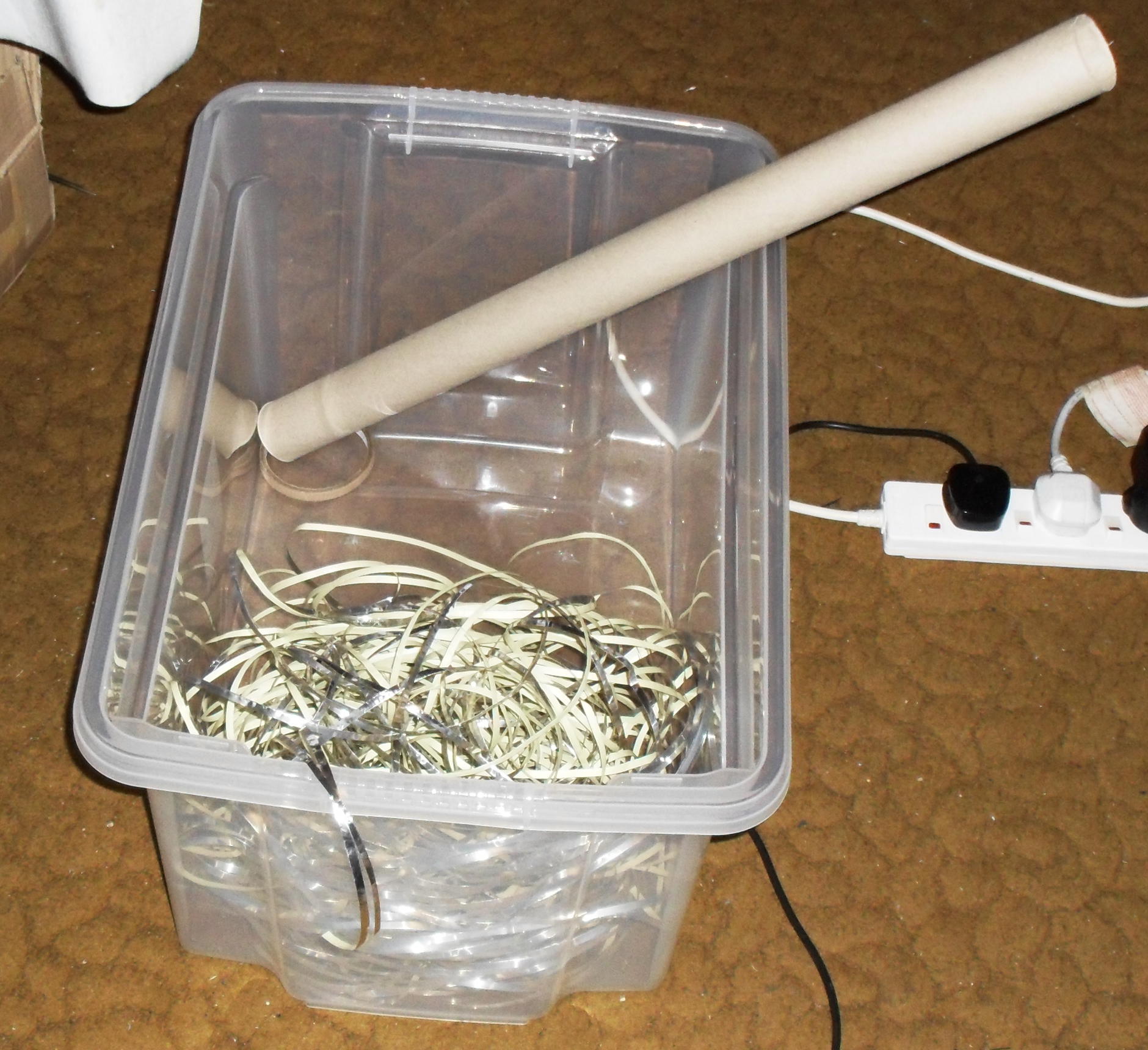

In these tweeters I used ribbon from the condenser, it is thinner than the food foil.
There is a machine for corrugating of ribbon on the photo.
I make two ribbon with different thicknesses and step of corrugating.
Mandatory installation of grid

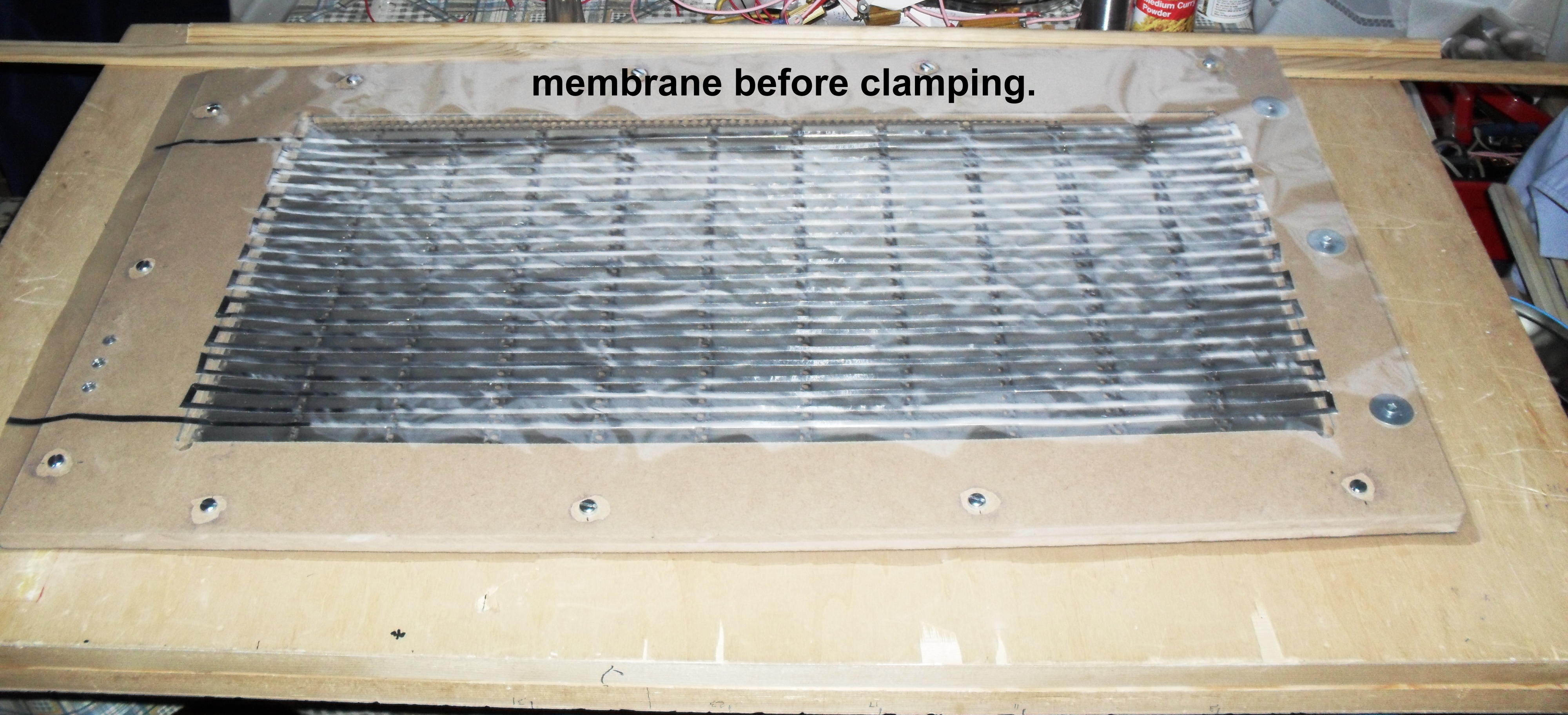

I cut a piece of 9-ply plywood. This the piece is basis for the magnetic system.

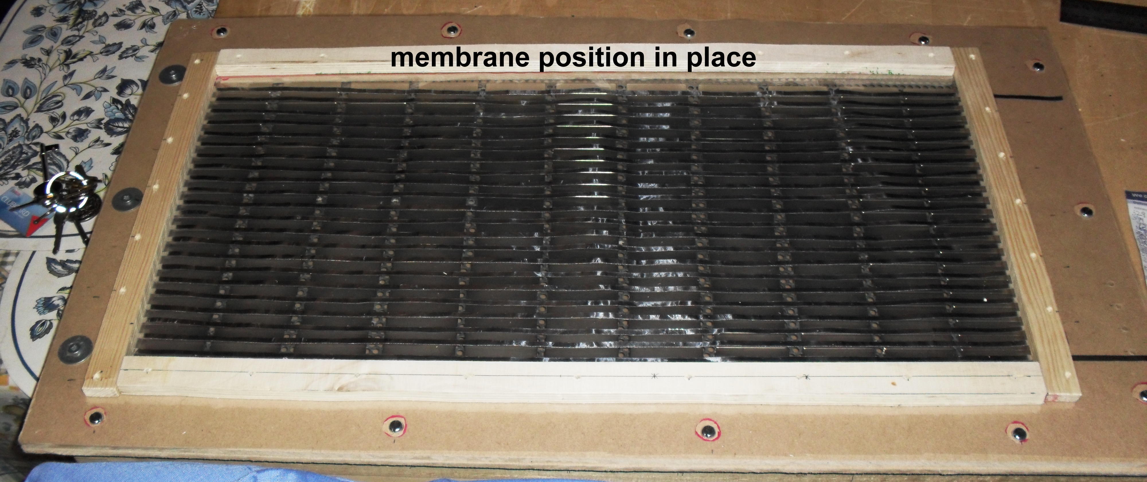

I set grill for two my little kids, because they like to poke fingers anywhere.

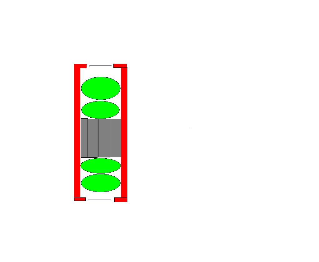

Can't You just cut slices out of the back chamber to let the air out?
You would still have a magnetic circuit that way.
Like Magnepans ribbon tweeter.
Otherwise You will have to calculate the gap-chambers acoustical impedance factor. You will in affect have a Helmholz resonator and thus a monopole ribbon.
Cheers from Sweden!
To avoid nasty reflections from all those odd shaped magnets and focus the magnetig field a solution like this could be made.
And it is even dipolar as there are ribbons in front and back.
You can even listen for the difference between monopolar response (disconnect the back ribbon) and dipolar response.
To explain the picture:
Red: Iron
Grey : magnets
Green: damping material
Blue : Ribbons

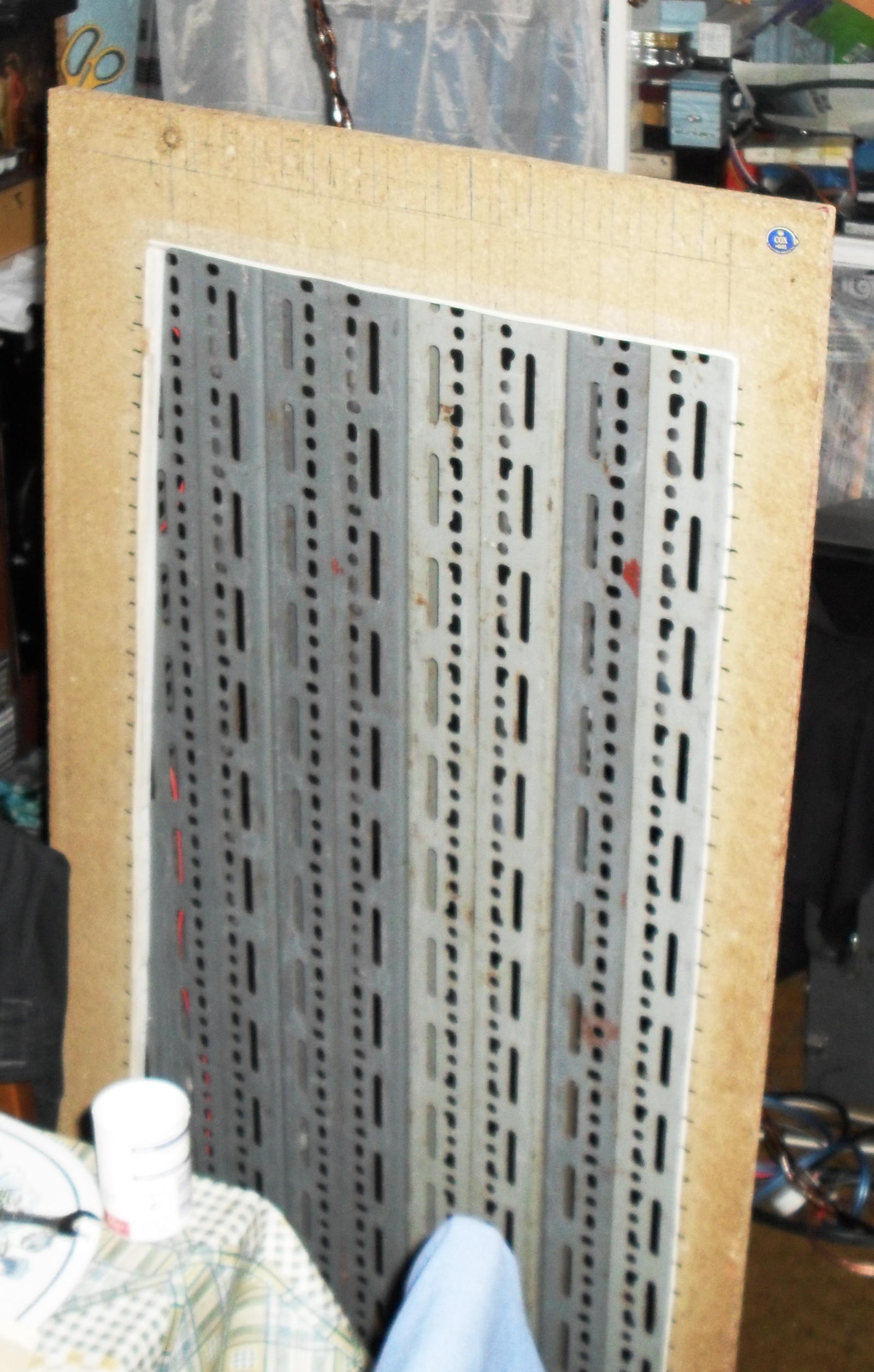

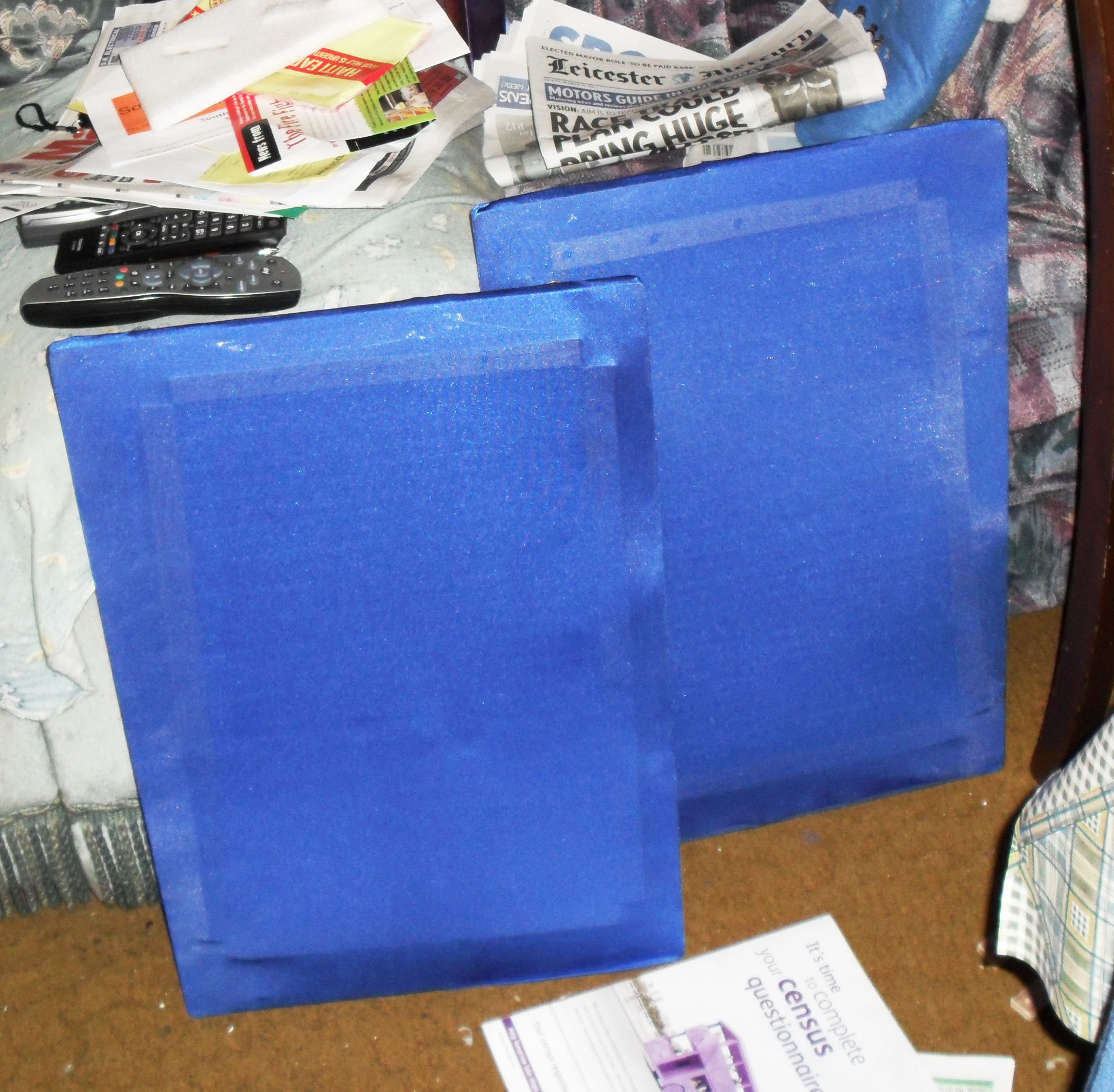

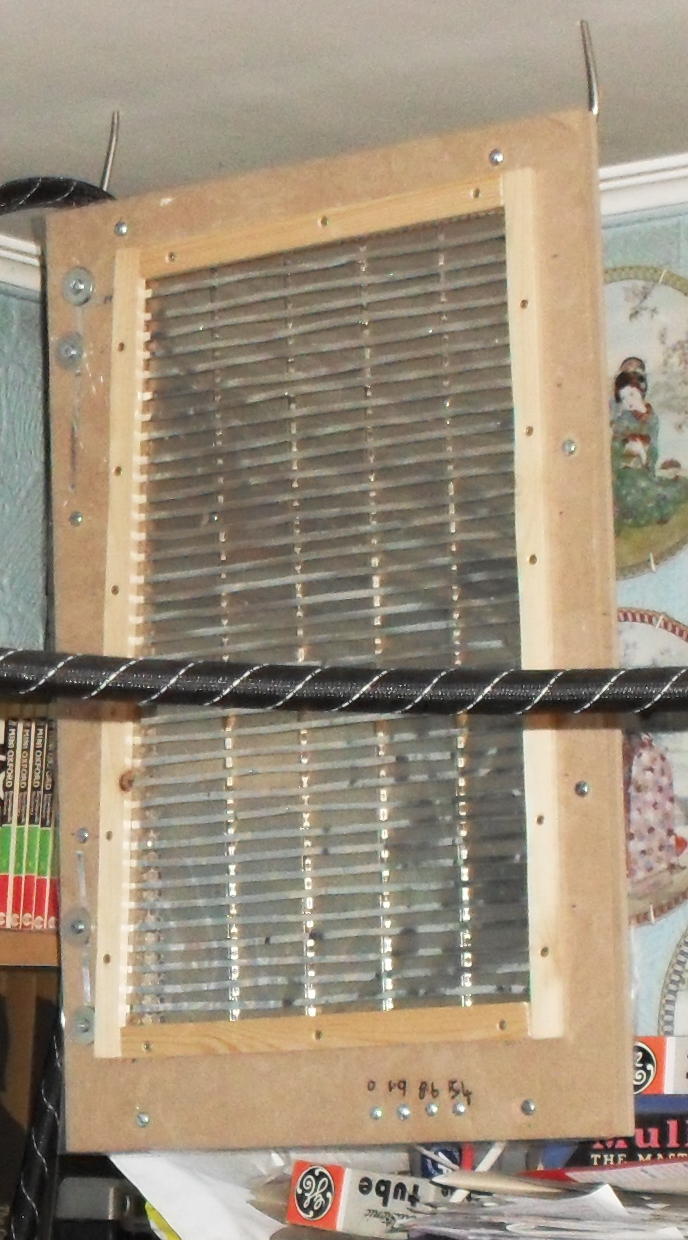

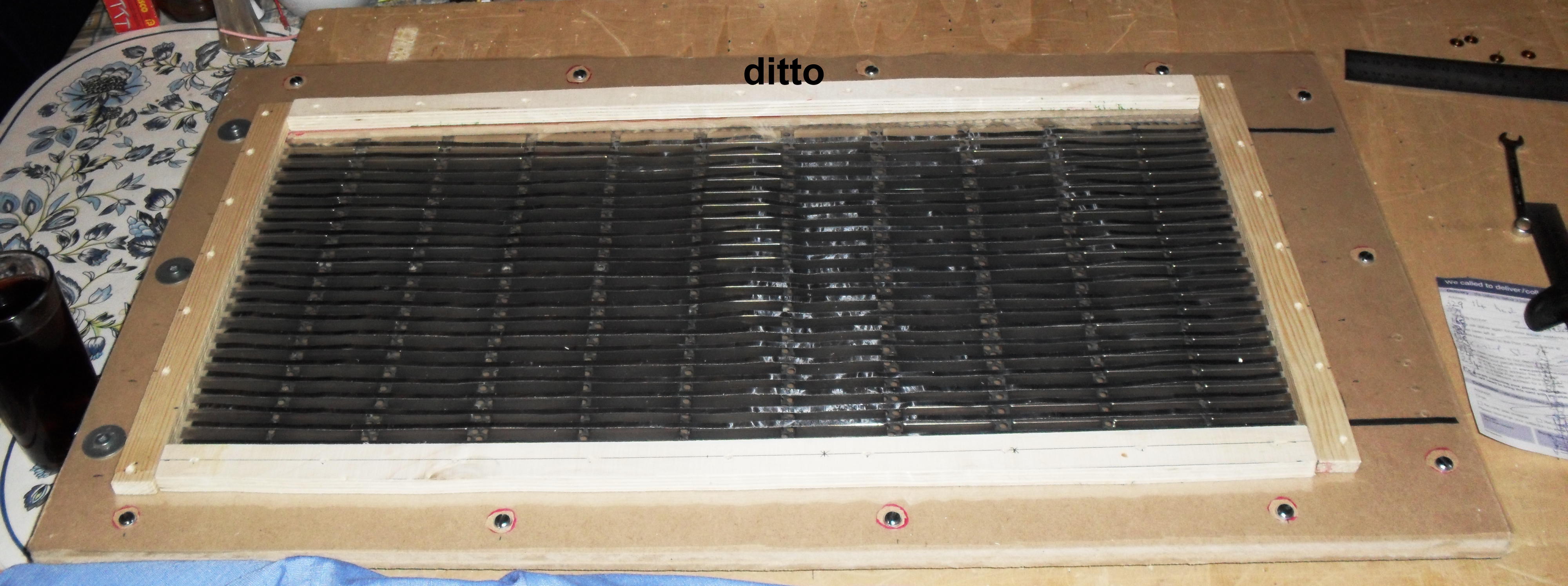

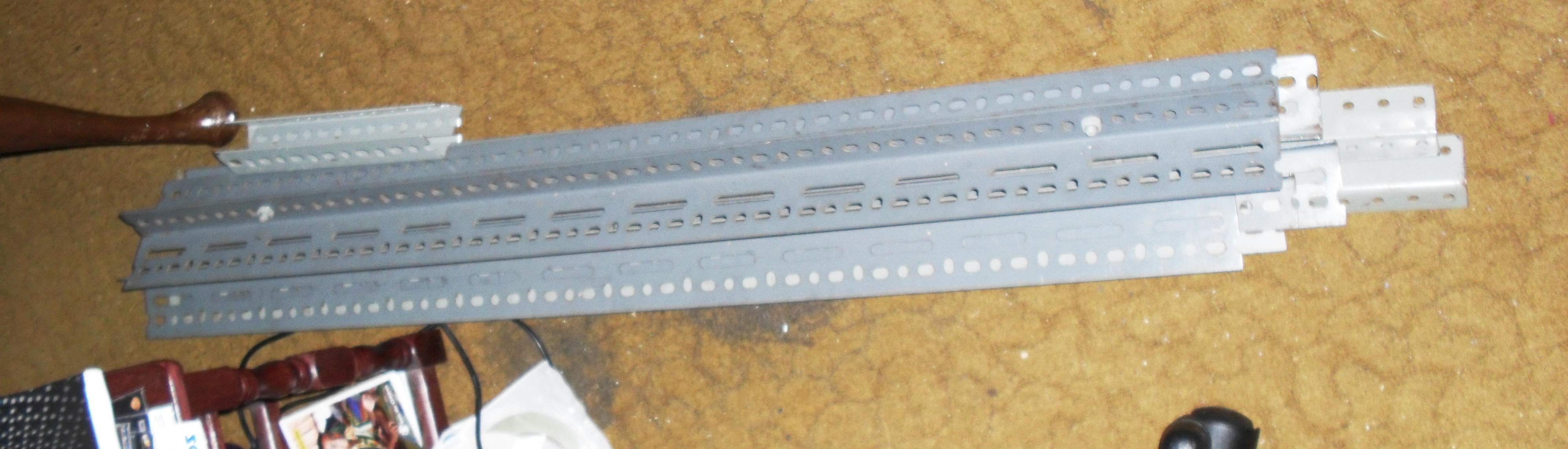

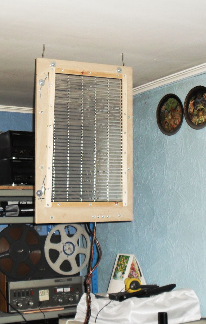

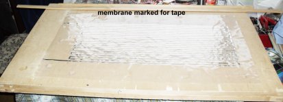

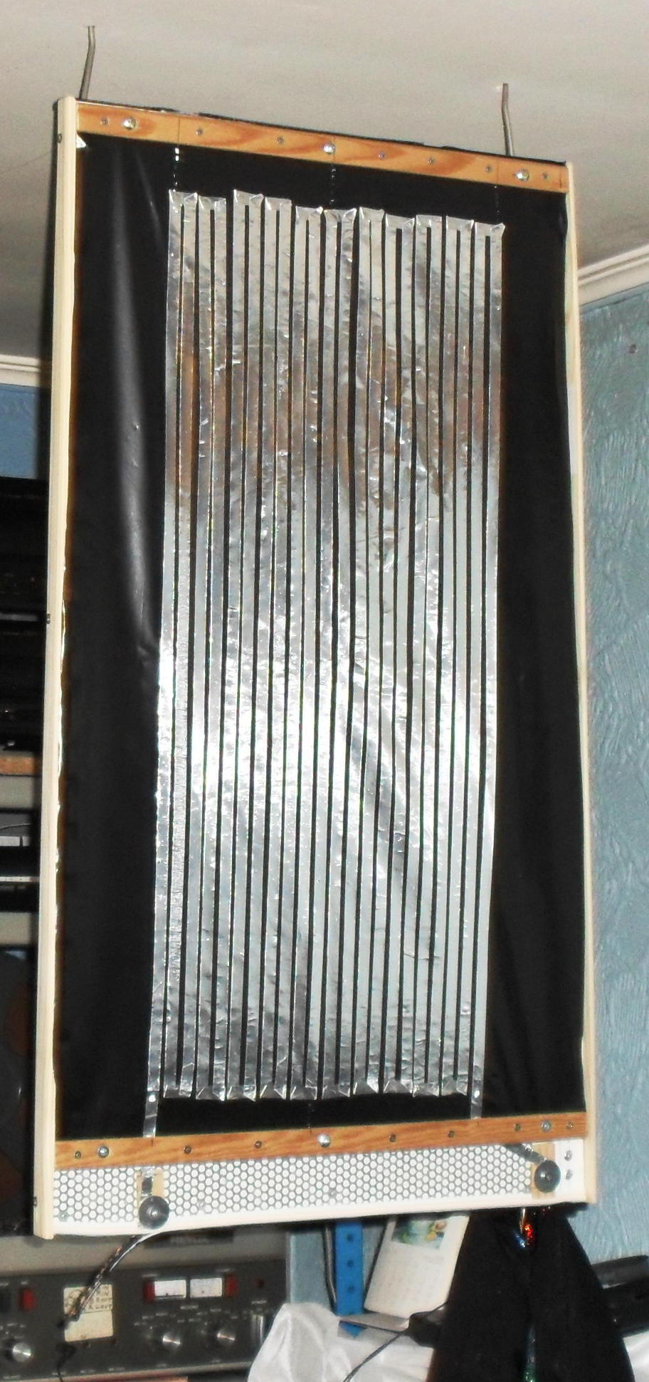

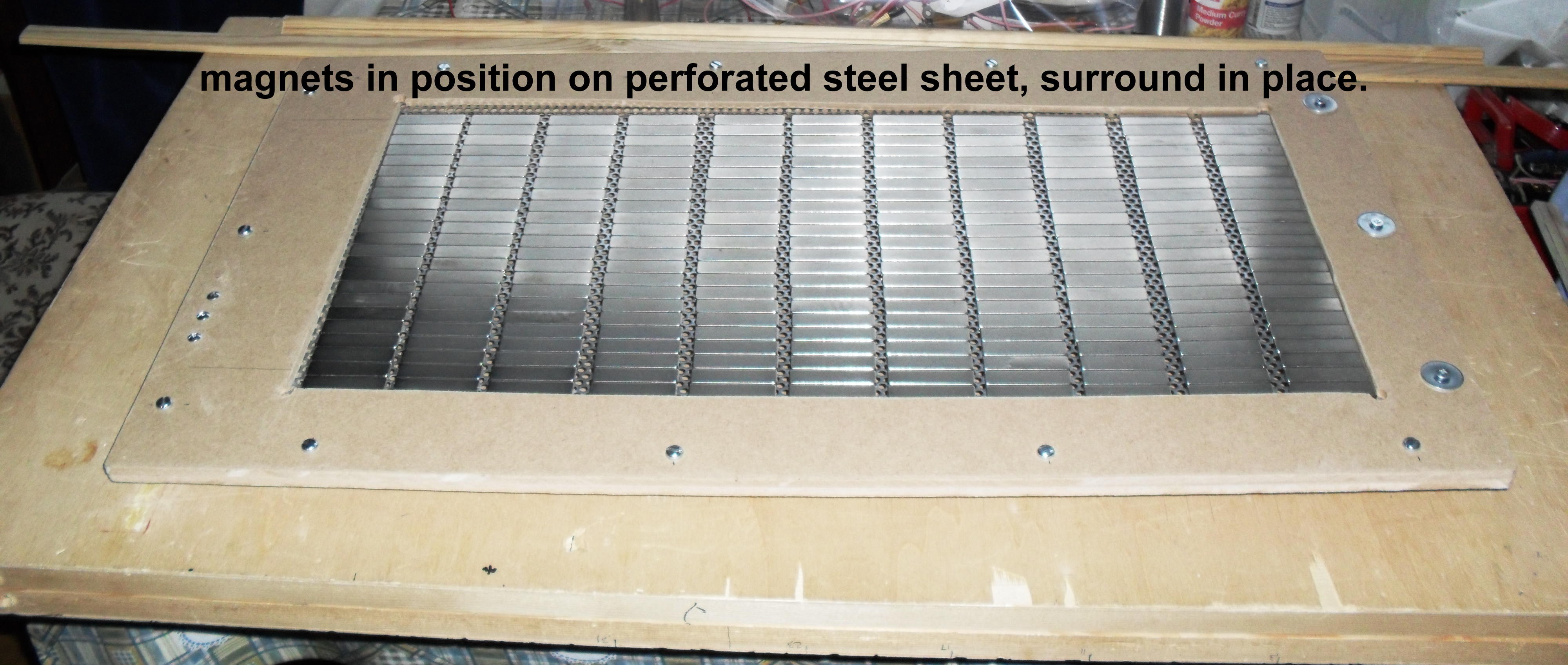

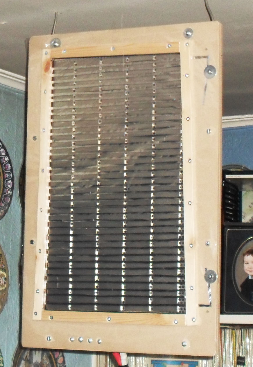

MY LATEST REBUILD.
These are my latest rebuilds and I think these are my last designs, famous last words! I have tried various designs over the last 20 years, but since the introduction of neo magnets, this has peeked my interest. I am in the process of rebuilding all my designs using 23 micron Mylar A. I have several pairs to rebuild including ferrite ones. I did use angle iron on these, but I have reduced the weight considerably by not using the angle iron in my upcoming rebuilds. I am very happy with the bass which goes down to 20Hz, and is very tight and focussed. Unlike the bass on the esl 57's and 63's which is quite plummy and resonant.
Some more pictures of my work.
This should help anyone interested in building FRP .No crossovers and down to 20k. I fact I have one of my designs as a sub woofer
