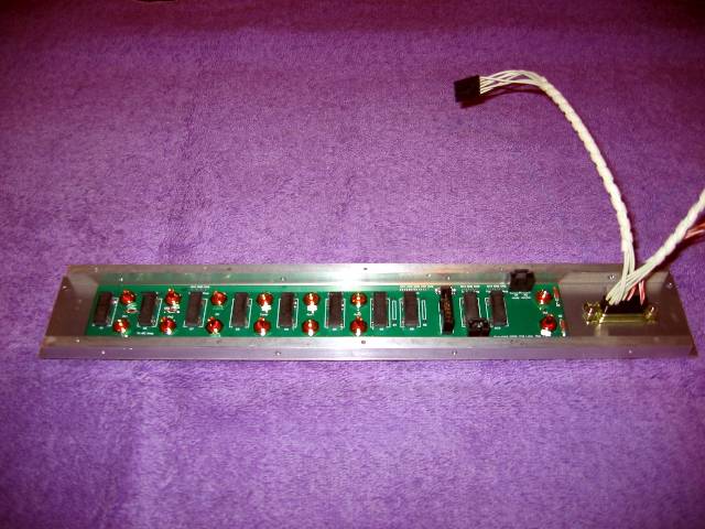

Relay PCB For Preamp
Here is the relay board that inorporates all the switching for the preamp. Dry reed relays are used throughout to eliminate most of the problems associated with mechanical switches. In addition to six input sources, relays are also used for stereo/mono and muting. Another advantage of relays is that expensive dual switches are not required
All the phono connectors are isolated from the chassis by means of fiber washers, and the PCB is separated from the rear panel by shoulder washers which act as standoffs. Getting all the holes in the rear panel to exactly match those in the PCB was a bit of a challenge. I ended up sacrificing one of the PCBs to use as a drill template. If I build more than one preamp I'll use a vertical mill and drill to coordinates.
