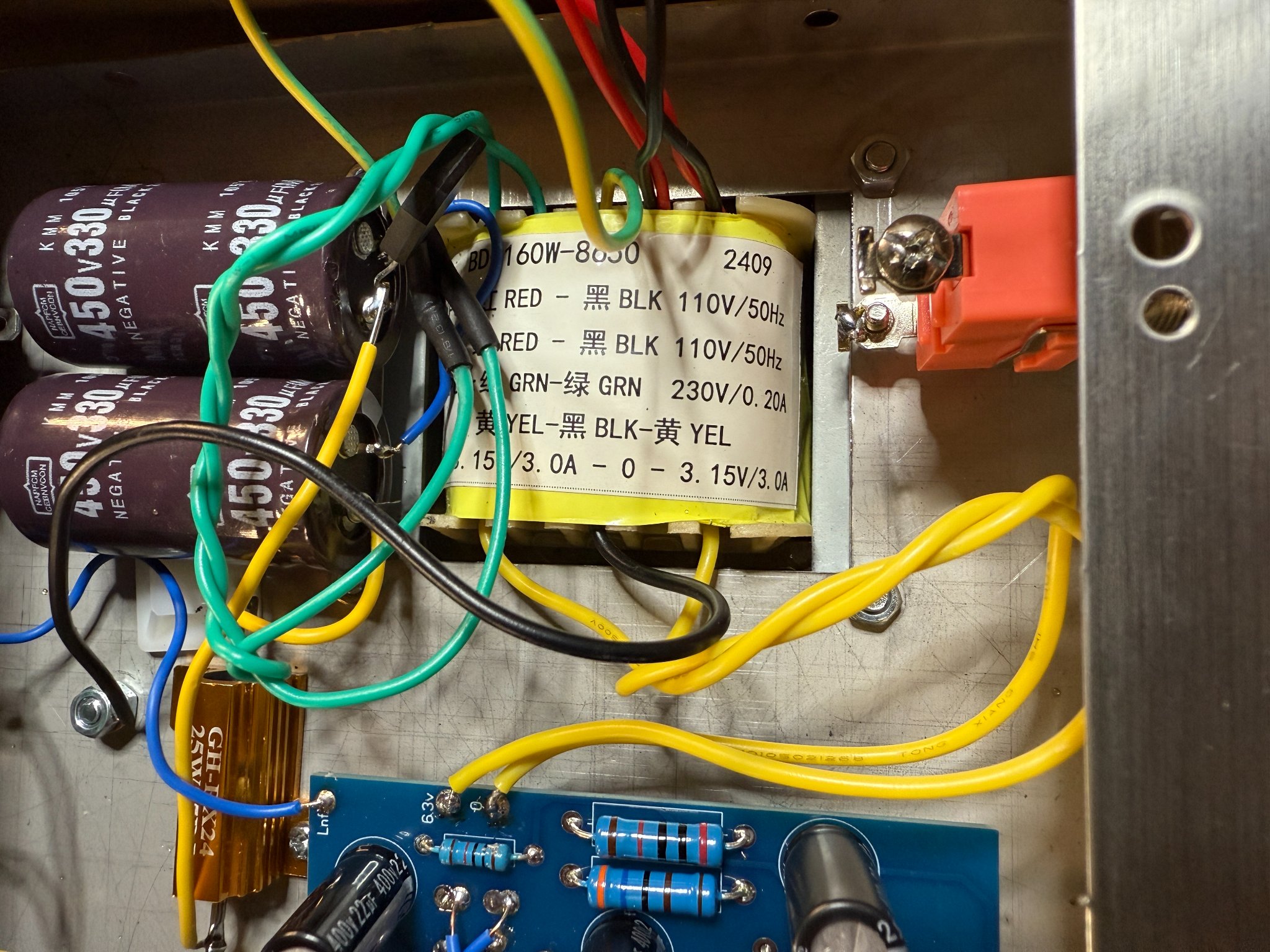

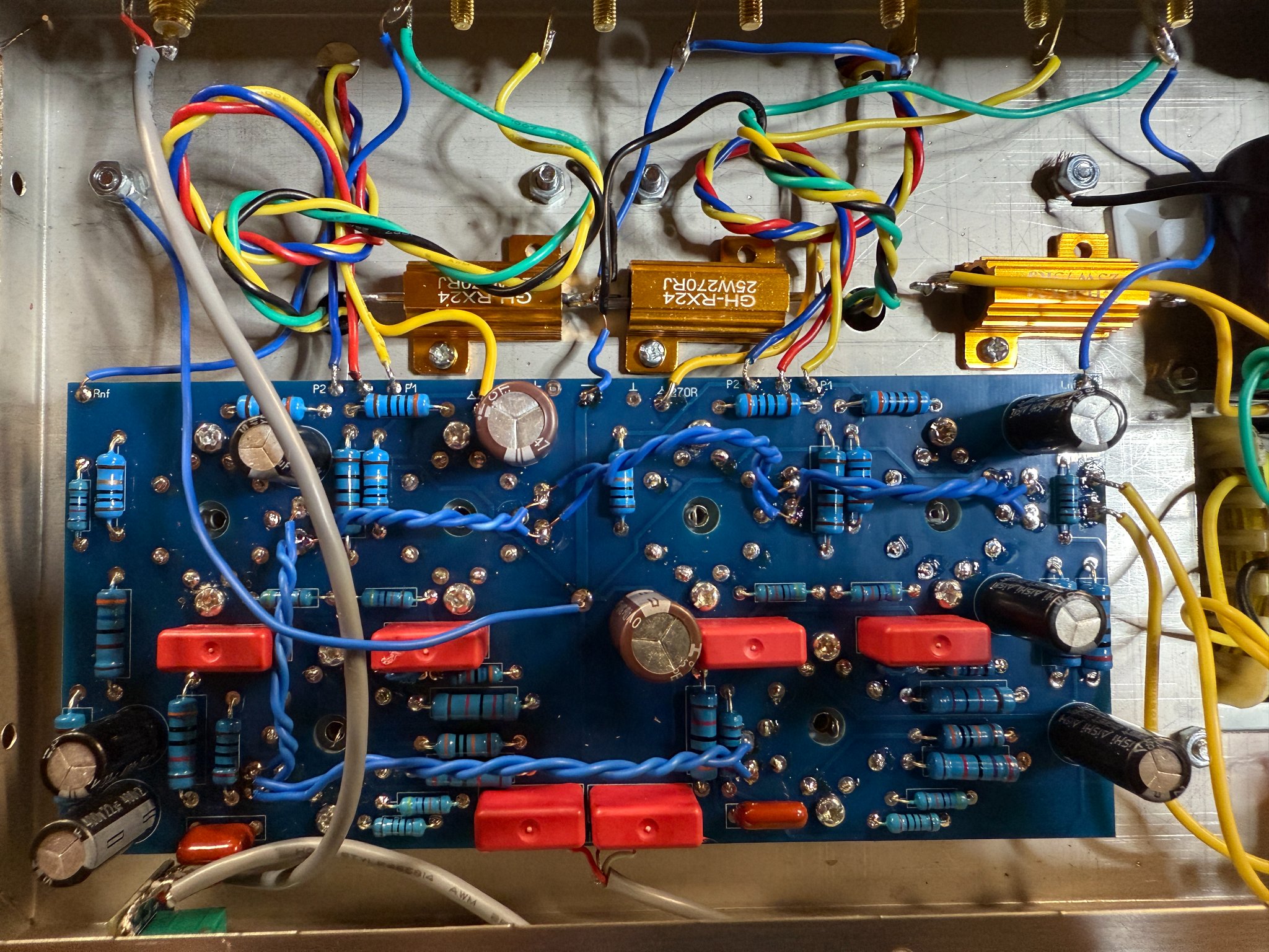

Hello all. I built a Chinese PP tube amp I have had laying around for a few months. As we know there are no instructions aside from the schematic they send with it, which isn't great.
I followed as best as I could here: https://www.diyaudio.com/community/threads/problems-with-chinese-pp-kit.353111/

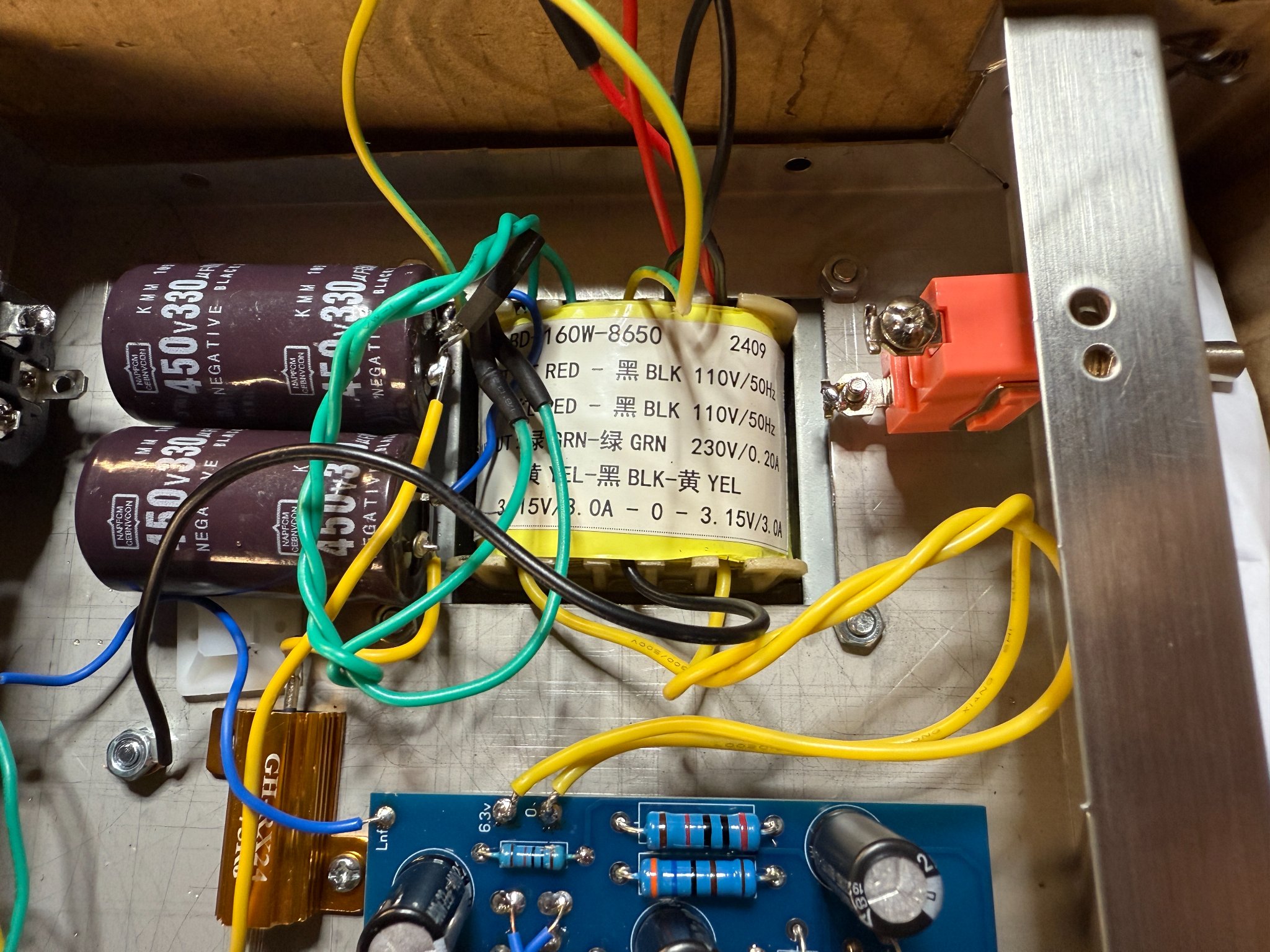

I have the transformer marked as 110v, same or similar to the one in post #98 in the above link. I am still not sure how to wire the primaries or the 2 yellow and one black (Yel-Blk-Yel). They show going to the 6.3v/0 and I assume the black go to chassis ground. And the primaries? Red-Blk/Red/Blk. I see only 6+ volts on one of those primaries. Are they marked incorrectly, perhaps?
Hi Robert, I have attached some photos. Red and black leads are currently disconnected. Thank you.

Hello,
Connect one red lead with one black lead.
The mains has to be connected to the remaining 'free' black and red lead, but with the fuse and the on/off switch between the mains and one of these leads (it does not matter which lead).
In this way the two primary windings of each 110 V will be connected in series, resulting in one primary winding of 220 V.
Edit:
I just realized that according to the flag you use, you are likely living in the US, so your mains is likely 110/115 Vac.
If this is the case, you should connect the red leads to each other, and the black leads to each other.
The mains has to be connected to each of these joints, but with the fuse and the on/off switch between the mains and one of these joints (it does not matter which of the joints).
In this way the two primary windings of each 110 V will be connected in parallel, resulting in one primary winding of 110 V.
Reactions: hamsalad
Robert, you are correct. My mains sits at around 117 to 121 at the wall. Thanks for the edit.
