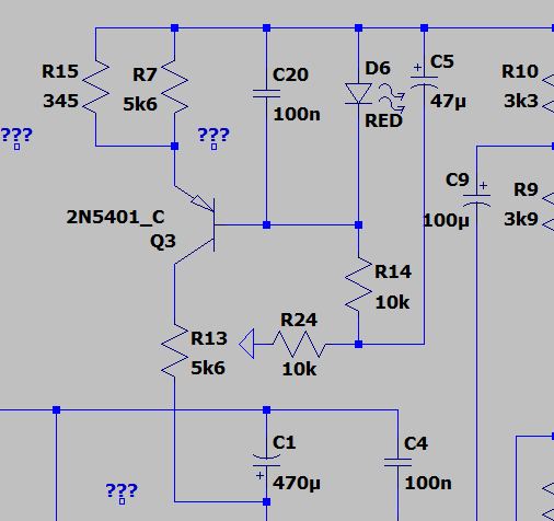

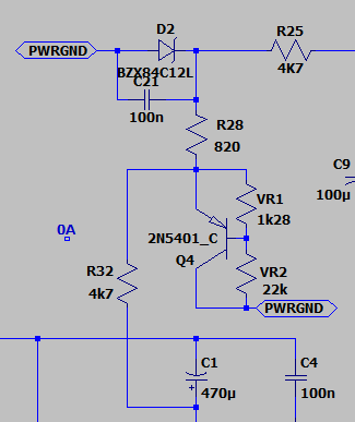

May I ask, what is the difference between these two current source configuration.
In the first case, these are two series L-shaped converters, the first is a stabilizer implemented on a zener diode, the second is an electronic potentiometer on a transistor with low differential resistance, so as not to use the capacitance.
The second option is a standard source of stable current, although it is implemented redundantly and, in fact, is not very true, since its internal resistance does not increase this way.
CS_A seems to favor singletons..but why..🤔
The first option can be physically used if the input stage has a low output impedance, or, simply speaking, an emitter follower. The second one is more universal and therefore used more often and it is more linear for the input circuit.
Thanks Henk,
I did not see much difference in simulation using each one on the singleton design, except that the first one (CS A) is very tricky to configure. R32 R28 R35 needs to come up with a fix value in order for VR1A to gradually respond into a step by step adjustment. The second one (CS B) is much easier to adjust via R15.
Do each one (or which of them) contribute to a better current regulation? I run a PSRR simulation of the circuit using both, the results were the same at 108dB.
Albert
In my opinion, the second option is better, because it does not use the ground as a reference point, which eliminates the additional current modulation of the reference voltage of small-current signals through the gnd track.
That is, R24 must be correctly connected to the opposite power rail.

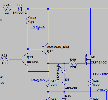

People, may I ask again what is the proper mounting of the VBE multiplier transistor when using cfp drivers? Is it Q12 only with VBE or both Q12 and Q13 and VBE on a separate heatsink?
Thanks!
Albert
