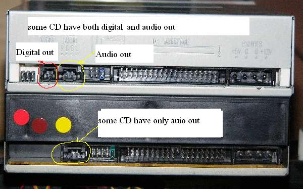

Tonight I will take photo and show you.
BackSide of CDROM
Dear all,
The data when CD Audio is played can output via IDE Interface.
if Cd-Rom play the CD Audio in Audio play mode the signal will output at audio out and headphone (at front panel).
if Cd-Rom play the Cd Audio in Digital play mode, Cd-Rom will read the data from CD Audio and store in the buffer, and then Cd-Rom will issue the interupt to the host to read the buffer. The maximun of data is 65536 Bytes in each interupt. Sometime may be less than 65536 Bytes. Then the host will read the data in Cd-Rom buffer after host read, Cd-Rom will delete the data in buffer and store new data.
When Host get the data from Cd-Rom, the data will be converted to audio signal via DAC. (if Cd-Rom play MP3 media, the data is decoded and converted to be audio signal.)

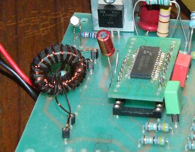

LCD with Backlight
Mount socket behind board, you just only Plug&Play
Board Require DC9-12V
Board have 7805 Regulator on board
Price 45 USD include Finished Board+Remote+Lcd

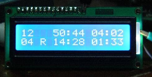

Hex File with my Schematic
This can use with my schematic above just take off IR ,
Function
Play, Skip FW, BW, Pause, Repeat, Stop
LCD Display
No Remote function,
Rename file from 16F877LcdV5.Hex.txt to 16F877lcdv5.hex
Don't forget to set jumper to master,
This program already use by many people guarantee work 🙂
