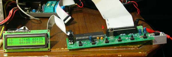

LCD is 44780 Compatible.
On LCD show
Total Song Total Time Time of current track
Track No. Total Elapse Time Repeat Status

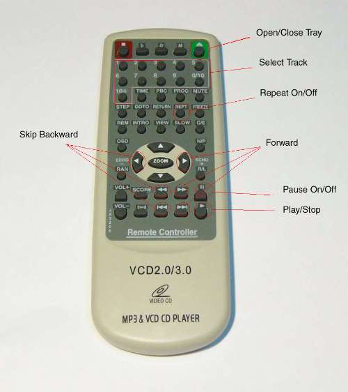

Features:
Pause On/Off
Stop/Play
Eject
Skip next Song
Backward Previous Song
Auto Repeat On/Off
Can Choose Track No. by press No. on Remote Control
On LCD show
Features:
Pause On/Off
Stop/Play
Eject
Skip next Song
Auto Repeat On/Off

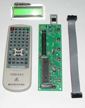

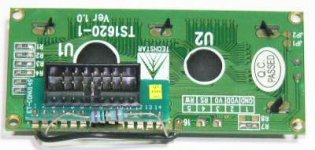

LCD with Backlight
Mount socket behind board, you just only Plug&Play
Board Require DC9-12V
Board have 7805 Regulator on board
Price 45 USD include Finished Board+Remote+Lcd
Not include shipping Charge
Shipping charge USA, Canada, Europe, Australia 30 USD.
Shipping charge in Asia 20 USD
by Registered Mail of Thai Post Office.
If interested mail me pradit@neonmagazine.com

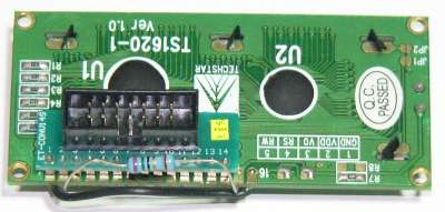

pradit_p said:If you can find LCD which look better than me.
You can cut off LCD.
Price for Board+Remote not include LCD is 35 USD+shipping

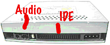

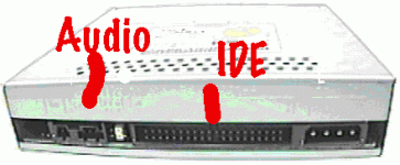

the price seems right, and it could make for a kinda cool player. although, im not sure how you would get audio out of the IDE device?
Joined 2002
the audio doesnt come from the ide port the audio comes from the audio port on the back.. the ide port is for controlling the Drive..
ah, anyone have a picture of the back of an IDE drive? i dont remember an audio out on the back of a drive.

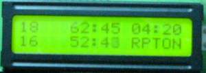

JasonL said:the audio doesnt come from the ide port the audio comes from the audio port on the back.. the ide port is for controlling the Drive..

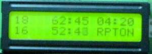

That 's right. And if you can find some cdrom drive that have
digital out like my ASUS CD-S520. I use digital out to my DAC coupling by 30 turn on small ferrite ring core and sound good.
This 's show Playing.

cowanrg said:ah, anyone have a picture of the back of an IDE drive? i dont remember an audio out on the back of a drive.
Tonight I will take photo and show you.
