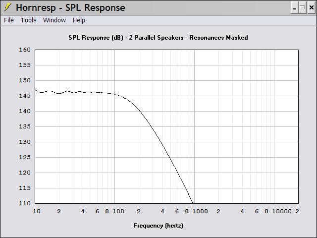

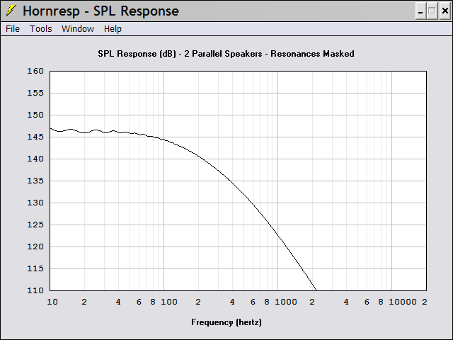

Ok you guys are right, I changed the pathlength to 1 cm and the low end looks close enough to the same to conclude there is no benefit to the waveguide below 40 hz or so. This had me confused for a bit because winisd shows an entirely different graph with the same sealed box of 100 cubic feet and the same 8 drivers. Winisd says it rolls off hard at 35 hz and is only capable of 112 db at 10 hz, as opposed to about 135 predicted by hornresp. Not sure how to change to .5 x pi in winisd, but even so, the difference in the graphs produced by these 2 programs don't have anything in common.
Back to the drawing board.

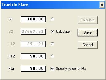

Hornresp lets me choose the flare angle OR the horn cutoff OR the length. I'd like to choose the flare angle AND the horn cutoff, and let it calculate length, but I can't seem to do that.
Either way, it's not too important. If it doesn't work, it just doesn't work. I don't want to try to force physics into the shape of a picture I drew.

just a guy said:Hornresp lets me choose the flare angle OR the horn cutoff OR the length. I'd like to choose the flare angle AND the horn cutoff, and let it calculate length, but I can't seem to do that.
Hi just a guy,
I assume that you are using the Tractrix Flare Horn Segment Wizard? If so, simply select the "S2 Calculate" option and then click on the Fta check box. The mouth area and axial length can then be calculated given the throat area, cutoff frequency and flare tangent angle.
Hope this helps.

Hi David, I've only had a couple hours of time to play with this great little program so far, so I have lots to learn yet.
I'll try your suggestion when I am able.

I finally got some more time to play with hornresp and this is what I noticed.
1. To make the smoothly curved front wall that I drew the fta (flare angle) needs to be as close to 90 degrees as possible. Even 70 degrees could be acceptable, but the curve is not as smooth and by the time you get down to about 40 degrees it starts to look like the hull of a ship crashed through the front wall of the room, as I mentioned earlier.
2. AFAIK tractrix is the only flare that can give a huge 90 degree flare at the end. From what I`ve read tractrix is no good for bass but hornresp seems to disagree somewhat.
3. I haven't tried really hard yet, but when I did try I was not able to fit a tractrix segment as the final flare to any other previous segments, regardless of flare type. So I simply modelled using a single segment tractrix flare. Makes everything pretty easy anyway.
4. I still can't get the flare angle AND F12 (lower horn cutoff) that I want with any combination of the other parameters. I can make a horn with a 90 degree flare but the F12 will only be 30 hz. To get the F12 lower, I need to use less horn flare. At 70 degrees (IIRC) I can get the F12 down to about 25 hz, and with a 10 hz F12 the flare angle is less than 20 degrees. Regardless of the other inputs I can't get a 90 degree flare AND a 10 hz F12. I think the mouth size might be the limit here. I've tried adjusting every other input parameter up and down. The only thing I can't do is make the mouth bigger, and I think this is imposing the restriction I'm stuck on.

i made a script to approximate the behaviour of a horn in a room. the room is simulated as a duct element, so it has standing waves etc. should be exact enough for subwoofer simulation. it assumes the horn mouth is at one wall of the room. for exact placement, the script needs more elements (waveguides). it simulates the response at the mouth.
Copy the script into an empty akabak script and hit F5 to simulate. You can easily change the driver, horn and room to your own specs. the QD/fo value simulates the damping of soundwaves in the room. Small value = high damping. You have to experiment with this value, as i have no clue what value a normal room would have. with values greater than 1, you can see all those standing waves 🙂

Thanks for that Mavo. I've heard how tricky akabak is and as a result I've never downloaded it or even looked at it. I guess this is a pretty good reason to give it a go. I'll have to study a bit to find out what your script even means, much less change it to suit my needs at this point.
