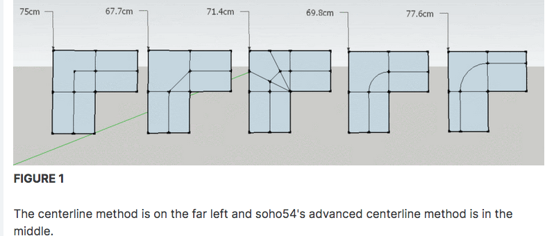

Hey look at that, pretty simple how each cross sectional area just about doubles other than S1.
Overall, that adds up to an exponential expansion, but as each individual horn section has two parallel walls, "Par" (parabolic) rather than "Exp" would make the sim closer to the build.
That said, it won't make much difference in the results.
Fc looks higher than the EAW spec, indicating your estimated path length might be a little short.
The "advanced centerline" estimation seems to work best for horn folds :
Right , minor path length difference and the "Exp" substituted for the "Par" won't amount to much.
The "VTC" (Volume of Throat Chamber) made up by the cone profile and the speaker standoff (which you omitted in your "Bertha PDF") will also make a small difference which may not amount to much.
Omitting the speaker standoff, or making it's depth too short will make for a lot of slapping when driven hard just above or below Fb 😳

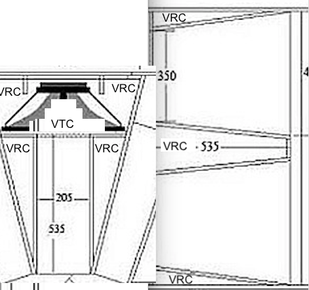

I think I see what you're saying. The driver needs a little height off the baffle which is the "stand off" so the cone doesn't slap the letterbox and you can seal up VRC with less air by making that staved wood part. the VTC needs to exist while being as far from the baffle as the cone needs to travel. I might use some 1" material for the standoff.. what a nightmare of a mistake it would be if that were too short.. That said we both think the acoustic changes in our efforts to dial the sim in tighter would be minimal.. Am I following you?
Reactions: maxolini
The VTC includes the volume of the standoff (you might use 1" or 25mm, rather than the 15mm the EAW BH882 used for construction) the speaker gasket depth, plus the volume of the cone shape which together may total more than 4 liters per driver. Cone shapes come from near flat to 100mm deep.
The volume of the rear chambers (VTC) also includes the triangular sections on either side, above and below and in between the initial horn expansion. Those volumes could be sealed off if you choose to use a smaller VTC .
