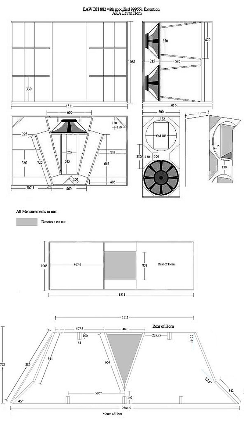

Can anyone tell me if this layout works well? I see 3+ Bertha drawings on the internet each with slight variation in the geometry. I am wondering if there is one that is actually perfectly correct / true to the original? I attached the one that I think looks honest and usable for verification.
Thanks,
Thanks,
If built solidly, that design will work well with the correct drivers.Can anyone tell me if this layout works well? I see 3+ Bertha drawings on the internet each with slight variation in the geometry. I am wondering if there is one that is actually perfectly correct / true to the original?
The dimensions you show fit the EAW BH882iP, Richard Long's 1970s "Berthas" may be slightly different.
Slight variations in the geometry won't make any difference you would hear in any indoor deployment, driver choice will make more response variation.
Huge cabinet, considering response drops about 24dB per octave below 38Hz, with the extension should get down to ~30Hz.
The standoff baffle material depth is OK for drivers with Xmax ~8mm, should be increased if you were going to use high excursion drivers.

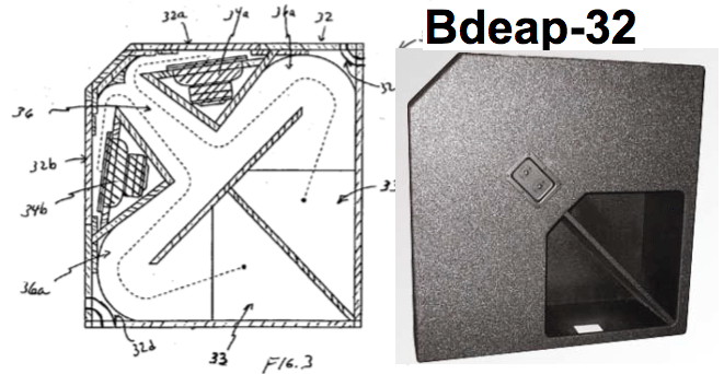

If you can use a room's corner walls as the horn extension only a fraction of the plywood is needed for ~30Hz response.
The room corner trihedral mouth would be considerably larger than the 9951 mouth extension.
The Klipschorn or Tom Danley's "Bdeap" (Boundary Dependent External Air Path) are examples of the concept.
https://www.freepatentsonline.com/20040238268.pdf

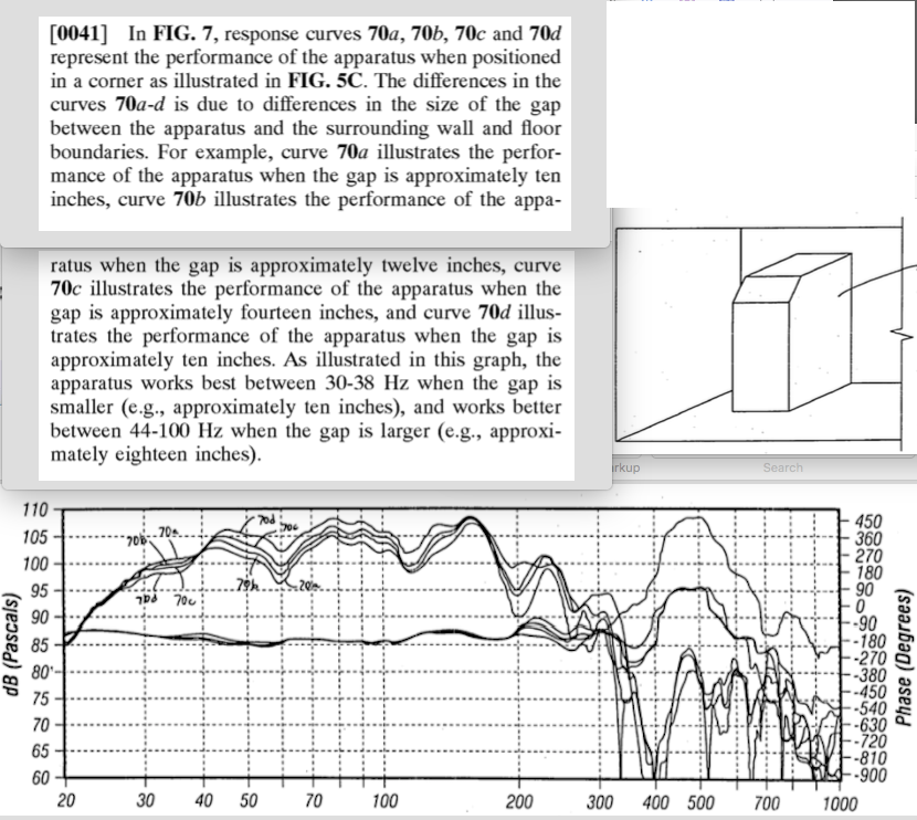

The proximity to the corner boundary changes the response, the horn loads to a lower frequency when around 10" from the wall:

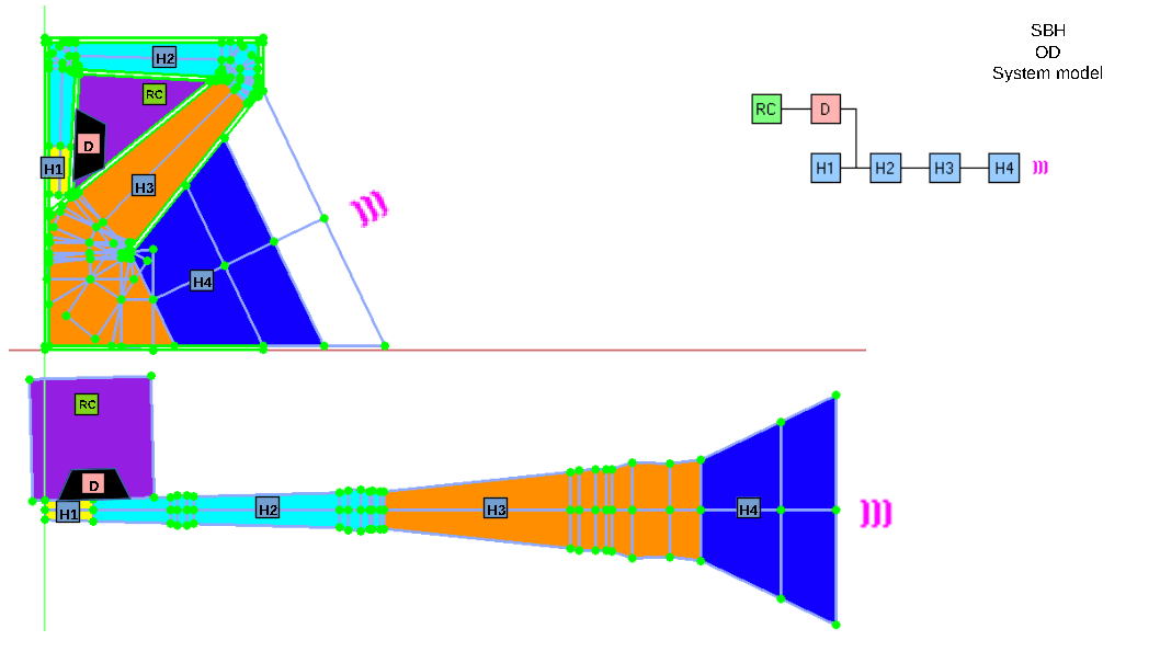

If FLH is desired, maybe the SuperBassHorn could be a better option It can reach 30Hz, no internal space wasted and bigger mouth.
Link for custom model in parametric CAD
https://freeloudspeakerplan.rf.gd/pages/sbh.htm
Original PDF plan also attached for replication, but customize it for a specific drive is smarter.

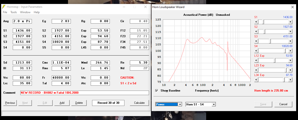

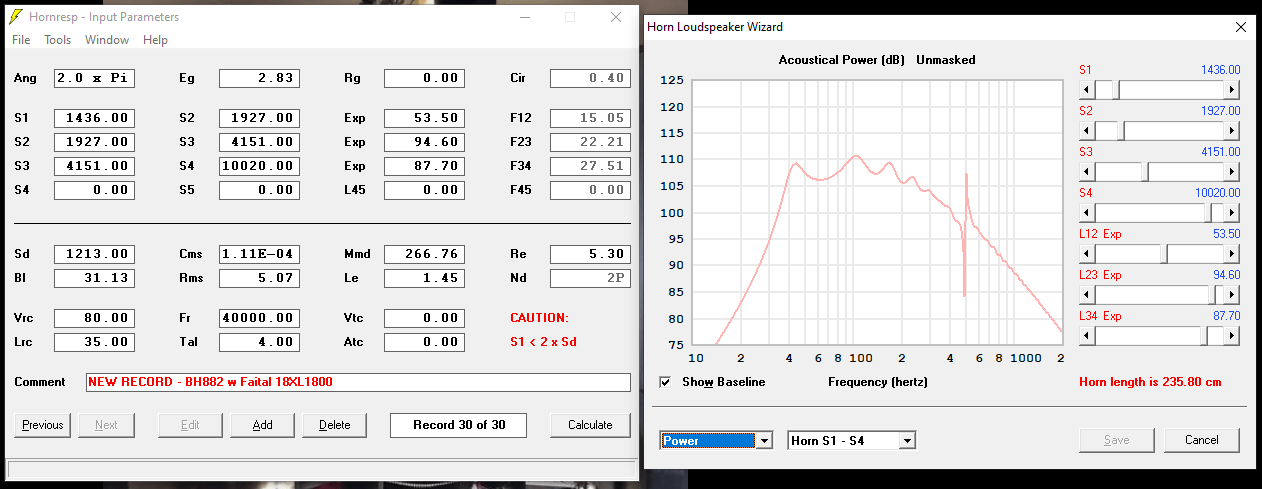

Here is where I am with the BH882.. It's a good starting point for entering it into horn resp.. ☕
S1 = 35cm X 20.5cm = 717^3cm doubled for 2x transducers and it's 1435^3cm
L1-2 = 53.5cm
S2 = 47cm X 20.5cm = 963.5^3cm, doubled for each half of the unit ( it's a W.. ) and S2=1927^3cm
L2-3 = 90.5cm
S3 = 20.15cm x 103cm = 2075.5^3cm, doubled for each half of the unit ( it's a W.. ) and S3= 4151.9^cm
L3-4 = 87.71cm
S4 = 50.75cm X 103cm = 5227.25cm, doubled for each half of the unit ( it's a W.. ) and S4= 10,545.5^3cm
Hey look at that, pretty simple how each cross sectional area just about doubles other than S1..
