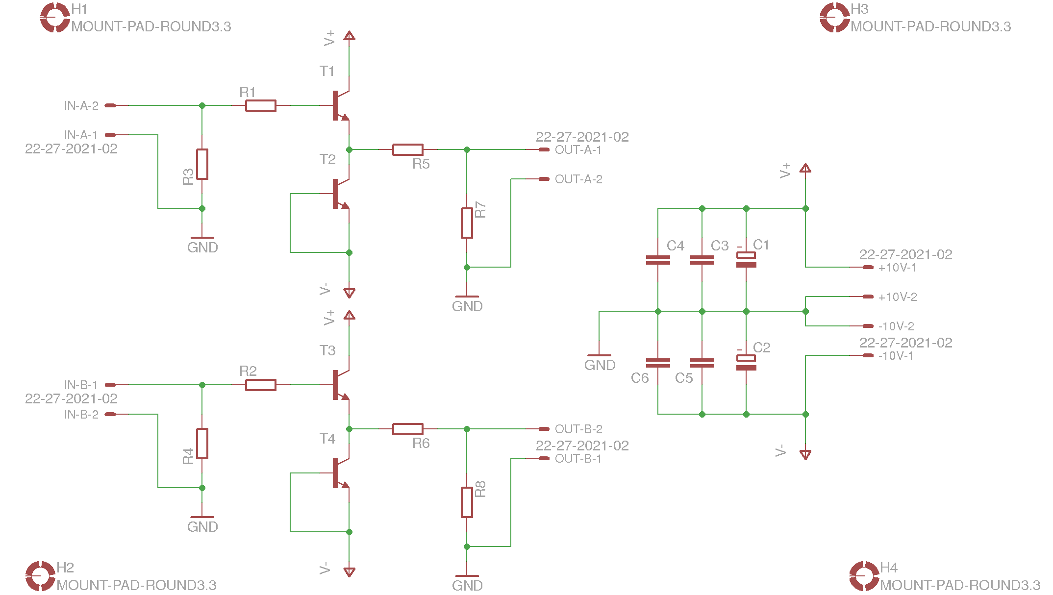

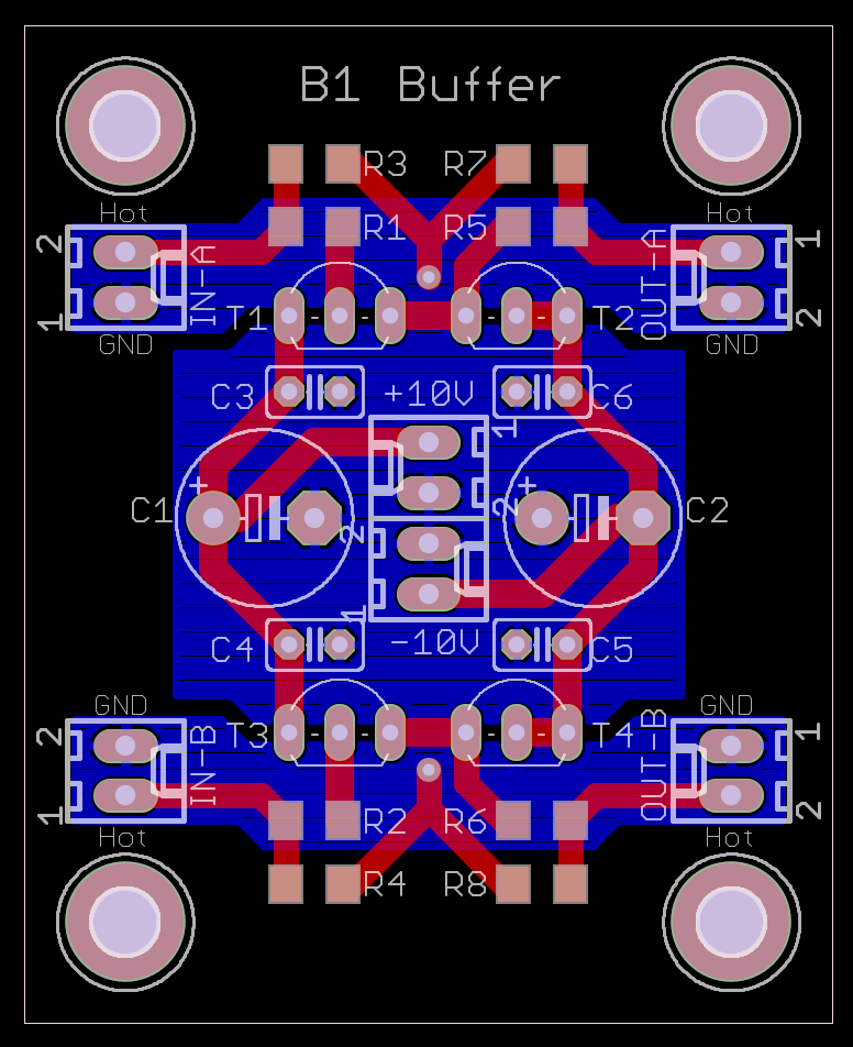

I needed a buffer for my initially passive preamp. For some time I looked at the DCB1 by Salas but could not convince myself to burn so much electricity just for the sake of music... which is why I also never looked at any class A amp:) After a bit of research on the forum I finally decided to build a B1 buffer with dual polarity supply using the super regs from diyAudio store.
Recently I sketched a PCB for the buffer (see attached schematic and PCB) which is greatly inspired by the numerous B1 implementations here on the forum. But now I have a question. Could someone advise if I've done the audio and power grounds right? I used ground plane for power and pours for audio ground which meet just between the transistor pairs for each channel. Also if there are any other obvious mistakes I would appreciate any comments and suggestions.

Thanks a lot Andrew!
I always follow your "twisted pairs" advice:)
As for the PSU wiring I planned to use individual pairs (or quads if I use the sense wires as well) for pos and neg sides all the way from the super regs. Thus the pos and the neg supplies would only meet at the buffer board. Is there a drawback in such an approach?
Oleg
