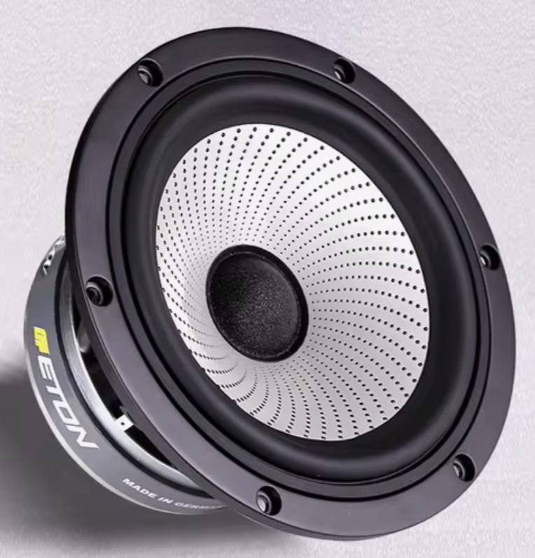

The Eton Arcosia drivers are metal with a geometric pattern of small holes cut out then filled with Olefin (a synthetic polymer). Maybe not exactly what you’re looking for, but certainly in the same spirit. Subjectively I can tell you that these drivers do a great job suppressing any harsh breakup. I’ve looked hard for wideband metal drivers and these are probably my favorite ones.
