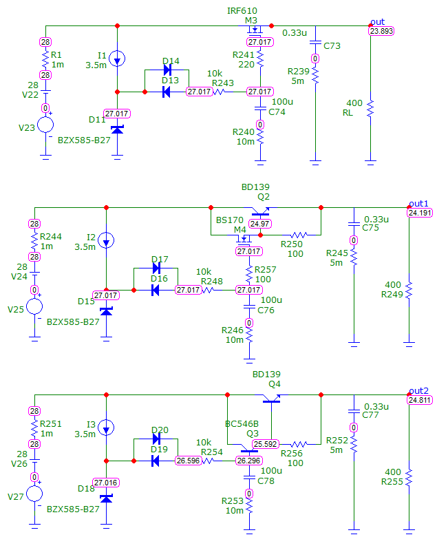

Another amplifying stage, inspired by Blowtorch

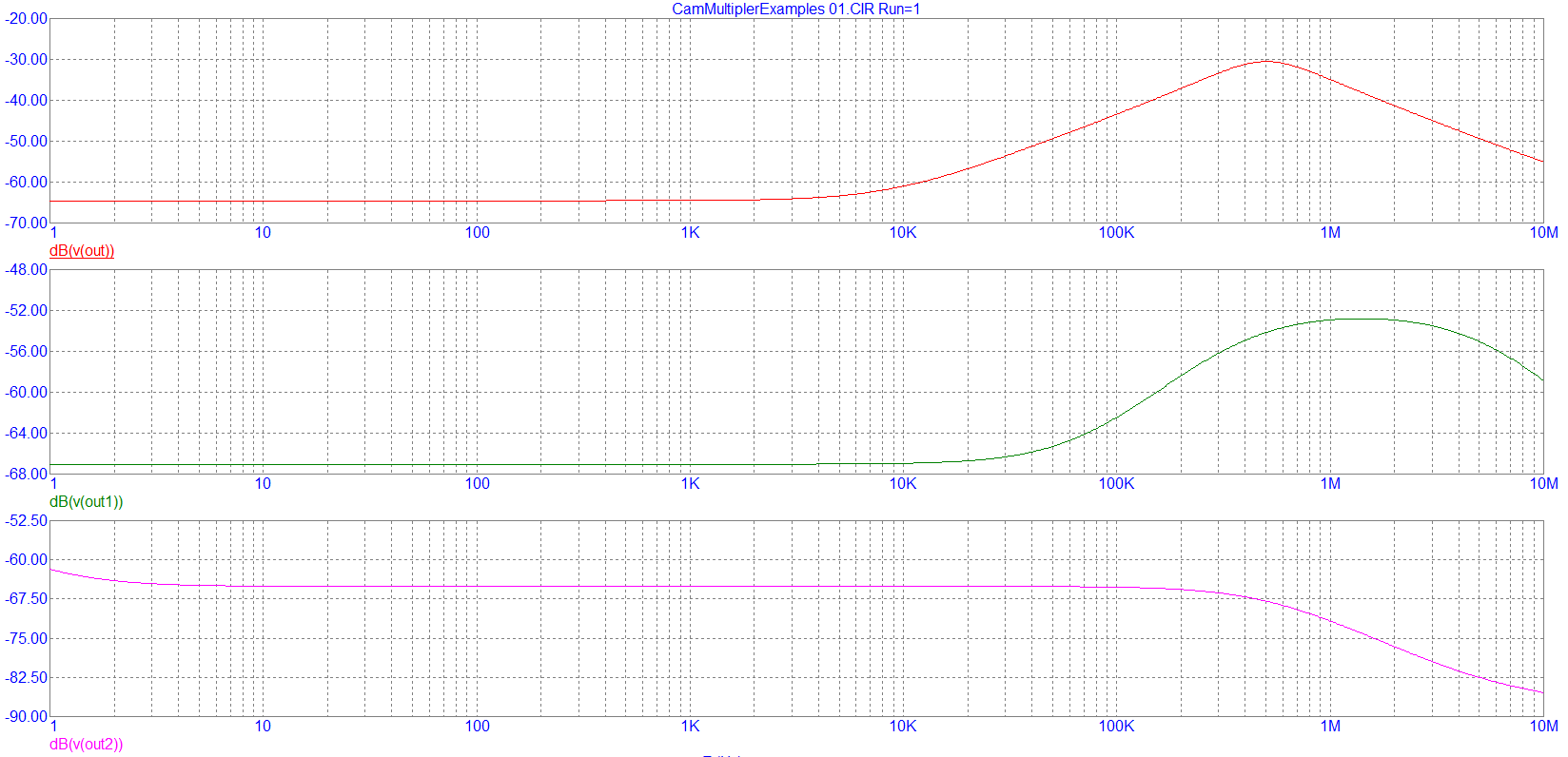

First, schematic with examples and PSRR difference with 400 Ohms load. As I see it`s just a matter of output cap value to flat out at higher frequencies.(never mind it`s not +24V on every example, it`s not important) 3rd example looks best in sim and there`s no base current problem, circuit have high current gain..

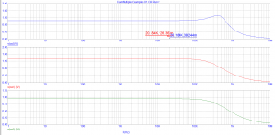

Output impedance and MicroCap12 file, for experimenting on your own if you`re interested. All models from MC library.. (it' 1 ohm btw, kind of high but very linear) That's why I asked is there any difference in sound between different solutions.
Cheers!
