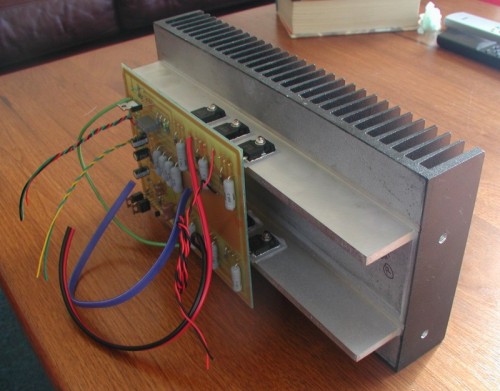

Transformer power requirements vs dissipation vary according to what source you read. Minimum is 2x total dissipation, Nelson states 3x I think from memory.
Therefore, for A5 (300W total), you need at least 600VA in the transformer. This is 650VA, which is a compromise - the 800VA which would have been perfect just didn't sit in the case as neatly, so I opted for the 650VA (given I knew the toroid manufacturer was always conservative anyhow!)
Bass problem ?..... I haven't noticed one with either the A4 or A5.
Agree, don't put transformers in parallel. 125VA / 35V isn't useful for an Aleph.
Bias is standard from the original curcuit, I didn't modify it in any way. haven't measured it per se at this stage. (bloody work!)

Mefinnis- this is certainly not just another Aleph 5. It's gorgeous. Would you mind sending your pics to webmaster@passdiy.com? This amp would look great in the gallery. Thanks

I have very unhelthy thoughs about building this beauty, but I have a problem: I can't find the irf244 in my country. I'm asking: is there a problem if I use irfp240?(20A, 200V)

WRT the IRFP240 .... this will work just fine 😀

Use the FETs, they will be fine
